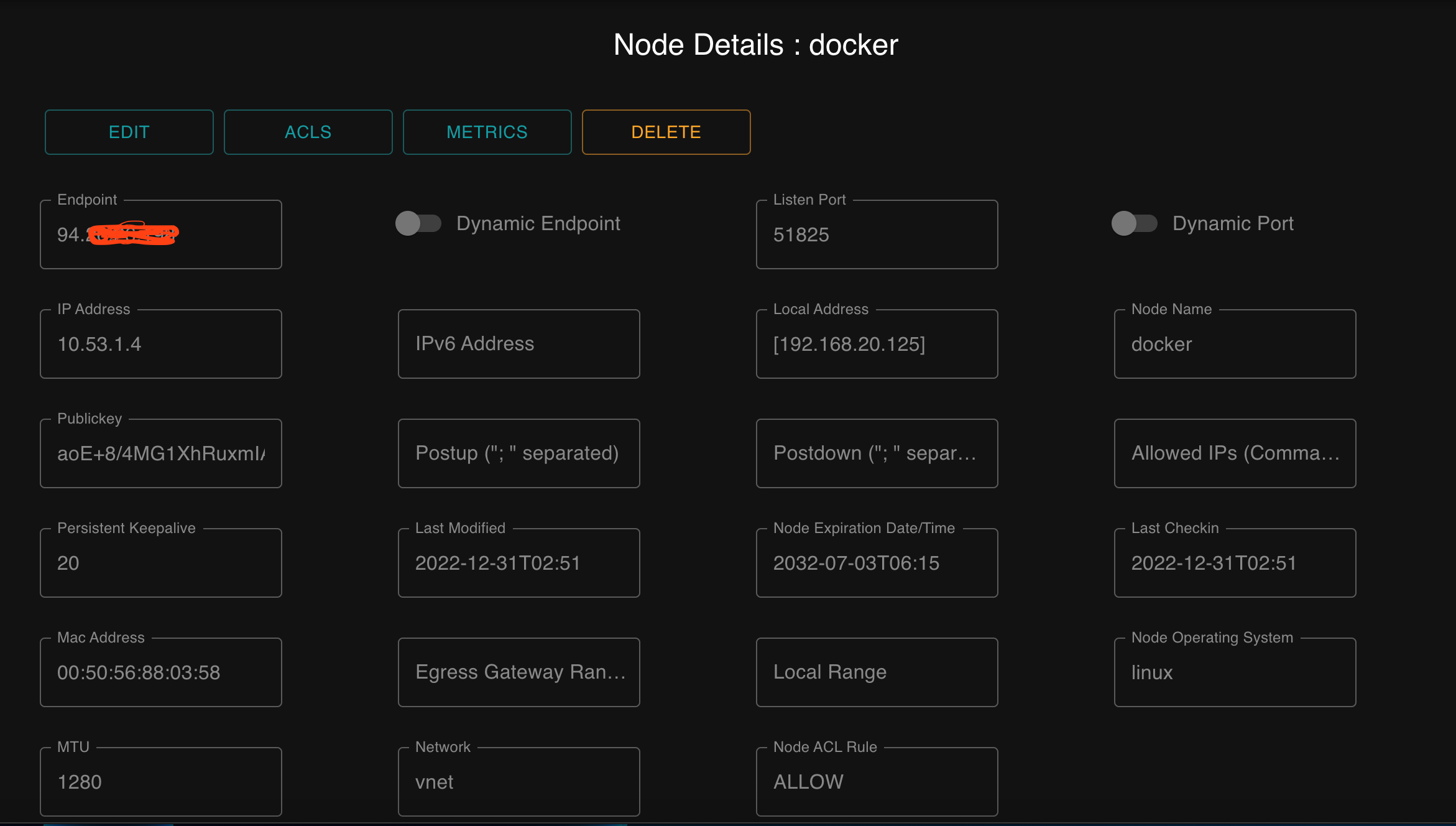

                                        @johnpoz I am sorry for reviving the old topic but I am facing the same issue behind pfsense.
                                        I`ll try to explain in a bit more details:
                                        1. Site A: A typical scenario where we have pfsense as router/firewall with Public IP managing a single LAN network 192.168.x.0/x
                                        2. Site B: Cloud (let`s say AWS) has a VPS with Netmaker Server installed and accessible, ready to serve any authorized connection over his Public IP.
                                        3. Site A - Client 1/Node 1 (192.168.1.100): A simple Laptop (Win, Linux. Mac - it doesn't really matter) is initiating Wireguard/Netmaker VPN connection to Site B Public IP (Netmaker Server), and... connection is established. The client gets internal IP from the Netmaker VPN let`s say 10.53.1.10. The Netmaker GW is 10.53.1.254. There is a Ping between the client 10.53.1.10 and the GW 10.53.1.254.
                                        4. Site C - Client 2/Node 2: a different client in a different network behind some firewall, not pfSense with local IP 172.16.0.24 is initiating netmaker VPN connection to the public IP of Site B. connection is established and the IP assigned to the client C in the Netmaker network is 10.53.1.20. There is a ping between Site C 10.53.1.20 and Site A 10.53.1.254 no worries.
                                        5. Site D - Client 3/Node 3: 3rd client in a row again in a totally different network behind some firewall, not pfsense with local IP 10.10.100.17 is initiating netmaker VPN connection to the public IP of Site B, the connection is established and the IP assigned to the client D in the Netmaker network is 10.53.1.30. There is a ping between Site D 10.53.1.30 and Site A 10.53.1.254 no worries.
                                        Now comes the fun part:
                                        Site A can ping Site B (the server/GW) no problem
                                        Site A cannot ping any other Clients/Nodes (Site C and Site D)
                                        Site C and Site D can ping each other and can ping the GW/The Netmaker Server but they cannot ping the Site A which is behind pfSense.
                                        Some references: Netmaker uses a UDP Hole Punching so he can be able to create p2p connection between each one of the clients/nodes which gives the ability to have a direct connection between different nodes/clients without having the route the traffic through the GW/Netmaker Server.
                                        As far as I am aware the same issue is facing the ZeroTier which uses UDP Hole Punching as well.
                                        I hope this explanation the give some light and understanding what the real issue is.
                                        Still looking for a solution....
                                        johnpozJ M 2 Replies Last reply Reply Quote 0

                                            Josifbg 0 @johnpoz
                                            @johnpoz Thanks for your response.
                                            So how would you explain that behind pfsense the client is not able to ping other nodes and to be pinged by any other nodes, but without pfsense there is no such issue at all?
