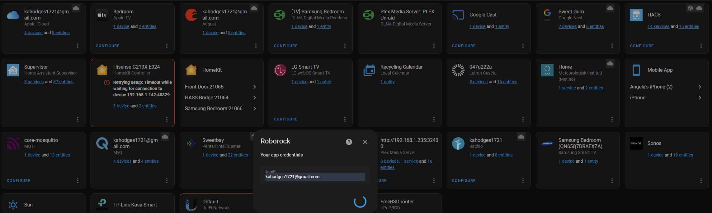

                              @bmeeks ok so I came home today to begin testing of the changing of the NIC port. Lo and behold it just started working. So I think that solves it. Something on the integration was causing a flood of traffic and ended up getting something banned. The good news is it seems it was temporary. I feel like an idiot spending so much time and effort trying to solve it but in the end I got to really deep dive into various settings. I Learned a lot more about DNS and how it should be set up properly and other various items that I can’t say I knew anything about before so it isn’t all bad! I want to thank you specifically for sure and everyone else that helped support this! We might not of figured out the root cause but man you all helped me learn a lot!
