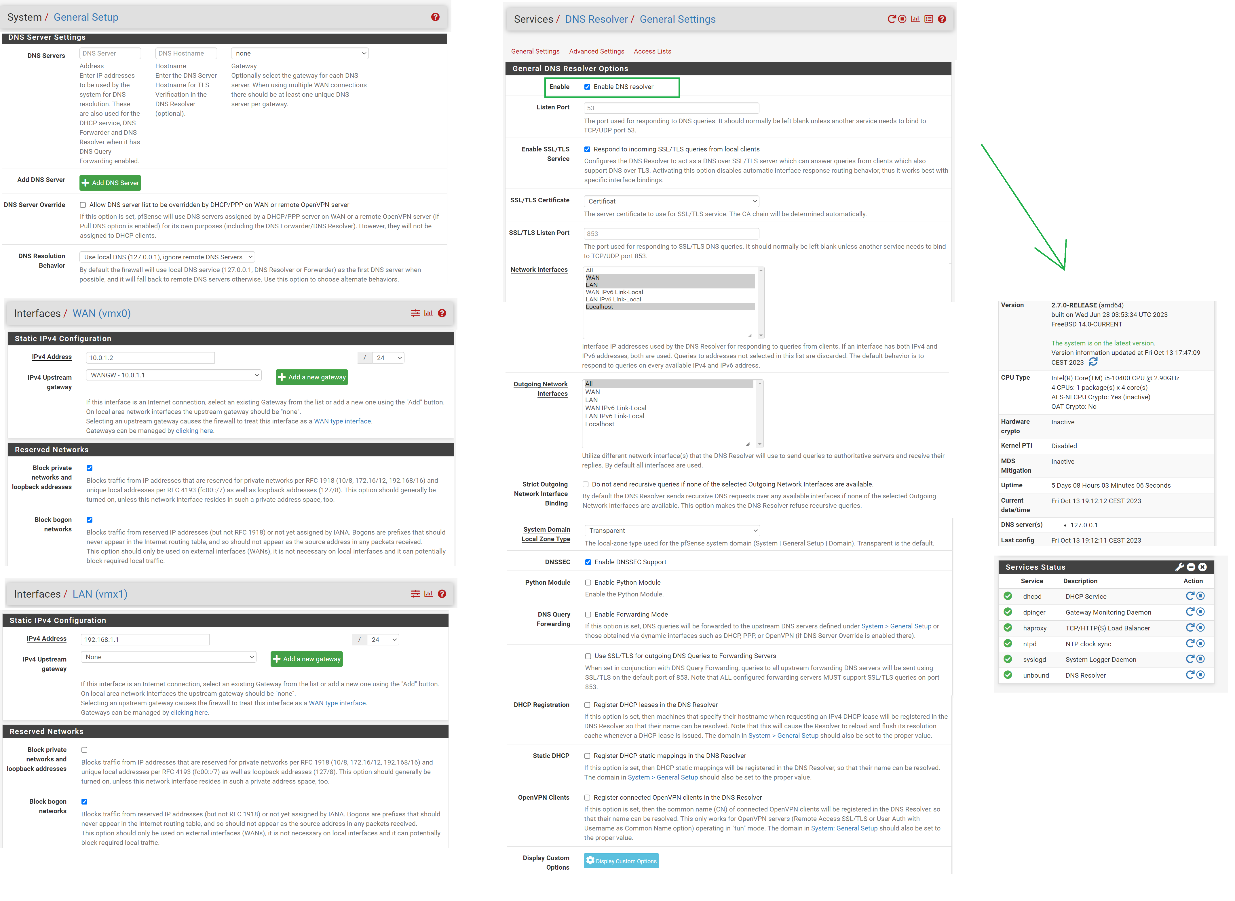

      Problem 1: Access to my local infrastructure, when I am connected to my LAN network via wifi or rj45 I cannot reach the machines via the external url https://____.domainname. ovh
      However in 4G therefore in WAN no problem....
      After several tests, I noticed that if I temporarily deactivate the option: Block private networks and loopback addresses present in the WAN interface it works!
      This will allow traffic from IP addresses reserved for private networks per RFC 1918 (10/8, 172.16/12, 192.168/16). This option should generally be enabled unless this network interface resides in a private address space. (WAN interface behind a Router / Box)

                          Here are the basic DNS on Pfsense.
                          I will make the modifications as you detailed previously and post a screenshot.
                          johnpozJ 2 Replies Last reply Reply Quote 0

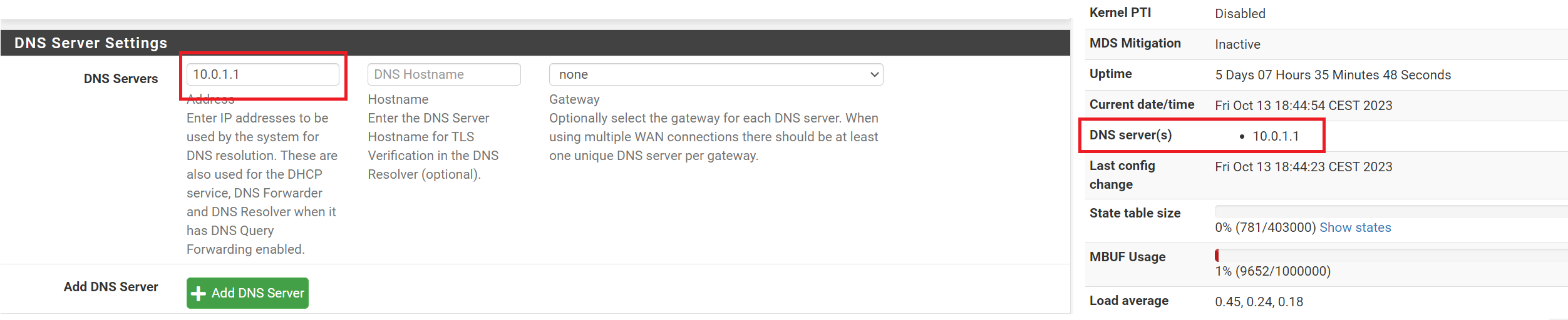

                                  ducati57 @johnpoz
                                  @johnpoz Ok, thanks for your patience :)
                                  I just modified it as indicated in your comment.=>

                                      ducati57 @johnpoz
                                      @johnpoz
                                      If I do not indicate anything, and I configure Pfsense identical to your screenshot, here is the result
                                      (KO update status because no external access because no DNS?)

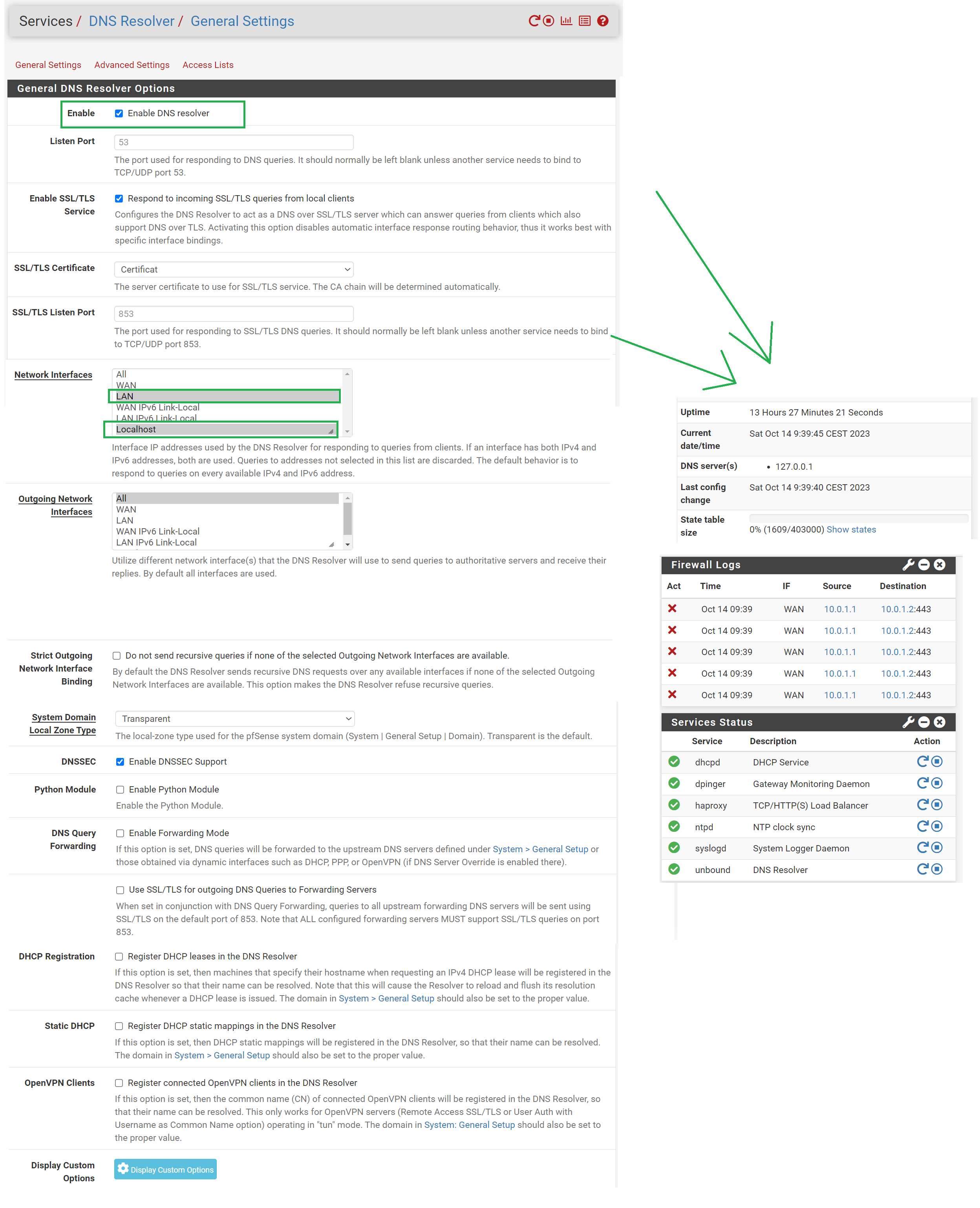

                                          ducati57 @johnpoz
                                          @johnpoz
                                          Here is the configuration of the different elements / services do you see an error? (security problem, loop, bug, useless,etc..)
                                            johnpoz LAYER 8 Global Moderator @ducati57
                                            @ducati57 well I see one thing that I personally would not do.. If your going to set the specific interfaces that unbound listens on, why would you click on wan.. Do you have devices that would be using the dns via its wan IP?
                                            Your saying with those settings it does not populate 127.0.0.1 in the system tab for dns? If you do not put anything in the dns tab?
                                            Here I just fired up my 2.7 box.. Its pretty much default out of the box.. Other than changing its lan to other than the default 192.168.1.1
                                            I then changed from all, to just lan and got this error
                                            So I selected localhost along with just lan and it worked and system still shows dns as loopback 127.0.0.1
