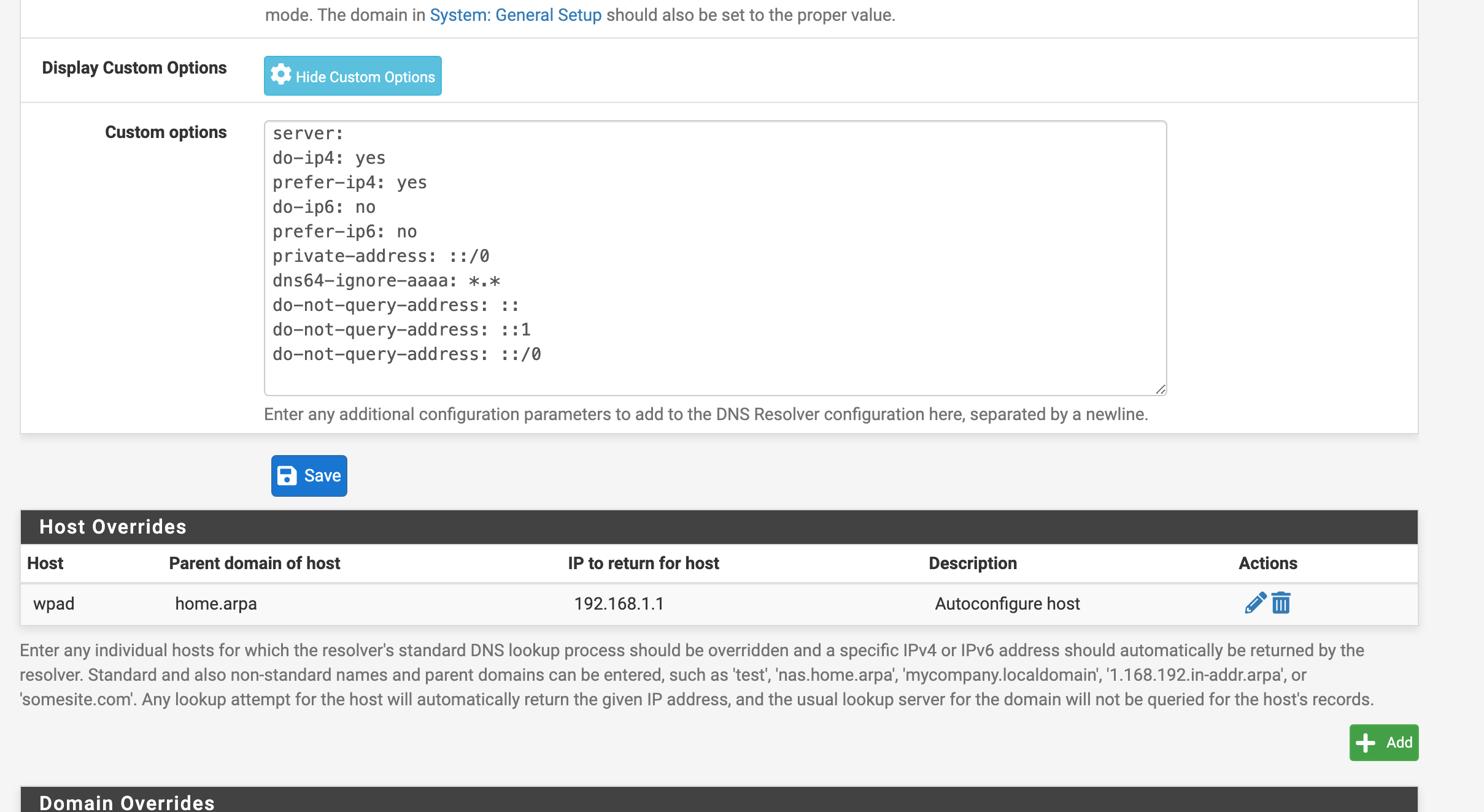

      Again as suggested in the guide, I added a Host Override in DNS Resolver (I didn't use DNS Forwarder because I use the Resolver).

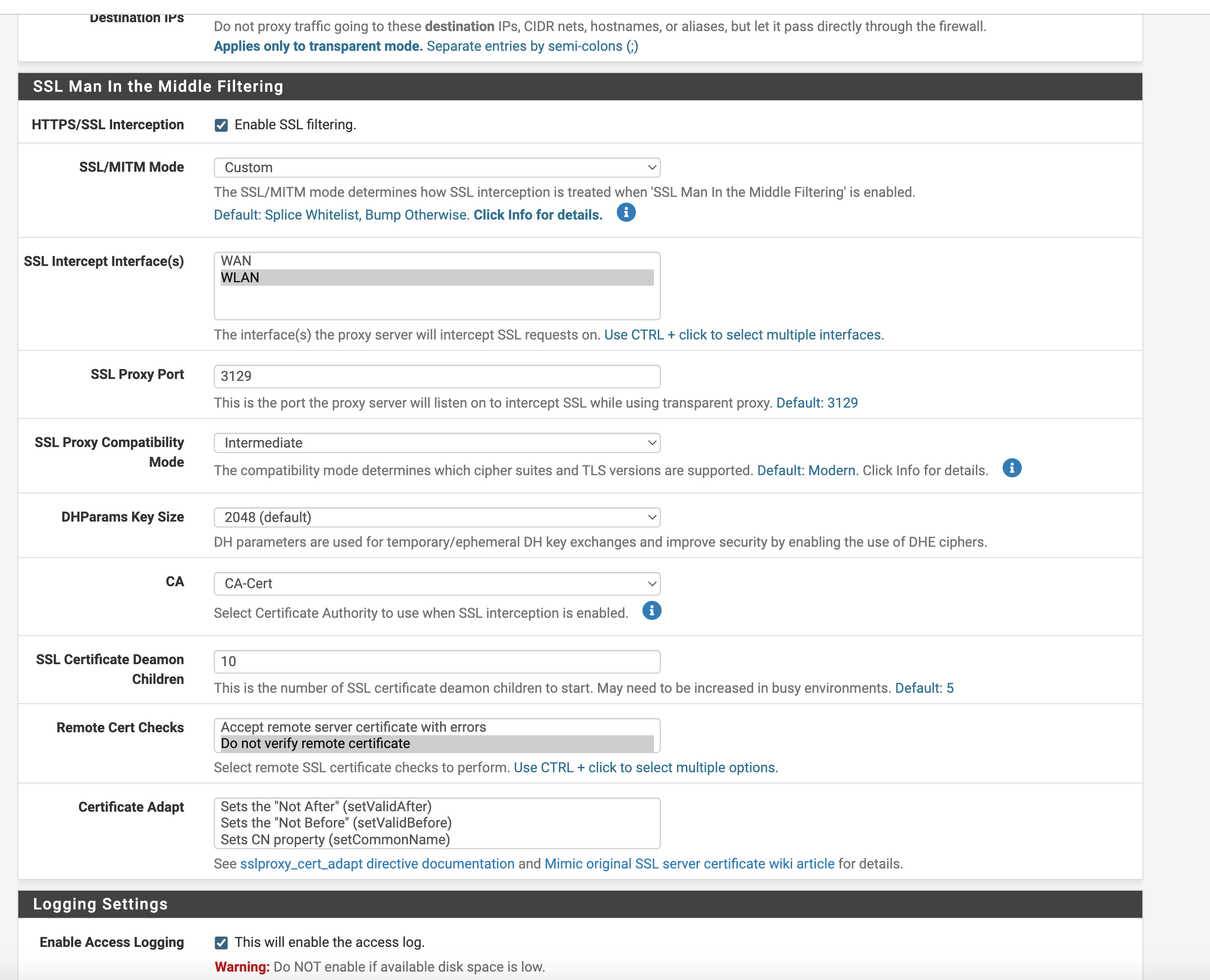

      I configured Squid by enabling Transparent HTTP Proxy and HTTPS/SSL Interception.
      I created a new CA which I then pointed to SSL Man In the Middle Filtering / CA.

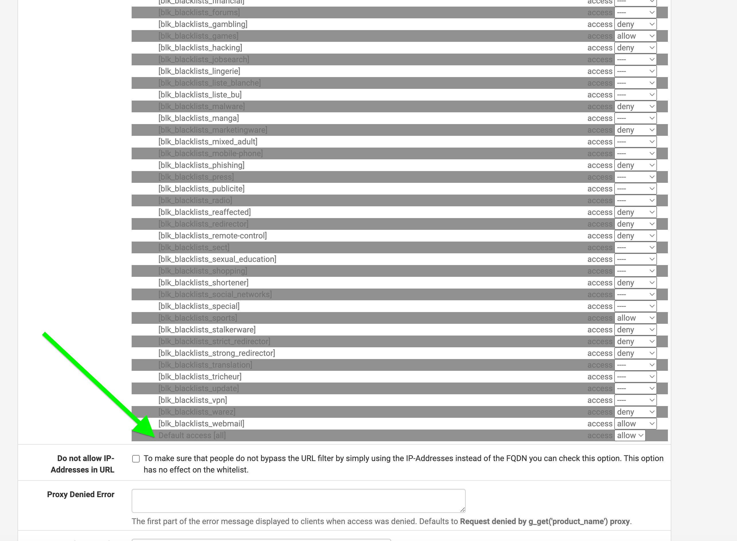

      For the test in Squidguard I activated the block of Adult, Dating and Social Networks.
      I would like to activate "Log Pages Denied by SquidGuard", but it is suggested to insert a code without giving any indication of where to insert this code in sgerror.php. So, I didn't enable this option.

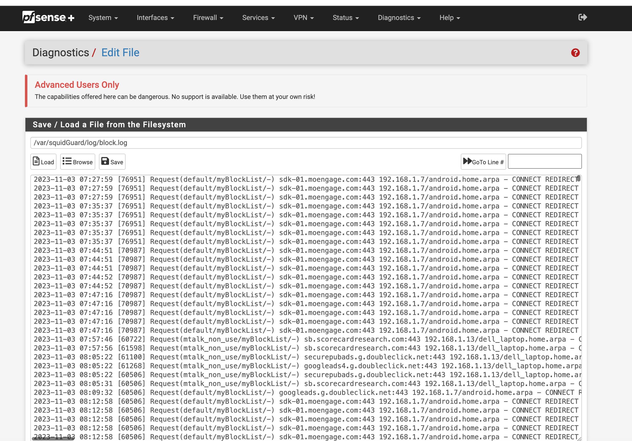

      In the Squidguard logs there is "Request(default/blk_blacklists_social_networks/-) - CONNECT REDIRECT", but in Squidguard I configured Redirect mode = "int error page (enter error message)" with in Redirect info the message "Site blocked. Ask the administrator what you need to do."

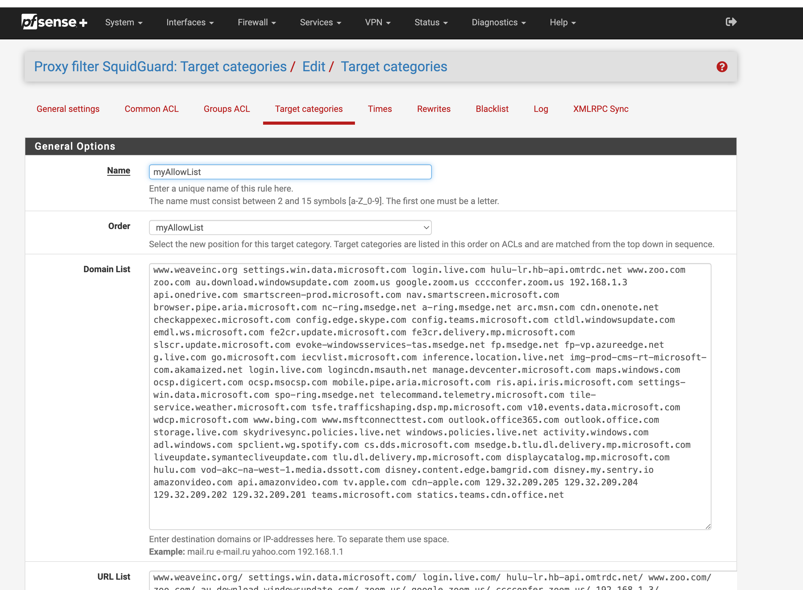

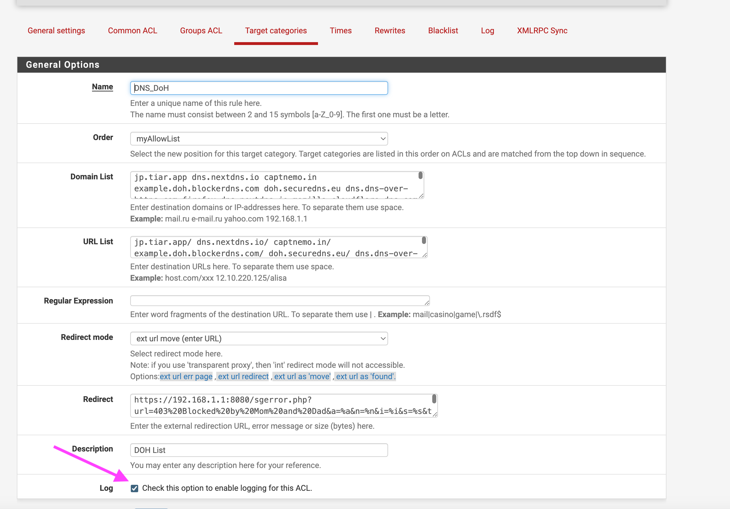

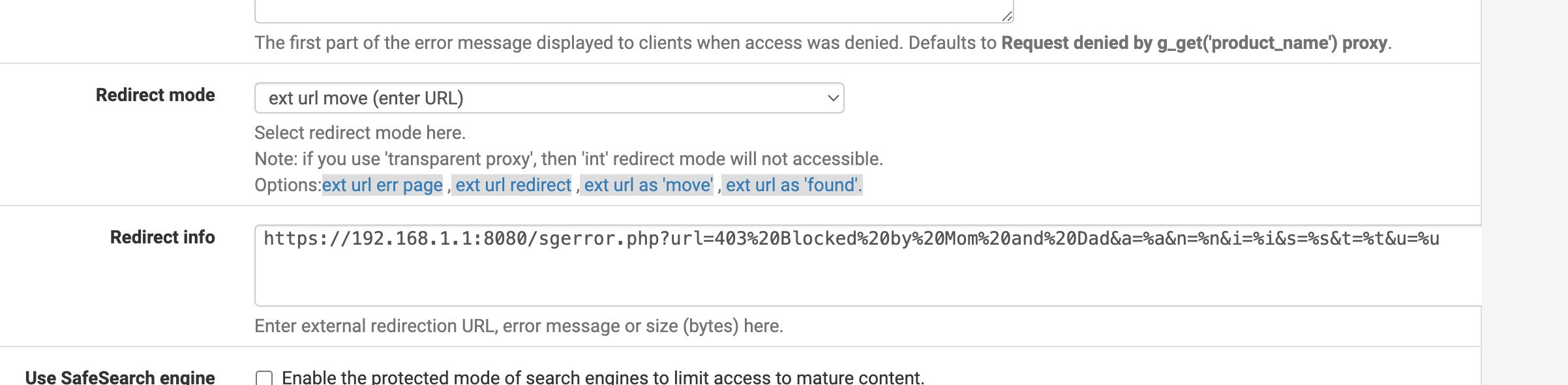

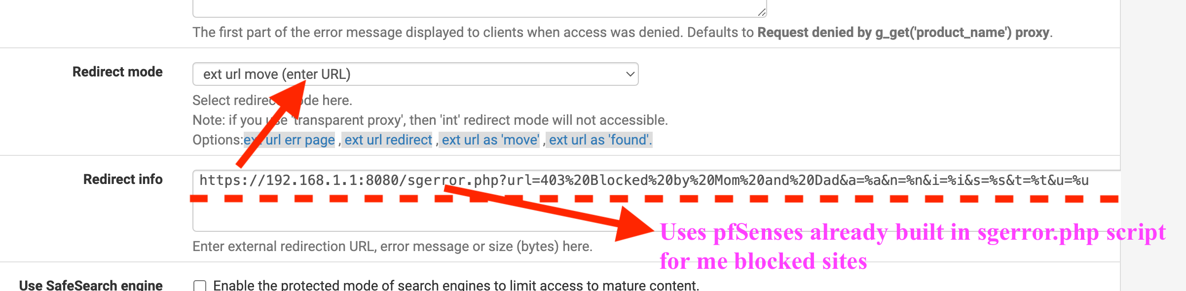

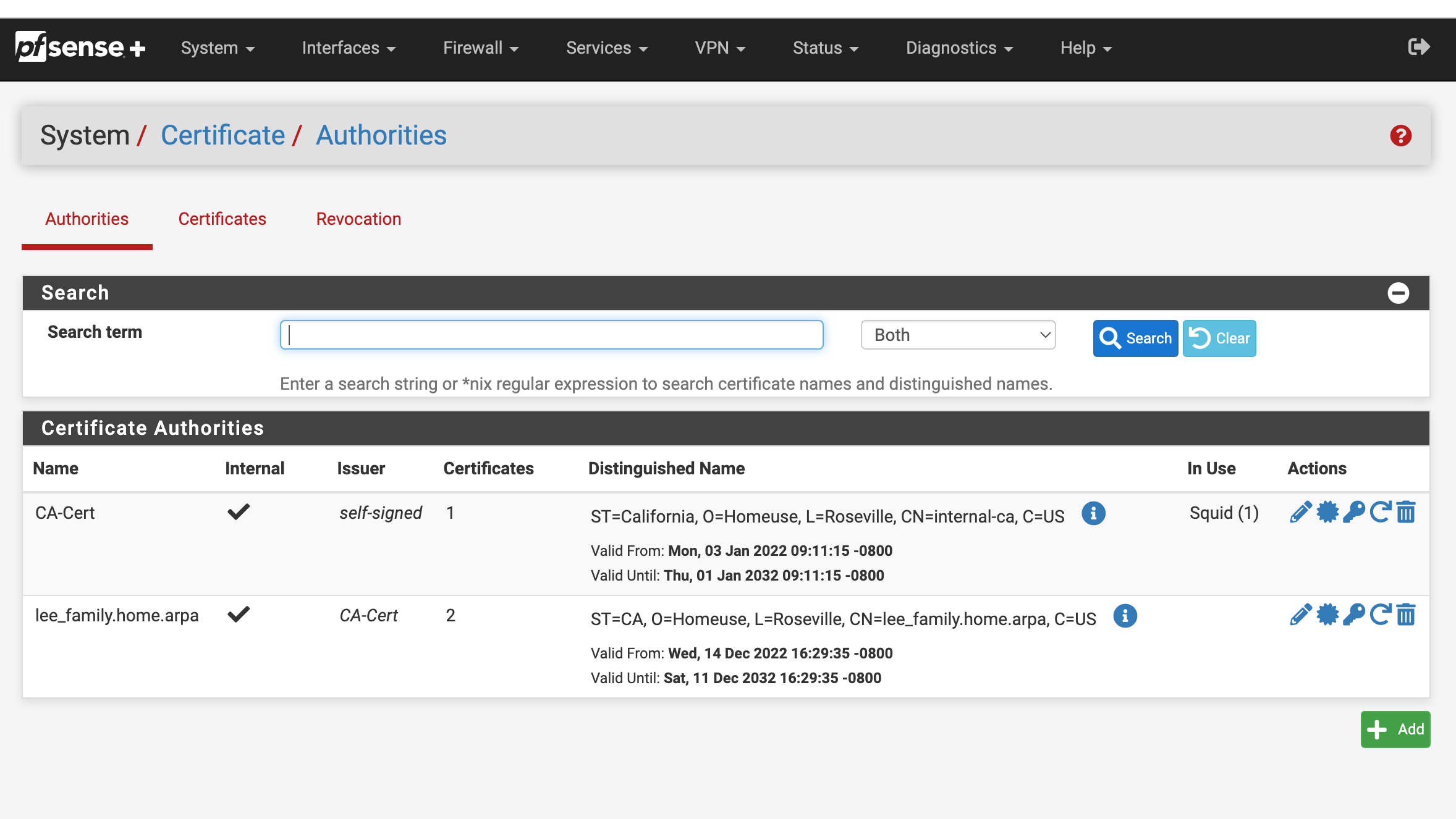

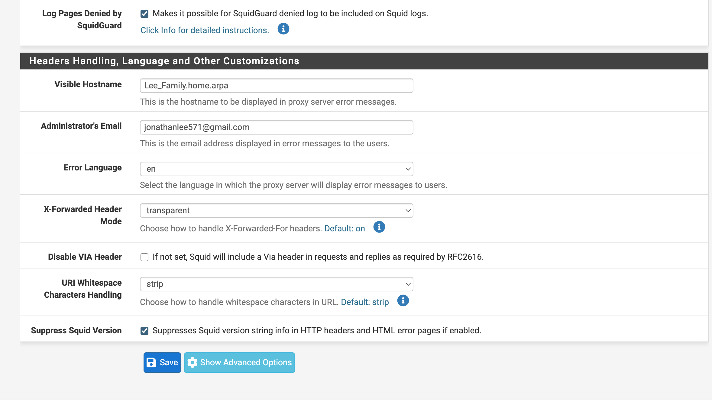

        Just to confirm you would like this to occur for blocks?
        If so you can create a custom redirect entry as you likely using pfsense to serve WPAD, this can cause complication where the built in redirect is not fully functional.
        In place used a customized external move
        Make sure to upvote

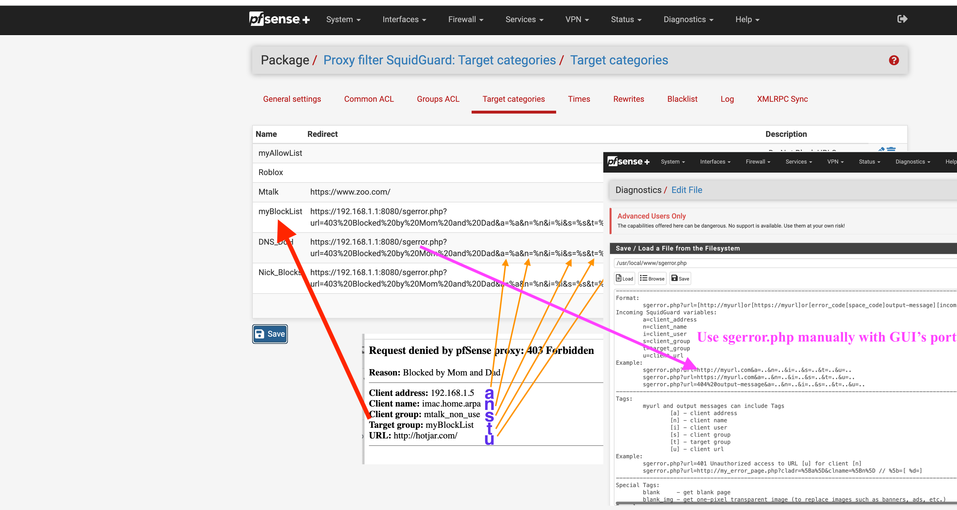

        • JonathanLeeJ Offline
          JonathanLee
          use this file as a guide
          Path is
          /usr/local/www/sgerror.php.orig

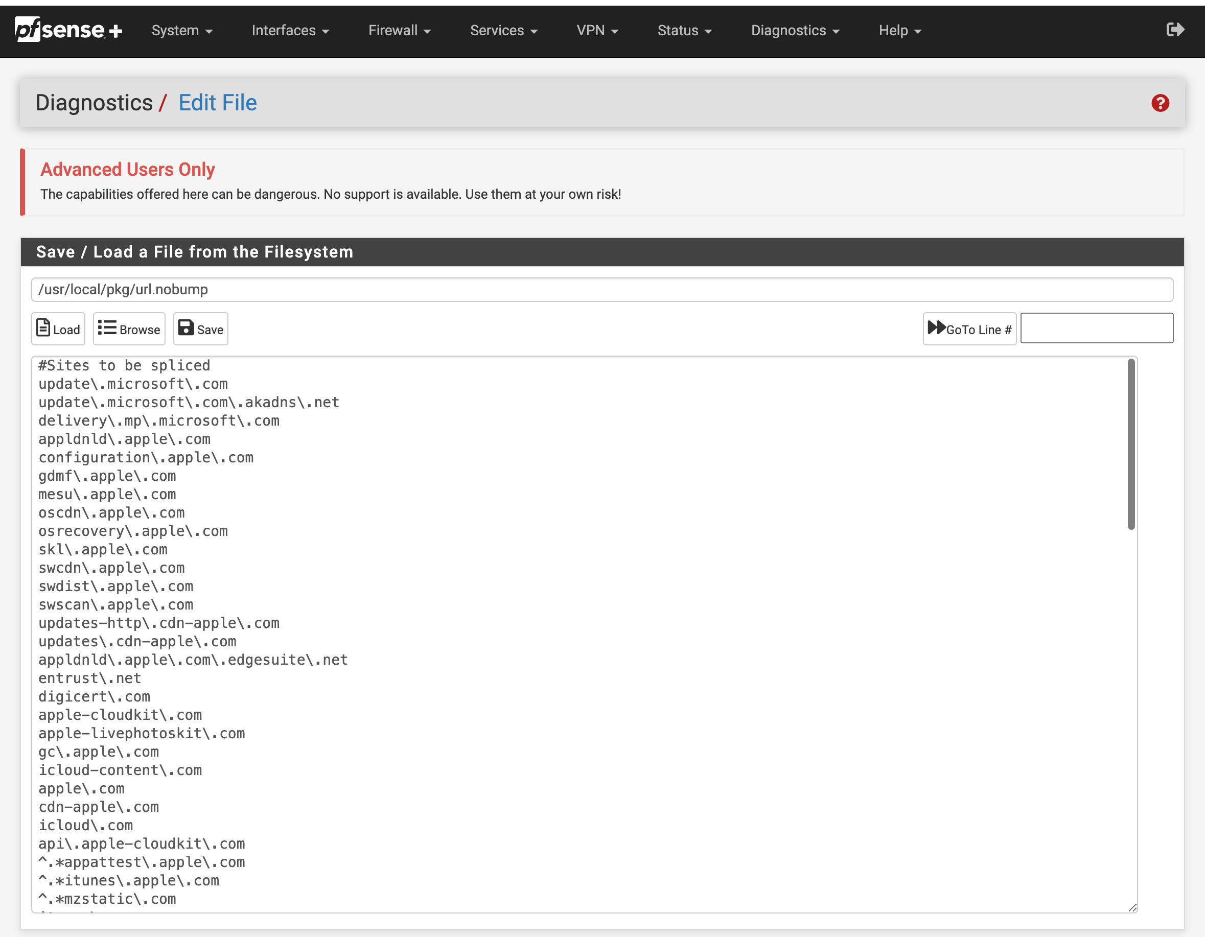

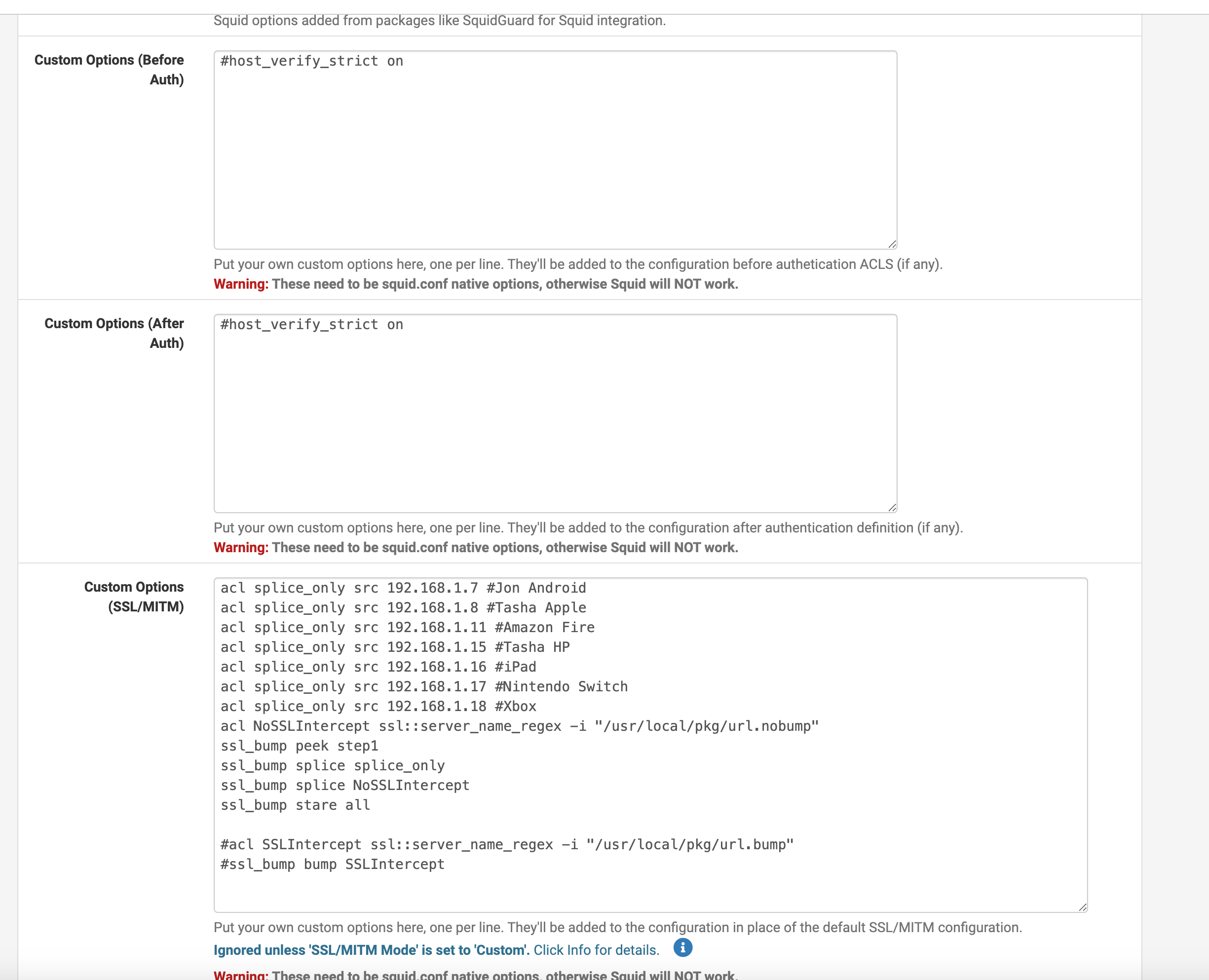

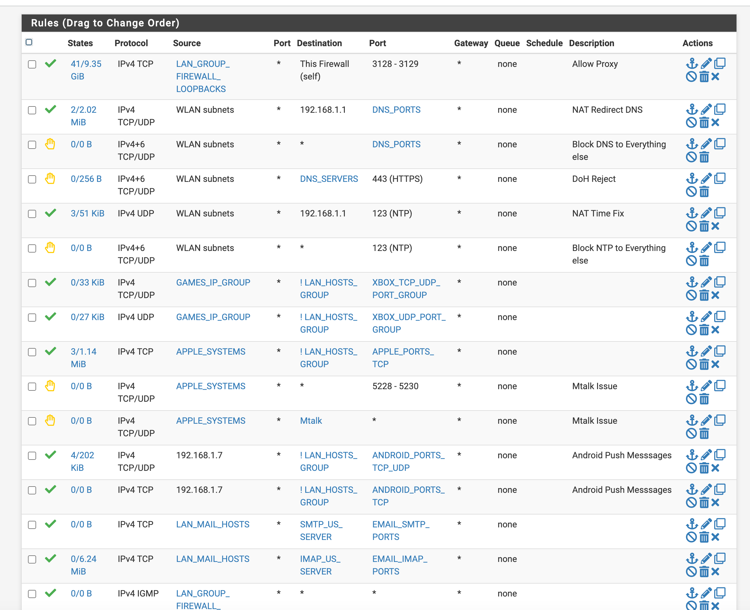

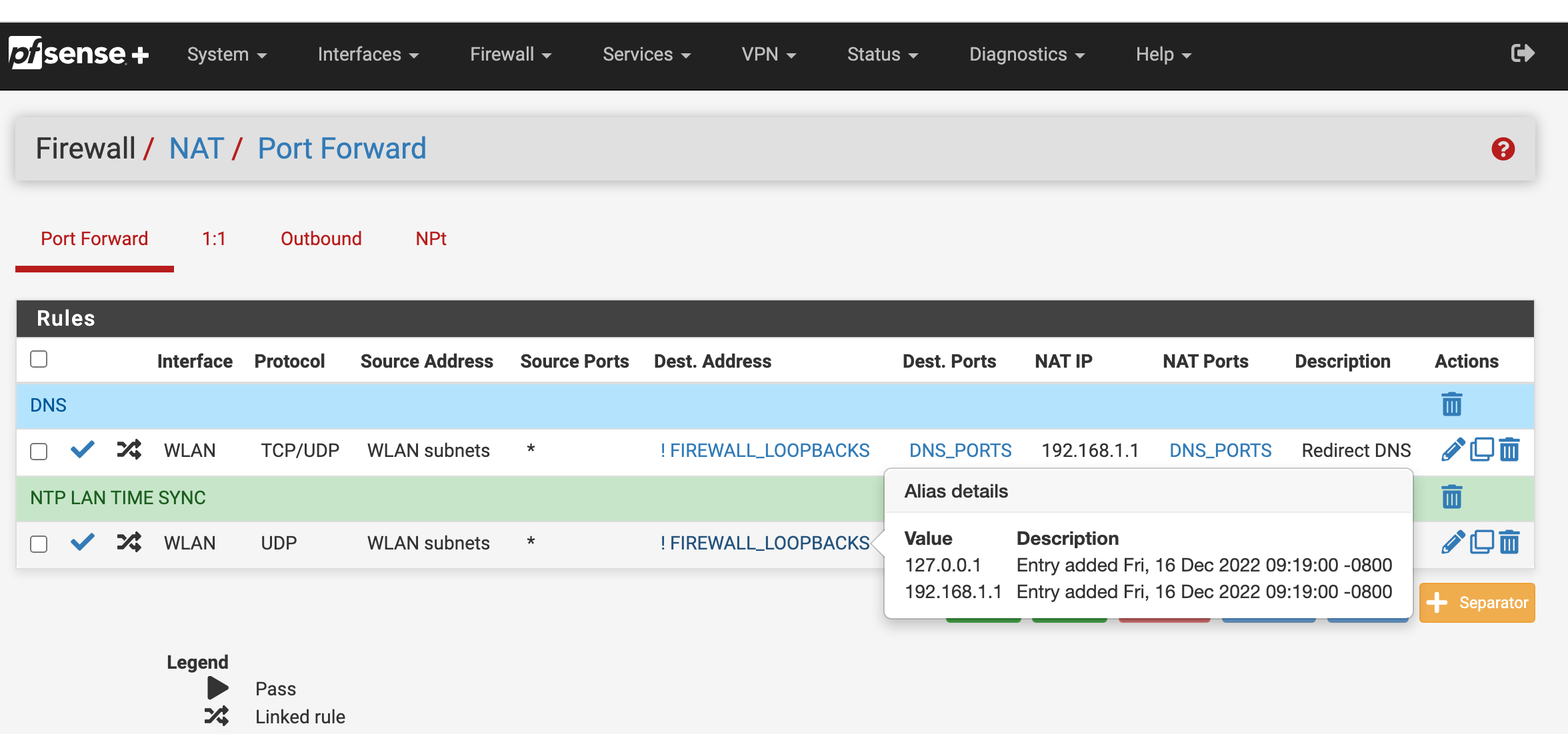

                @KOM It is for use with both Transparent mode and SSL mode for devices like XBOX and Nintendo Switch Iphones etc. You must have them for Transparent on the Applications, plus you can have the certificates for the web browser. That way it works both ways. Spice and non-splice.
                Xbox will not work unless transparent mode is enabled as an example plus you need WPAD and DHCP option 252 to be enabled for it to function correctly with the firewall. However, my other devices on the LAN use the SSL intercept. With or without the proxy used it functions this way. Some with SSL intercept get better cache rates and HTTPS Clam AV use.
                You can get both working plus the Clam AV HTTPS use for your desktops that can have certificates installed
                Best of both worlds, transparent use for URL blockers on the XBOX/Nintendo web browsers + the high security and caching for other devices that do not require transparent mode.
                Make sure to upvote
                      JonathanLee @WhiteTiger-IT
                      @WhiteTiger-IT
                      I used that file to generate a custom useable redirect.
                      my example shows a line that says redirect info . . .
                      This line is where I have it set as the ext URL move (enter URL)
                      It is the same thing it is on PfSense however I made the custom file.
                      My URL for example is
                      https://192.168.1.1:8080/sgerror.php?url=403%20Blocked%20by%20Mom%20and%20Dad&a=%a&n=%n&i=%i&s=%s&t=%t&u=%u
                      Reading that file this is basically access the sgerror.php script and use url=403 : forbidden
                      My message Blocked by Mom and Dad
                      a=client address
                      n=client name
                      i=client user
                      s=client group
                      It is just using that php file with the firewall port I have set. Mine is 8080

                              However what is the port number your GUI uses?
                              https://192.168.1.1:port number here/sgerror.php?url=403%20My%20Message&a=192.168.1.100&n=touch-pc.DOMAIN.TLD&i=&s=default&t=blk_blacklist_adult&u=http://PORNSITE.TLD
                              Did you use redirect replace URL under every category in Squidguard? It has to be under default and all Squidguard groups. It looks like a double redirect. Have you set the proxy to bypass Squidguard redirect also?
                              With transparent you don't need to worry about proxy auto detect.
                              I suspect you have no certificates installed on devices correct?
                              Test that link by itself past it in a browser window.
                              What port do you use when you log in to PfSense?? That port is also needed to access the WWW folder and that's what contains the sgerror file.
                              Example 192.168.1.1:8080 is what I have configured as a custom port.

                                Now the error message appears and I thank you for this.

                                      Squidguard does have the ability to log blocks in the rules area click the log radio button. This will log the blocks you have created to Squid Proxy.
                                      /var/squidGuard/log/squidGuard.log

                                          You will never get SSL intercept to fully work as some applications require different things. If you are not using IPv6 have you disabled it inside the DNS forwarder? You have WPAD set up in your DNS?
                                          Here is copy my my custom IPv6 disable, my ISP does not allow IPv6, and my WPAD set up in DNS as a host override
                                          Here is a copy of my ACLs if you want to check it out
                                          NAT RULES for DNS and NTP

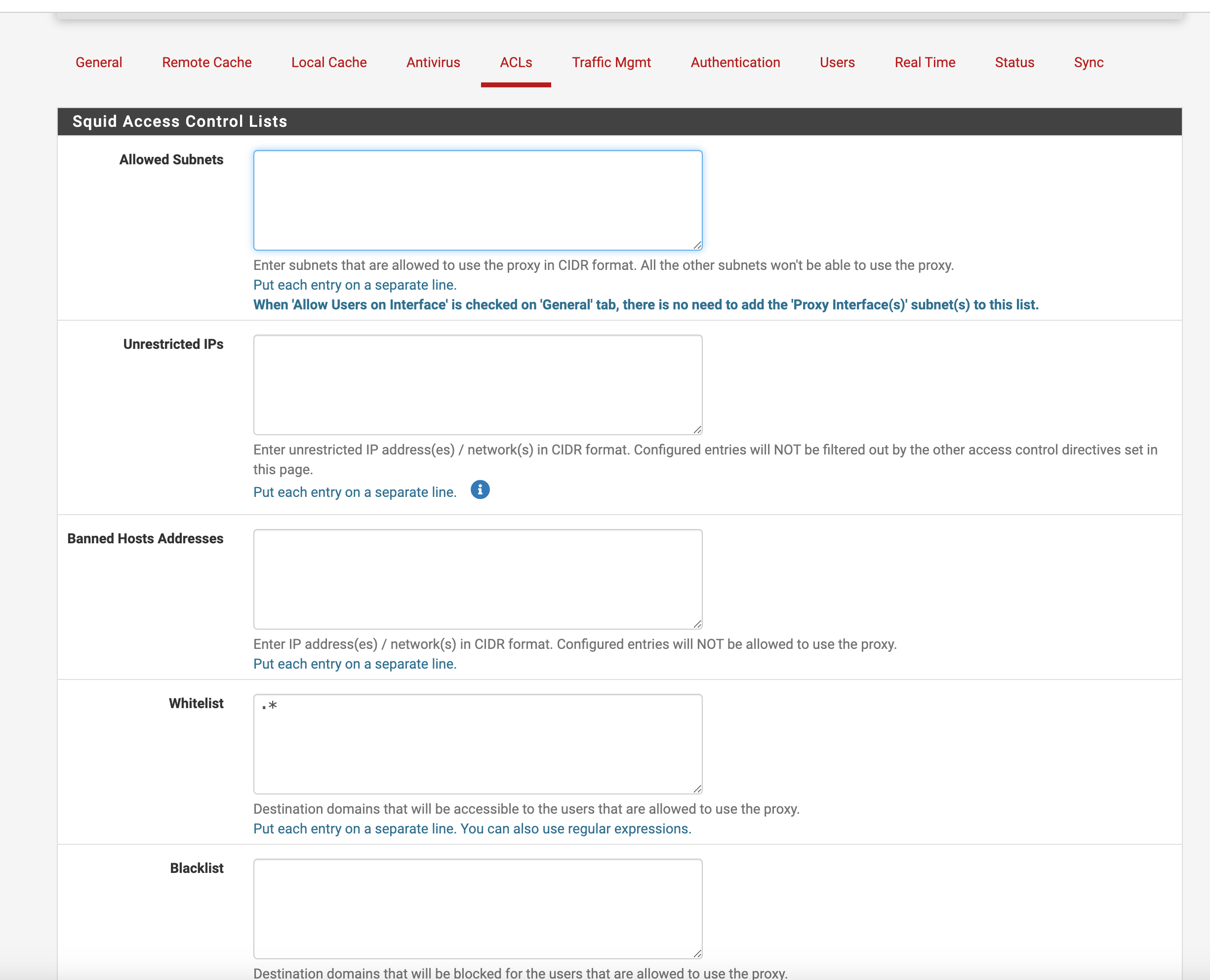

                                          Squid ACL
                                          .* for my allow all domians I let Squidguard do my blocks
                                          Squid Proxy Custom options.
                                          Some clients I splice everything for so they are transparent anyway.
                                          Take note of the Regular Expression file it is pointing to. . .
                                          This is my always splice file no matter what like banks phone messages etc, that way they are never intercepted ever.
                                          I do not use certificate checks inside the proxy
                                          Squid's CERT is also a root authority see CA-Cert
                                          Same here
                                          Xforwarder mode is set to transparent for mine as I am not using anything else just the firewall and the Dmark

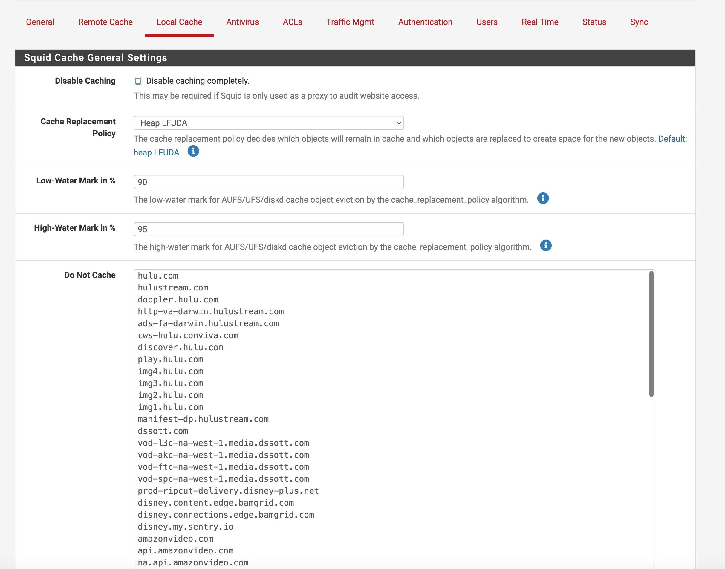

                                          I have a large do not cache list
                                          I also have a Squidguard always allow list
                                          If you use a Blacklist proxy you also have to set it to allow as a default outside of the blocks so it does not block everything.
                                          You also have to point clients to it that are not set as transparent
                                          I just noticed your Rule 2 you have a any any rule this will bypass everything as clients do not need to use the proxy at all with that rule.
