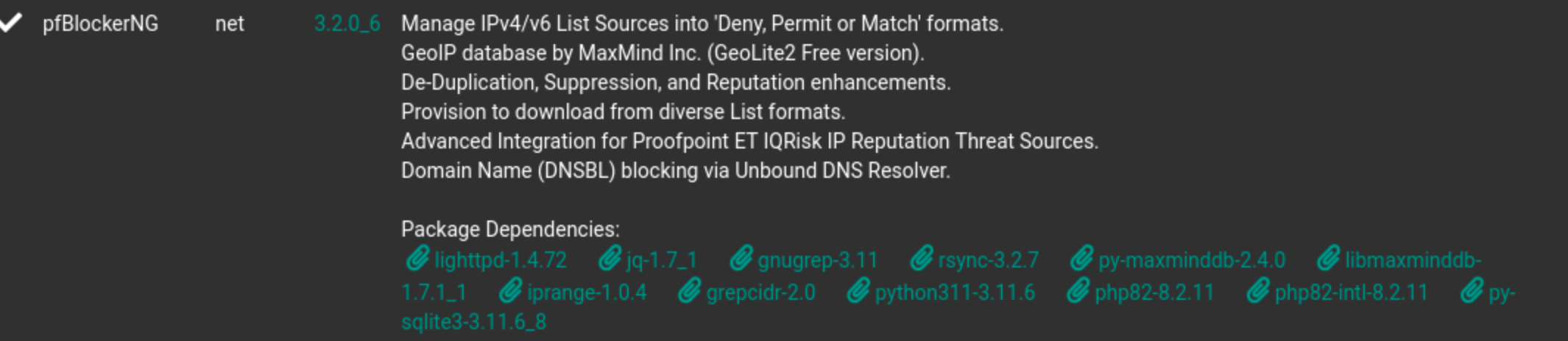

                          @bobslee said in pfb_dnsnl (pfBlockerNG DNSBL) service won't start:
                          ./pfb_dnsbl.sh restart
                          umm, according to the dependencies, pfBlocker should be using
                          lighttpd 1.4.72
                          and your error message for the restart says in part.
                          www/lighttpd/work/lighttpd-1.4.71
                          first check the version running - command prompt
                          lighttpd -v
                          should resspond
                          lighttpd/1.4.72 (ssl) - a light and fast webserver
                          if 1.4.72 (like above ^^)
                          stop
                          else
                          wouldn't hurt to grab a config backup, then
                          uninstall pfblocker (remove the package) (keep settings)
                          reboot pfsense
                          both pfblocker packages should be in the available package
                          install the non devel version (you're not missing anything)
                            jrey @jrey
                            @jrey said in pfb_dnsnl (pfBlockerNG DNSBL) service won't start:
                            lighttpd 1.4.72
                            My bad, I was looking on a different version of pfsense
                            under 23.09 the dependency is 1.4.71 so likely not changed from 23.05.1 (but I don't recall)
                            however under 2.7.1-RC (my sandbox) it is 1.4.72 for the same pfBlocker Version
                            there are minor differences in some of the other dependencies as well.
                            Under 23.09
                            under 2.7.1-RC
                            service is running on both here
                            but this:
                            2023-11-12 20:54:04: (/wrkdirs/usr/ports/www/lighttpd/work/lighttpd-1.4.71/src/plugin.c.209) dlopen() failed for: /usr/local/lib/lighttpd/mod_openssl.so Shared object "libssl.so.30" not found, required by "mod_openssl.so"
                            2023-11-12 20:54:04: (/wrkdirs/usr/ports/www/lighttpd/work/lighttpd-1.4.71/src/server.c.1631) loading plugins finally failed
                            is likely the root cause why the service isn't starting, it is not seeing what it wants for a successful start.
                            Both of my instances only report a non-fatal cipher error when running pfb_dnsbl.sh restart but the non-fatal allows it to run, and service to start.
                            might need to trouble-shoot specifically the error you are getting,
                            "lighttpd not starting properly with llibssi.so not found error"
