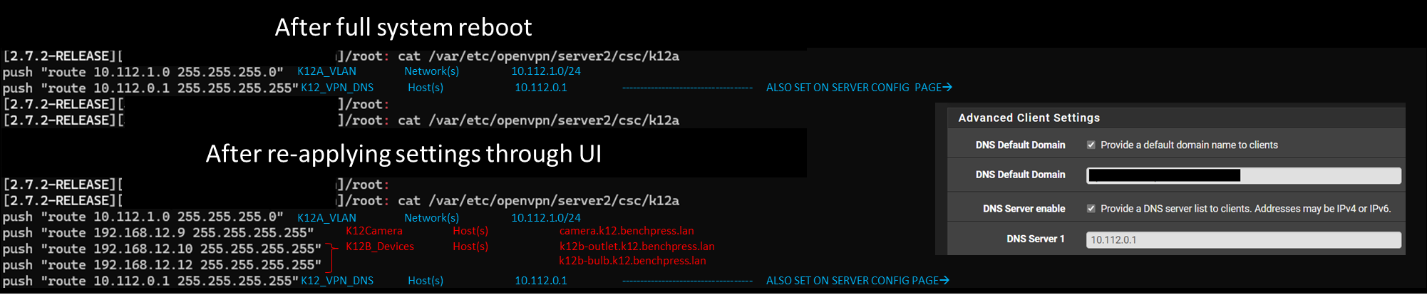

          azeliff3
          I just checked -- aliases are properly stored as their expanded strings (CIDR notation, IPs etc.) in the config and the appropriate CSC configs before reboot.
          After reboot, the entries that should be there from aliases are NOT present. The below are CSC configs. I checked the same behavior is present in the main server config for aliases as well.
          Before reboot (after hitting save on configs)
          After reboot:

                          Your screenshot above shows it still has routes for those 10.x.x.x subnets which I assume are the network alias?

                            The configurations shown and in question are the server configurations.
                            I apologize for obscuring the private subnets. I've dealt with people panicking when they see any IP publicly posted in other venues, so I default to obscuring.
                            Here's a more detailed breakout of after reboot vs re-applying the settings:
                            It appears to match with what @Gertjan implied regarding resolution of host names, where they may not be resolved before the openVPN server starts on a fresh boot. Unfortunately, restarting the OpenVPN service (even after 5-6 minutes uptime) does not appear to get those resolved hostname aliases to show in the configuration. They only seem to show up when I re-apply the settings.
