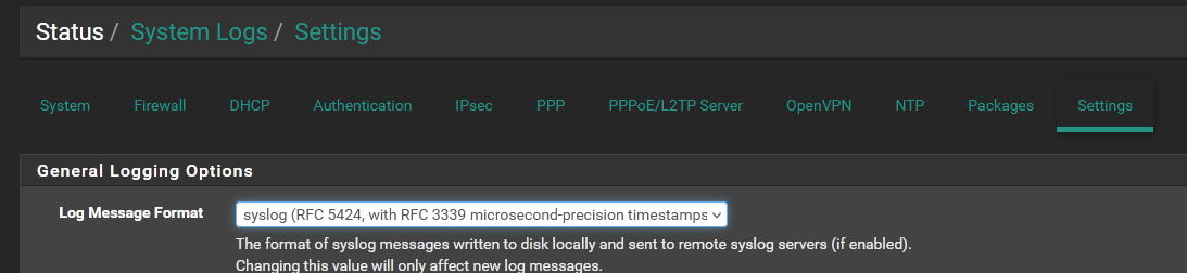

          It could be a big coincidence of course but my last hotplug event:
          2025-06-11 15:35:26.596764+01:00	php-fpm	5667	/rc.linkup: HOTPLUG: Configuring interface opt3
          2025-06-11 15:35:26.596749+01:00	php-fpm	5667	/rc.linkup: DEVD Ethernet attached event for opt3
          2025-06-11 15:35:26.596686+01:00	php-fpm	5667	/rc.linkup: Hotplug event detected for LAN(opt3) dynamic IP address (4: 10.0.1.1, 6: track6)
          2025-06-11 15:35:26.596176+01:00	check_reload_status	648	Reloading filter
          ...was over 52 hours ago.
          I'll keep monitoring.

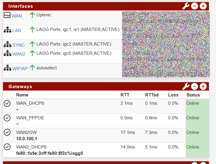

                                            Nothing has changed. Manually disconnecting and reconnecting can result in no IPv6 on WAN, or IPv6 being present on both WAN and LAN, and sometimes it initially appears on WAN but disappears from WAN later.
                                            I am not sure it pfSense, it can be my ISP. I see nothing helpful in the logs currently.
                                            BTW, sometimes the uptime is also missing, and clients have no internet access — they cannot ping external sites by name or IP, also directly can not ping from pfSense. However, I can resolve names using DNS lookup on the pfSense, so Unbound is somehow working. But when I check the routes, it looks like the default route is missing — there is no 0.0.0.0 route at all.
                                            This is happening often when playing manual disconnect and connect after.
