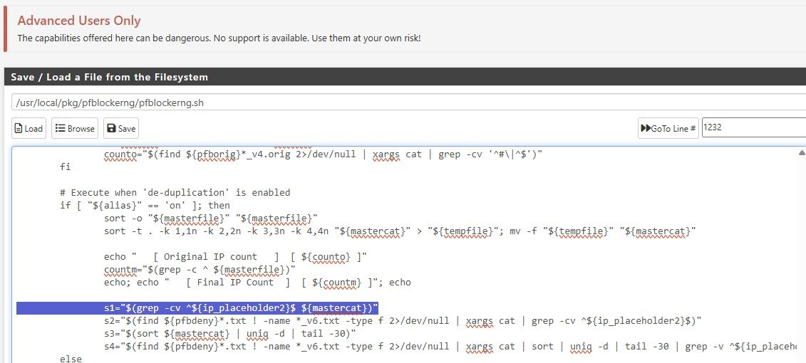

@tinfoilmatt said in New pfblockerNG install Database Sanity check Failed:

@Gianluca-0 What I think you've essentially done here is 'gracefully' broken the function by failing to properly quote the variables
s1ands2.If the 'sanity check' does not output a list of specifically-checked IP addresses, then the function is merely reporting that it "
PASSED" without any errors thrown.This is all speculation. Someone with actual coding skills would need to confirm.
Here's the relevant variables and function from
pfBlockerNG-devel 3.2.10(on CE2.8.1-RELEASE):L1232 & L1233:
s1="$(grep -cv ^${ip_placeholder2}$ ${mastercat})" s2="$(find ${pfbdeny}*.txt ! -name *_v6.txt -type f 2>/dev/null | xargs cat | grep -cv ^${ip_placeholder2}$)"L1278 to L1297:
# Execute when 'de-duplication' is enabled if [ "${alias}" == 'on' ]; then echo '==============================================================='; echo if [ "${s1}" == "${s2}" ]; then echo 'Database Sanity check [ PASSED ]' else echo 'Database Sanity check [ FAILED ] ** These two counts should match! **' echo '------------' echo "Masterfile Count [ ${s1} ]" echo "Deny folder Count [ ${s2} ]"; echo echo 'Duplication sanity check (Pass=No IPs reported)' fi echo '------------------------' echo 'Masterfile/Deny folder uniq check' if [ ! -z "${s3}" ]; then echo "${s3}"; fi echo 'Deny folder/Masterfile uniq check' if [ ! -z "${s4}" ]; then echo "${s4}"; fi echo; echo 'Sync check (Pass=No IPs reported)' echo '----------' fi(For reference, the GitHub build of
pfBlockerNG-develappears to be at version3.2.12as of October 13, 2025. But neither this version nor3.2.11will be available via Package Manager until either is committed to the private Netgate repository.) -

I checked /usr/local/pkg/pfblockerng/pfblockerng.sh and line 1232 is already
s1="$(grep -cv ^${ip_placeholder2}$ ${mastercat})"A sampling of teh log info around the sanity check after a forced reload:
