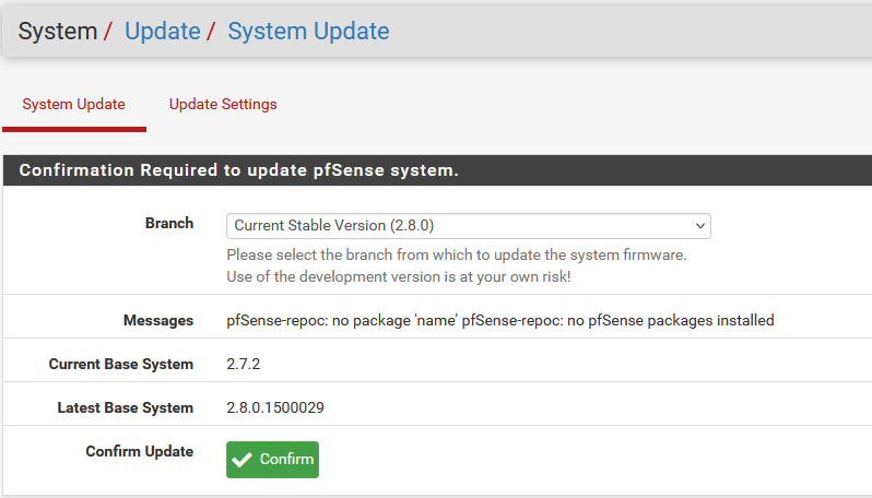

      jiri.zemanek @stephenw10
      @stephenw10 pfSense-repoc -NDJ:
          "repos": {
              "repo": [
          "links": {
              "next": null,
              "previous": null
          "count": 0,
          "messages": [
          "messages_text": [
          "pubkey": {
              "type": "RSA",
              "key": "MIICIjANBgkqhkiG9w0BAQEFAAOCAg8AMIICCgKCAgEA0ww4DLZ1KPhOubCefojk\n+KrkFZ3mvi96AoADnM9ogJ/nykAmAZnAtQeErJyVCQztnKt0OKspHas6grTC4w7O\nt7fw0Lizj2JmY1enA+exmzk2fktY0Bdq1vp+2Y+bZLxdKCs87ocdZtpskC2AbyAf\n48P0pvnr9ueVPO3RotCBUBULAZPr111cHWiDfZbkAQaQ25H9Eh3kcBO7tuwUX0xq\nooDnWzMTPyRX36pczcXu3vqQJwCTvzpozT7D0Qucyf0hwqm3ab4XZmqaIXgjjcj6\nra2tuAIfupXQLZRZnH/hFhqQmBI7UfOVnFLGkZRO1LCQDjSoN3l9Qpiz1o8ARs1r\n94MeSn982worQjdMxvTrGeZSy2mOAexz8c3TH9G5GYN9YSzz4PYYjp0yjgmPfl/6\nSYv7Rp8lEuIklFIjkr3h3gyPi/daIXTZnN8+O3NGc58mfqgQ+kAajQStgnj9kOLZ\noJa3KEie5ravaO961BC9NC6dYJJ5ADl9lznIGfinLxy0TJlstnmavAWbP51lC2F8\newRq0yyJTb+kq7++ZaRHi4xqe7yrkYF/I5gyMR42Heoeq1TQKKiYVkF3X7oWNshq\ntbjaZSOR5ATzTDFehVTDcljBrzeYqIFj0mfgoZ0fIo3QF5iQQcfIOUq/JuFpd0+s\nxWA3MJ4Oq28LRvkMnnVkU40CAwEAAQ=="
          "signature": {
              "type": "RSA",
              "signature": "qel7lnz2U/hrKcuUZUt0sNFNCpzlIo7zXeHWi2wKp4f+xa/yz6J8hjkt56CxuKOym07OSVuYlB5xXaFHLo7koBXpN9cly7Gq2eA4W7xtE5gnaFUluf+pAYam/PlxFcRnVv8WnhGN8NftmO4MLv7BULe+JvFp3I64gzBaogW3fhtNjrleMMQV6jvckJEfh9bcRwnQtdyMcSeruJJWB6XW7mfO60ExbIooY8+x18slqQM5KJlWwm9aKlC4F7xtXRkyNUXn9l1GdRNnlLbXGEomi2rIgQ89iipT8bcG3ZmqkW+F5s4NkdcM6sGiN9yr0ZEAWsEW7Ul2lc1t1y8g+i3px/HawsITsmTkvJP7g0Yi8QxLx9SJb5GeiZVi2S4nIh+FcQahMgSzkGeQdm+oD0L+mhT7z80VhkcWIxGYNPqJO6U300rmSIiEiC3bRAMHE6FaZ3eQZhtBFCqYQeTLDfxfwGJmP6kRSVbHwmoo0qjaXchXvsLbo84xTmIXerQZMBbXEOzFzO8sTAlk5KLlKKvMApvWAtIHsQaCLmgXAAiiQD60rmR4fRfag8neHHDtvoJQ8nrsKctx7em36MBWJuvvQnHO9w7BWwhXOTdjzTQJQW1UAv8g5cXynIEsayo7wS0igEXLFZn92UwJ5k00QPE4oaDjfzXvs9BXr8ia8rgOjVM=",
              "key_signed": "repos.repo"
      I am not running it in Azure, but even if I did I do not see how this should be relevant. I can connect to the instance over SSH/HTTPS so why it would not see a repository?
      Anyway, I am not allowed to burn my time on this anymore, sorry.
      As I can't even make clean install to work properly, I do not have confidence the software is up to the task I meant it for (I have working PoC on linux, unfortunately without any GUI :-/ )
        Hmm, so it's actually sending you an empty repos list. 🤔
        If you can send me the NDI from that in chat I can try to check what the server end is doing.
        What does the output from repoc show for the 'Model'? Is it incorrectly showing Azure? If so that's something I'd very much like to fix.

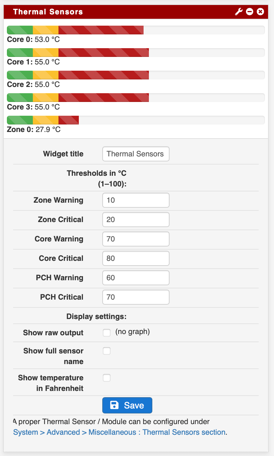

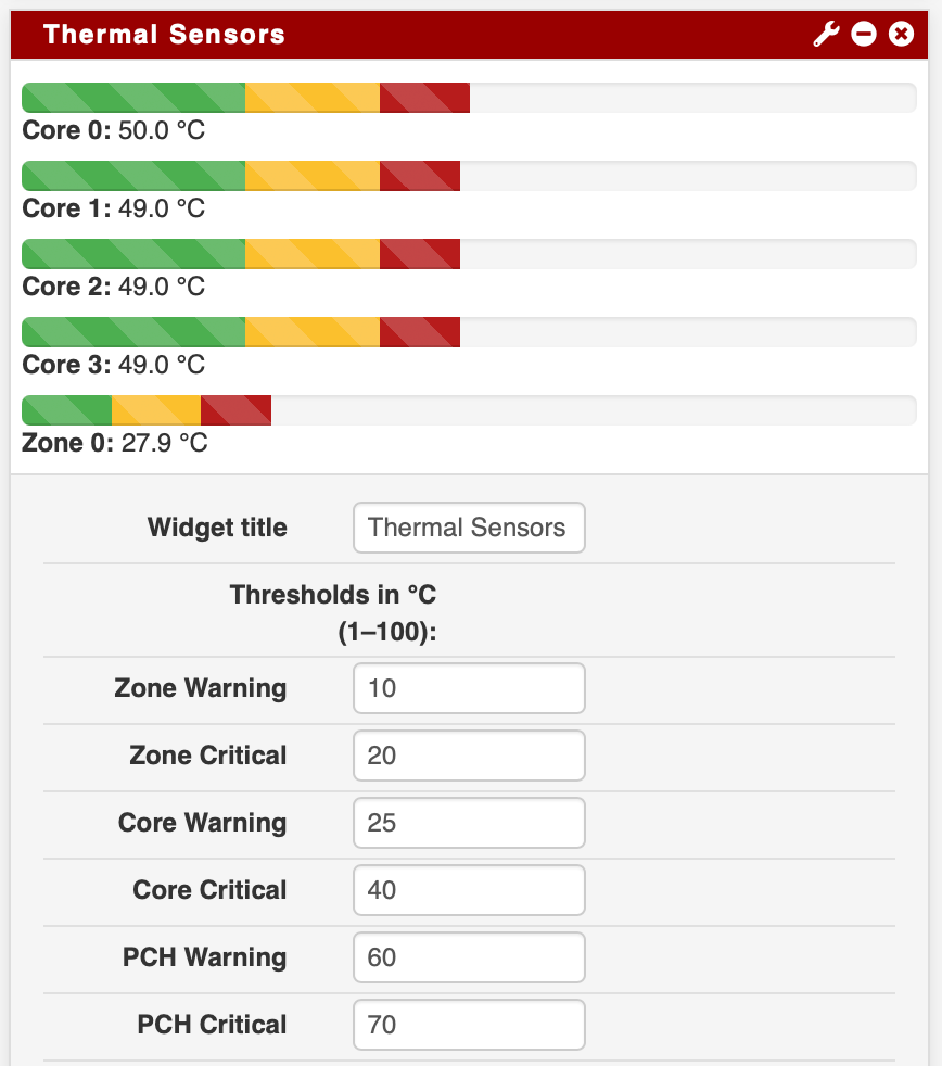

          The upgrade went smoothly, but the thermal dashboard widget has an issue on my system with an Intel N100 CPU:
          As the image shows, the Core temperature bar graphs are using the Zone Warning and Zone Critical to set their color coding. I mucked around with various values for Warning and Critical in both Zone and Core and only the "Core Warning and Core Critical values influence the bar graph colors.
          The full sensor names are:
          dev.cpu.0.temperature
          dev.cpu.1.temperature
          dev.cpu.2.temperature
          dev.cpu.3.temperature
          hw.acpi.thermal.tz0.temperature
          Is this a bug or have I done something wrong?
            Sissy @Sissy
            #ff2600CORRECTION:
            As the image shows, the Core temperature bar graphs are using the Zone Warning and Zone Critical to set their color coding. I mucked around with various values for Warning and Critical in both Zone and Core and only the "Core Zone Warning and Core Zone Critical values influence the bar graph colors.
              Hmm, OK I see here. Digging....
                Just to be clear you didn't see this in 2.7.2 with the same hardware?
                  Yeah, I see how this is failing. And would always have failed.
                  https://redmine.pfsense.org/issues/16266
                    Sissy @stephenw10
                    @stephenw10 said in Now Available: pfSense® CE 2.8.0-RELEASE:
                    Sorry for my delay in replying. Working through the 2.8.0 update process today pushed the cores well above where I had the Zone Warning set. That's probably why this problem only today caught my eye.
                    Thank you for so quickly jumping on this and determining the root cause. I see that you've targeted the fix for 2.9.0, which I fear could be a long way off. Is there any chance of creating a patch for 2.8.0 sometime in the next few months? I mean that as a humble ask, not an entitled demand.
                      Yup you can test the patch if you're able to:
                      1231.diff
                      S 1 Reply Last reply Reply Quote 3
                        Sissy @stephenw10
                        @stephenw10 Works great! I just did a cut & paste from the file to the System_Patches utility, pasted the description "Thermal Sensors Widget Thresholds not Evaluated," and applied the patch. The problem was immediately fixed, with the following screenshot showing the results (with test values for thresholds to illustrate the change):
                        If you're planning to push it out as a formal patch, I think that you're good to go.
                        Thanks again!

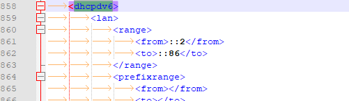

                                  @bimmerdriver said in Now Available: pfSense® CE 2.8.0-RELEASE:
                                  Argument #1 ($arr) must be of type array, string given
                                  "<dhcpv6>" is searched in the config file.
                                  Oen yours in a aditor (NOtepad++) and look for "<dhcpv6>" and see for yourself.
                                  Normally, it's a array type called <dhcpv6> and it should contain, for each LAN type interface , a section, like <lan>, <opt1>, >opt2> etc.
                                  Like, this :
                                  It looks like your <dhcpc6> is totally empty ?!?, thus not an array (filled with per LAN interface dhcpv6 setting), so it became a simple text string => that's the error.
                                  <dhcpc6> empty : go to your dhcpv6 settings page(s) and save them all.
                                  This should populate <dhcpc6>, thus it becomes an array, and the error will be gone.
                                  Why all you array items (<lan>, <opt1>, >opt2> etc) in <dhcpc6> were gone : I can't tell.
