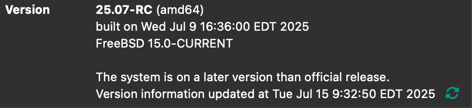

        • MBehr2M Offline
          MBehr2

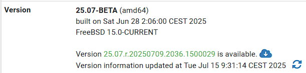

          Does this change once the final is released?
          I N 2 Replies Last reply Reply Quote 0

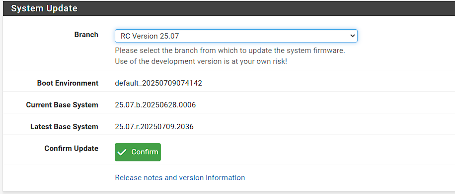

          • I Offline
            ITSGS_ @MBehr2

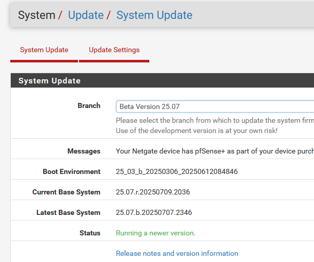

            Upgraded my SG4200 from 25.07.b.20250707.2346 to 25.07.r.20250709.2036 without issues. Running ACME, DynDNS, HAProxy, pfBlockerNG and some other minor packages.
            • N Offline
              netblues @MBehr2
              @MBehr2 said in pfSense Plus 25.07 Beta Now Available:
              Yes it will.
              And actually what it says is correct. Beta versions are always newer than release versions.

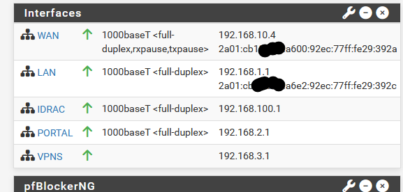

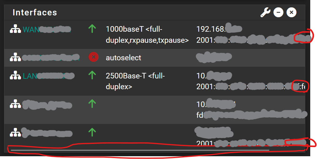

                        By the way, in the web GUI Dashboard, in the Interface Widget, would it be possible to modify it to see the whole ipv6 without horizontal scrolling in the final version or next beta ?

                          @yellowRain said in pfSense Plus 25.07 Beta Now Available:
                          Scrolling ?

                            Correct. I solved my issue, yet again an ISP issue on the DHCP6 server side, but they would not help me...
                            I had to manually change the DUID, as the old looked blacklisted. My LAN prefix, and the pfsense WAN adress has changed as a result.
                            My pfsense have long interface names, thus ipv6 are partially displayed, and a horizontal scrolling bar appears on the bottom of the widget:
                            N Y 2 Replies Last reply Reply Quote 0

                                    Currently, with "Track interface" we have only the 2 former ipv6 addresses.
                                    OpenWRT, Win11, Linux behaves in this way.
                                  fyi, my RA is configured in "Assisted mode"
                                  => this is the perfect setting for clients in the LAN (they all can set local-link, GUA through SLAAC, GUA through DHCPv6 if implemented, multiple ULA).
                                  1. Another thing my ISP box does not allow me to do, is to set static DHCPv6 adresses in the Prefix delegation range. For the pfsense router itself, It would make sense to get a 4th ipv6 address :
                                  • GUA set through ISP DHCPv6 "delegated global prefix : custom suffix".
                                  1. Today, to get the ULA in combination with the GUA on PfSense itself, we need 2 LAN interfaces, at least in my understanding :
                                  • One configured with SLAAC, with no DHCPv6, but with RA advertising "fd...".
                                  • Another one configured with Track Interface, with DHCPv6, with RA advertising "20...".
                                  Another setting I have not tried is RA Router mode "Stateless DHCP"
                                  1. On OpenwRT, if one want both RA ULA & GUA on one interface, it is possible, but there is a missing setting in the WebUI Luci, that should be set manually "ra_preference" to "low", "medium", "high" in /etc/config/dhcp, to manage the race in condition of 2 RA on same subnet.
                                  2. PfSense misses ipv6 usual configuration & bad settings such as https://openwrt.org/docs/guide-user/network/ipv6/troubleshooting
                                  3. @netblues this question is often asked on this forum, it is because it is a public forum. The debate wether disclosing private address range, or even only disclosing part of public range, constitute a security issue should be another whole topic.
                                  Y GertjanG 2 Replies Last reply Reply Quote 0
