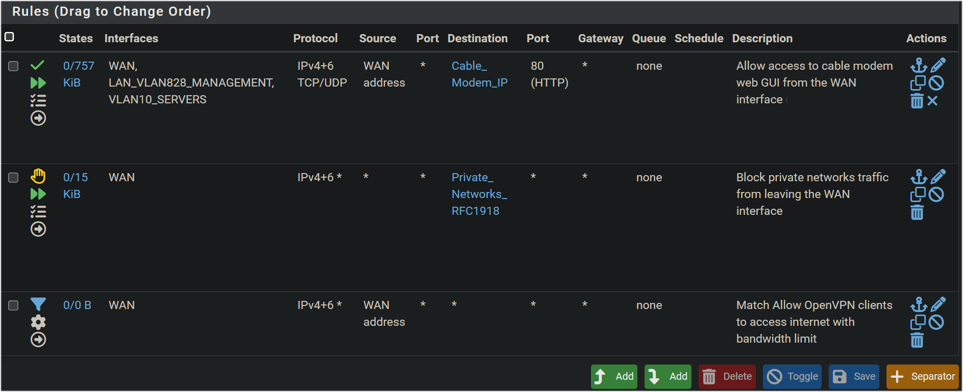

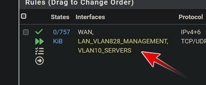

            I noticed that the pass floating rule must apply to both WAN and LAN interfaces
            In above pic, the floating rule allows access to modem from LAN and VLAN10
            I'm just trying to undestand why and the networking logic behind it, for educational reasons. I'm not looking at: is it really useful, that issue is so rare and unprobable...
            Do you have an explanation of this ?

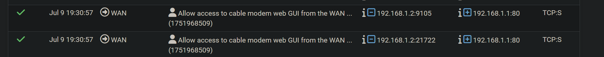

              The floating rule has the proper source WAN address expected after NAT
              The logs properly show the source address for requests is WAN address 192.168.1.2
              However, the flosting rule must be applied to the originating LAN in addition to WAN

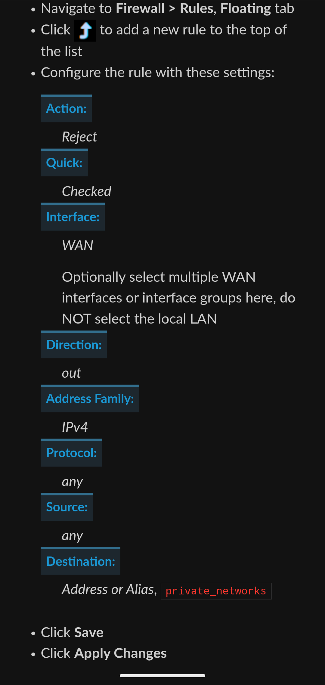

                  By the way, I followed this official guide to add the flaoting rule:
                  https://docs.netgate.com/pfsense/en/latest/recipes/rfc1918-egress.html
                  And there is this note:
                  Notesยถ
                  Adding this rule to the firewall will block access to bridge devices like cable modems or upstream routers outside of the WAN interface. For example, many cable modems use an IP address of 192.168.100.1 by default. This may or may not be desirable behavior for users. The RFC 1918 firewall rule needs to be bypassed with a specific pass rule above it, or disabled, if clients inside the LAN require access to this type of device.
                  On the interface options (Interfaces > WAN, for example) there is an option to Block private networks. This is a rule blocking inbound traffic, not outbound like the rule described here. As long as the firewall is not behind a WAN that uses private addressing, both types of rules are desirable and should be enabled.[/quote]
                  Now, to allow access to the modem on WAN, we need the above floating rule
                  Why the hell it needs to be applied to LAN in addition to WAN ?

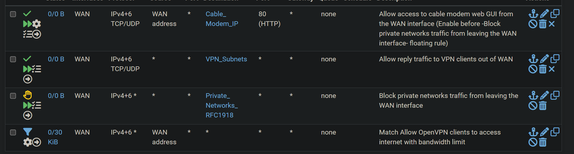

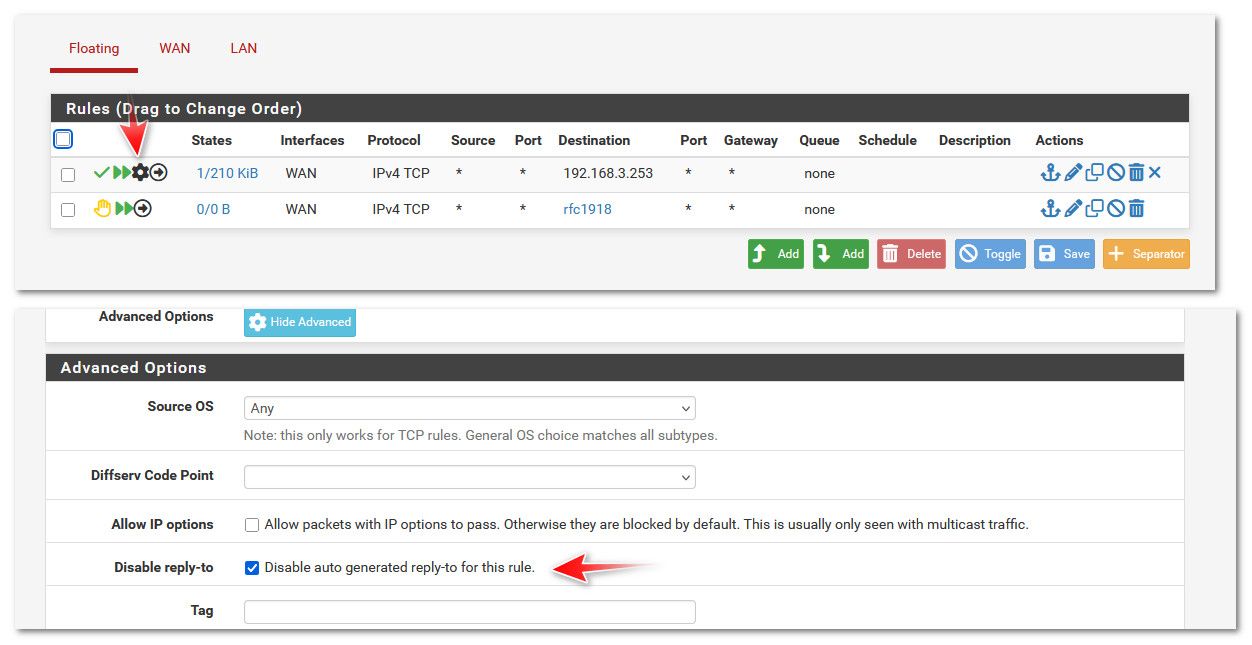

                      Here's screenshot from netgate recommendation illustrating the floating rule on WAN
                      Now, with that rule, as the doc says, you need an allow rule before it. The thing is that the allow rule must apply to all interfaces the filtered packet travels through and not only Wan
                      I suppose it is a strict security that the stateful inspection needs to track the packet through all its lifespan

                          1- I followed the netgate recommendation guide I linked above to add the floating outbound rule on WAN to "block private traffic from leaving the WAN"
                          2- Now, to allow traffic from VLAN10 and VLAN828 to the ISP modem, liek the guide hinted, I added a floating pass rule applying to WAN interface.
                          3- The Problem: Unless the pass rule is applied in direction Out, on the originating LAN (VLAN10 or VLAN828), in addition to WAN, the traffic to modem from theses VLANs is blocked by the block rule we added.
                          -> From my readings, I saw some opaque explanations that a stateful firewall needs to follow the packets through all their life cycle (complete state) before allowing them in a floating out rule. They say many firewally act like this.
                          I just didn't find any official documentation or logical explanation or statement
                          As you maybe agree, the pass rule, applied to WAN interface, is what we logically expect. The logs below also show that the final decison on pass rule is made on WAN (and not originating VLAN) and that the source is 192.168.1.2 (so, VLAN828 client natted to WAN address as expected)

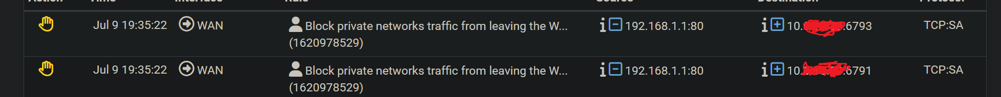

                          If I remove VLANs from the floating out rule interfaces, I get this log from the netgate applied block rule:
                          As you can see, it seems to block the return traffic from Modem to LAN and not when it went out as I expected source 192.168.1.2 -> destination 192.168.1.1
                          I am just asking if it is really the tricky part about Out rules AND expected
                          Or if it is a bug

                            @phil80 well your 2nd block is a SA to some 10.x address.. Why are you hiding some 10. address? What is that 10.x - Since it is syn ack coming from your modem at 192.168.1.1 - how would that possible be outbound your wan? That is not your pfsense IP address that is 192.168.1.1 sending a SA to whatever 10.x is?
                            Seems like you have a real mess.. It would not be possible to see SA from some other device on pfsense as outbound on its wan interface.
                            Is this 192.168.1.2 IP of pfsense a vip or the actual native IP of pfsense wan. What is this 10.x, where is it? Are you bouncing off some proxy you running on pfsense, you have some port forward setup?
                            If I talk to some 192.168.1.1 IP from pfsense wan at 192.168.1.2, how would the SA be trying to go to some 10.x address out your wan?

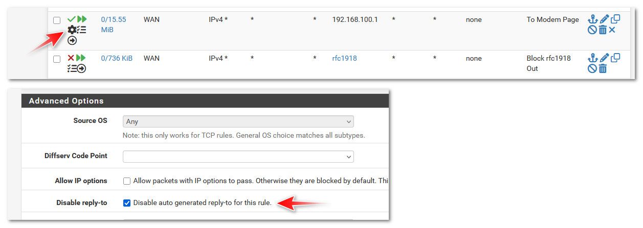

                            my wan is 209.x.x.x (public ip) to reach my modem management IP on 192.168.100.1, I setup a vip on my wan interface.. Traffic going to my modem is allowed, see the rules I posted above from my floating. I do this because I block noise going out my wan to rfc1918 - being a good netizen - there is no rfc1918 I would ever want to reach, or even could reach other than that 192.168.100.1 IP of my modem.
                            If say I typo something and try and go to 10.1.2.3 then yes my wan outbound would block that since I don't have any 10.x.x.x network behind pfsense - so it would send it out its default gateway (my isp) via a public IP.
                            The only thing I had to do is set that do not create reply-to on my allow rule.. And I can talk to my modem management IP just fine from my pc on my lan of 192.168.9.100.. No other rules are needed.. If I sniff on my wan while talking to my modem IP it shows traffic between 192.168.100.1 and my wan vip of 192.168.100.2
                            But your modem trying to send a SA to 10.x shouldn't ever be outbound out your wan. I don't even know how that is possible for pfsense to see that traffic.. Unless your 192.168.1.1 gateway to try and get to 10.x is through pfsense and pfsense is then routing that traffic out its wan to get to 10.x - which makes no sense!!

                                • P Offline
                                  phil80 @johnpoz
                                  @johnpoz
                                  No, wan and vlan10 are on separate lan cards.
                                  NAT works as the pass out rule log I posted shows
                                  VPN has nothing to do with lans. It is for outside internet access and not used here
                                  Pfsense is on dedicated hardware
                                  I initially thought the logs were showing the states origin. But in any case, there's something wrong and I would post an issue on redmi if relevant
                                  • johnpozJ Online
                                    johnpoz LAYER 8 Global Moderator @phil80
                                    @phil80 so I tested this on my 2.8 VM behind my normal pfsense.
                                    internet - pfsense 24.11 -- 192.168.3.253 -- 192.168.3.109 -- pfsense 2.8 -- 192.168.9.34 -- 192.168.9.30 client
                                    And did not work - I had to set this for it to work.
                                    Without that set - could not access my upstream pfsense on 192.168.3.253.. With it set no problem.
                                    We ran into this awhile ago - thought it was related to using a vip. But it is related to native as well it seems.
                                    If you set that on your allow rule above your deny rfc1918 it should work. Kept meaning to do a deep dive on what exactly that setting is doing that would prevent this sort of thing.. But haven't gotten around to it, there are some older threads about this. And if you will notice I asked before if you had that set or not..
                                    https://docs.netgate.com/pfsense/en/latest/config/advanced-firewall-nat.html#disable-reply-to
                                    I could see how a vip or vpn could be seen as another wan and cause problems.. But in this test I did the only wan interface is pfsense normal wan with native 192.168.3.109 IP.. So I am not clear on why the reply-to causes a problem here.. But it does - if you disable it on your allow rule to your upstream router from pfsense you should work. It does in my test, and it does with my vip access to my modems management 192.168.100.1 IP.
                                    • P Offline
                                      phil80 @johnpoz
                                      @johnpoz
                                      Thank you for testing
                                      In fact, I just tried it. It works after applying disable reply-to to the pass rule and after setting it to only wan interface
                                      The logs also show a proper traffic source-direction for the pass rule
                                      So, it seems like disabling the reply-to has the exact same result as applying the rule to WAN AND VLan10 interface
                                      Stil I cannot follow the routing logic behind it
