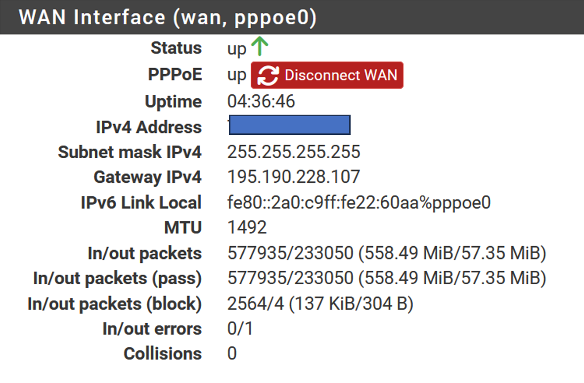

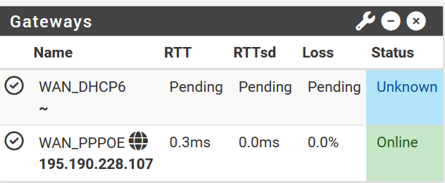

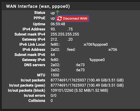

      On the dashboard my IPV6-gateway is still shown as unkown (see pictures below).
      Which is very strange IMHO, since under interfaces you can see that GW IPV4 and IPV6 addresses are known and can be pinged.
      A simple ping would show if the GW does have IPV4 and/or IPV6 connection including the related ping times. SO I do not understand what makes it so hard to solve this problem !!

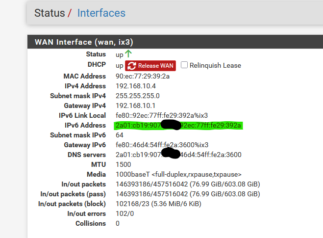

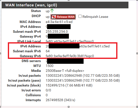

        That interface doesn't have a routeable IPv6 address or an upstream route for IPv6 traffic. The monitor display is consistent with that.
        Pic below is for a WAN interface with IPv4 and IPv6 configured (the latter boxed in red).
        Your gateway would only be pingable at its WAN v6 LLA from a device on that network segment (and probably not even then because of PPPoE ... can't test here).

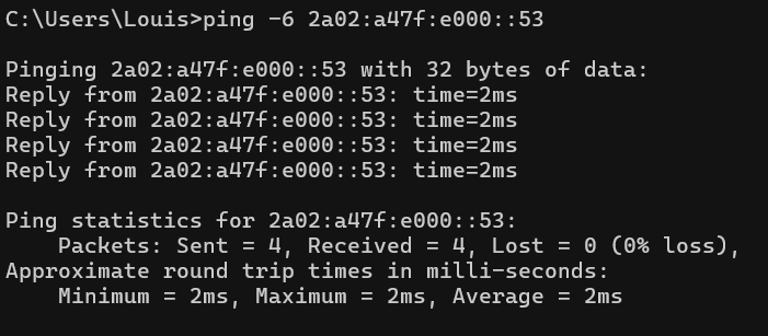

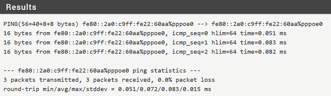

          You can ping a link local address from within the local lan no problem! And my IPV6 is working. See below.
          I really do not understand the problem!

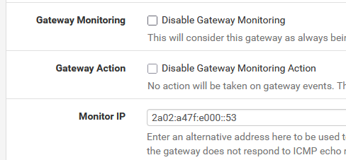

            If 2a02:a47f:e000::53 (ns1.ipv6.kpn.net) works = replies to ping, why not use it as a gateway test IPv6 ?
            Edit the IPv6 "System > Routing > Gateways > Edit" and add
            Save.
            You should be fine now.
            That said, normally, you should have a 'real' rout-able IPv6 on your WAN interface :

                      A link-local WAN gateway absolutely should not be accessible from the LAN. It would only be accessible from the same layer 2 segment which would be the WAN side here.
                      Looking at your tests it looks like you're pinging something local though. There's no way you'd see a response in 0.05ms over a pppoe link! In fact that looks like you're pinging the same address as the source.
                      0.3ms on the IPv4 gateway also seems unlikely but possible.

                        That's a KPN nameserver. Is KPN your ISP and, if so, can you ping hosts upstream of their network like Google DNS, 2001:4860:4860::8888 ?
                        Also, does netstat -rn | grep default show a default v6 gateway?

                          Yep KPN is my provider and of course I could ping the name server or the ^white house^ to check if there is connectivity.
                          However IMHO, that is not relevant. I just want to know if the providers network is reachable!

                              The interface IPv6 address should be your local Link-local address. The gateway IPv6 address should be the ISPs link-local address.
                              Neither of those should be pingable from a client on another internal interface.
                              For some reason your interfaces status page doesn't show an IPv6 gateway but you are able to ping external IPv6 addresses.
                              So you must have an IPv6 gateway. What does it show as in netstat -rn?

                                  The trunk towards my provider is connected via nic igc
                                  • there are three vlan's 4,6 and 7 and next to that ^default vlan0^
                                  The pfsense interface screen shows:
                                  IPv6 Link Local fe80::2a0:c9ff:fe22:60aa%pppoe0
                                  netstat entrys as related to nic igc and ppoe are:
                                  ::/0 fe80::9217:3fff:fe7f:e4a1%pppoe0 UG pppoe0

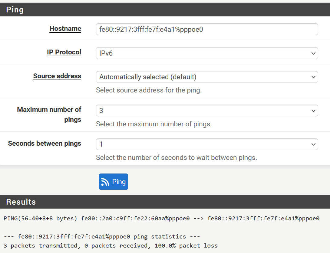

                                    Ok so you have a default route via the ISP gateway. dpinger should be seeing that and trying to ping it.
                                    Does that respond to ping from pfSense? With a reasonable response time?
                                    Check the logs for when that route is added.

                                        Ok so the gateway doesn't respond to pings. Assuming that's still the same gateway.
                                        So set an external IP to use for monitoring.
                                        Though I would still expect to have seen dpinger try to ping and show loss rather than pending.
