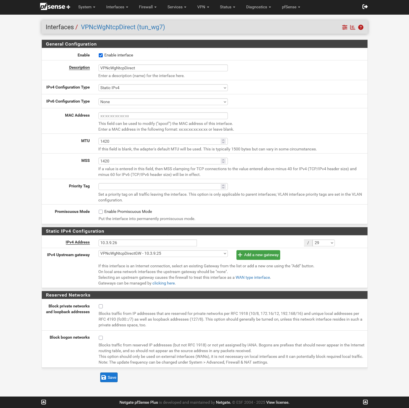

            Screenshot 2025-07-17 at 11-28-44 pfSense.internal - Interfaces VPNcWgNtcpDirect (tun_wg7).png
            Another reboot fixes it.

                And it happened again. Tomorrow I will recreate this WG-interface just to make sure.
                		<opt1>
                			<descr><![CDATA[VPNcWgNtcpDirect]]></descr>
                			<if>tun_wg7</if>
                			<enable></enable>
                			<spoofmac></spoofmac>
                			<mtu>1420</mtu>
                			<mss>1420</mss>
                			<ipaddr>10.3.9.26</ipaddr>
                			<subnet>29</subnet>
                			<gateway>VPNcWgNtcpDirectGW</gateway>
                		</opt1>

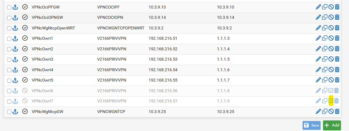

                                      Mostly this (klicking it):
                                      But this is only an example, because every WireGuard running through OpenWRT-VMs is doing fine, only WireGuard running on pfSense itself makes problems.
                                      Right now, when I went there, I saw one gateway was down again and WG was stopped. This is new behavior to me. Interestingly it was that tunnel again, which I had recreated (the last Gateway in the picture).
                                      The other end is a WireGuard installation done by me inside of Debian (Proxmox VE). I disabled and re-enabled the gateway (instead of just enabling it, because it was already enabled by me after the boot, where it was disabled like all the others) and I restarted WireGuard, up again and running. This is odd and problematic. "Fixing" it after a reboot is one thing but having it going down while in use is another...

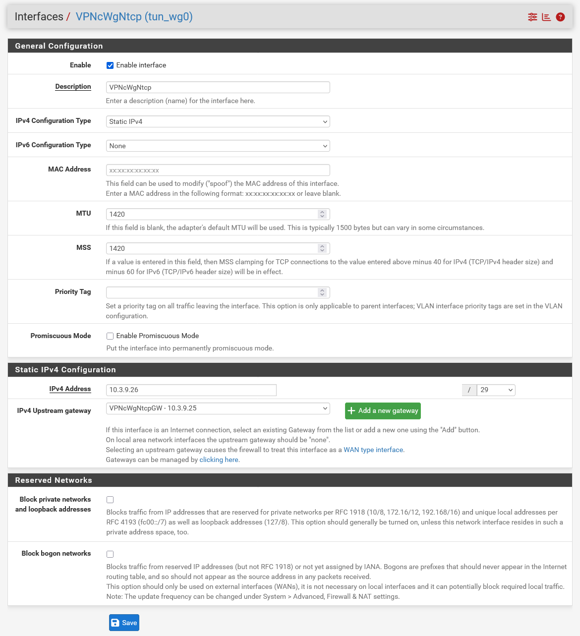

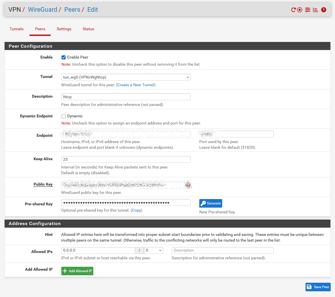

                                        @stephenw10 Here is the config of the most problematic WG-Interface, just in case.
                                        Screenshot 2025-07-21 at 14-33-06 pfSense.internal - Interfaces VPNcWgNtcp (tun_wg0).png
                                        Screenshot 2025-07-21 at 14-36-01 pfSense.internal - VPN WireGuard Peers Edit.png

                                            Yup I meant if the tunnel subnets did not exist then dpinger would be expected to fail. They are there in that output but is that after rebooting when WG fails to start?
                                            It feels like it could be a timing/ordering issue where dpinger tries to start before the WG config has been applied creating the routes. But if so that should be evident in the log order.
