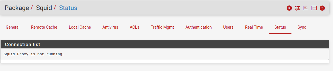

      As the title says, there is a problem after upgrading from version 2.7.2 to version 2.8.0
      squid not working
      squidGuard not working (Probably because squid doesn't work)
      ups status shows red question mark
      The disk is half full, 26 gigabytes. (How do I delete it or set it so it doesn't reach this volume?)
      This is the message I get in Notices
      on the top right of the dashboard
      PHP ERROR: Type: 1, File: /etc/inc/util.inc, Line: 3961, Message: Uncaught TypeError: array_get_path(): Argument #1 ($arr) must be of type array, null given, called in /usr/local/pkg/squidguard.inc on line 1092 and defined in /etc/inc/util.inc:3961

      How do I fix these problems?

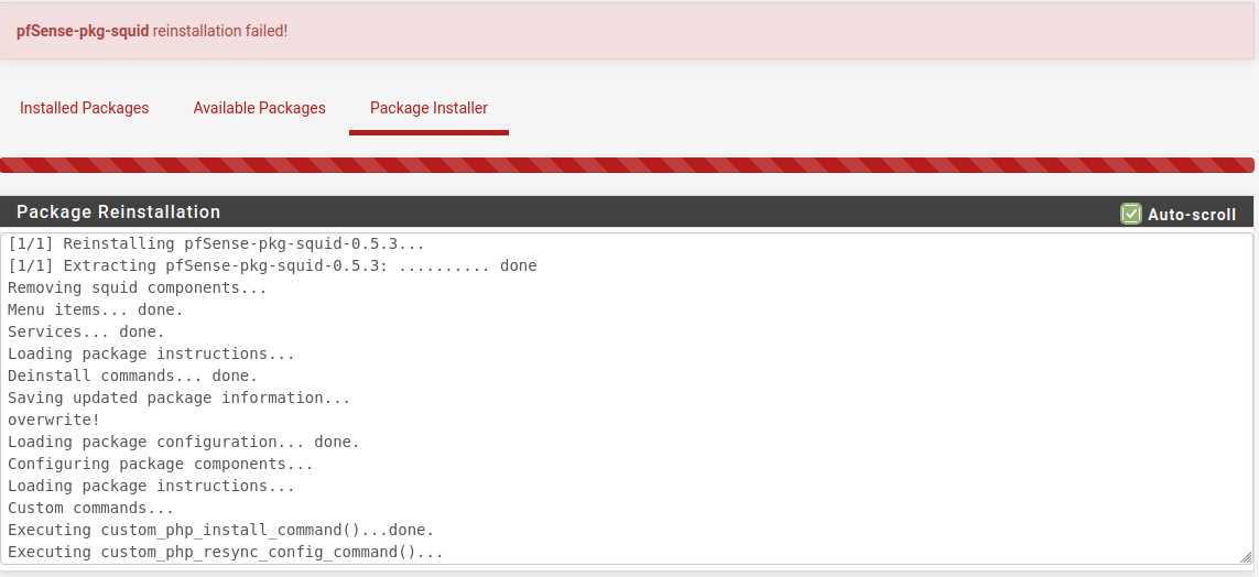

              @stephenw10 said in Squidguard problem after upgrading from version 2.7.2 to version 2.8.0:
              I assume you have tried reinstalling both?
              No
              Because I don't know what to do I didn't want to do more damage
              Try reinstalling the packages first?

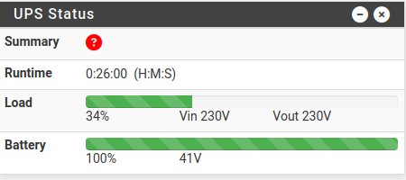

              this is the ups pic
              what is the red question mark for ?

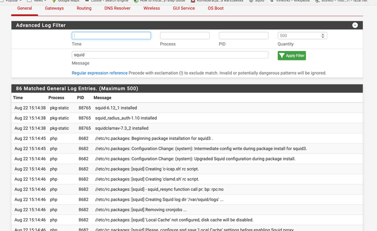

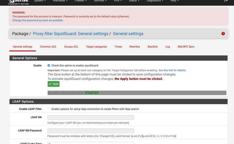

                Squid installed fine on my VM
                So does Squidguard
                The only issue I see is that status page PHP problem I opened a Redmine for because of the changes made to how the status page is accessed
                Have you cleared your cache and maybe resave you Squidguard url blocks?

                  @firefox That is related to UPS not squid for battery backup
                  Make sure to upvote

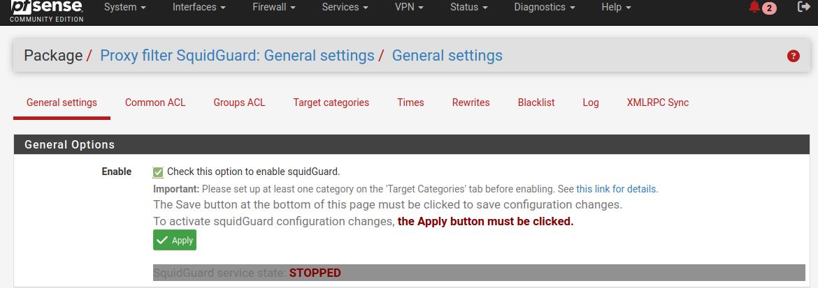

                              • F Offline

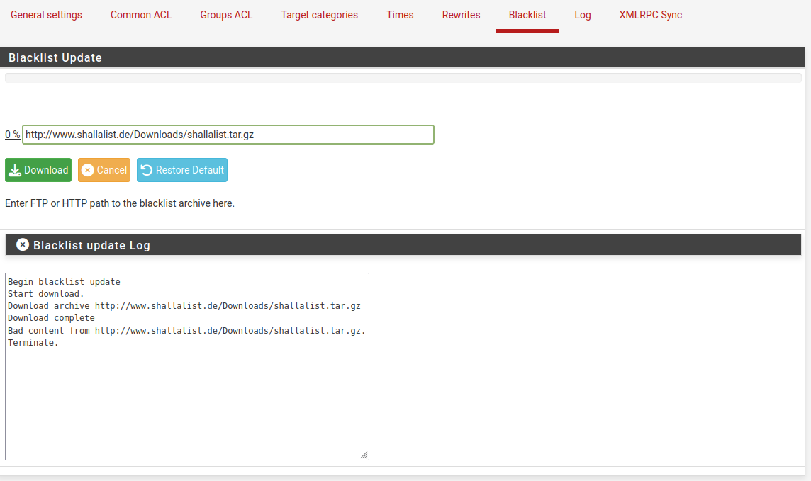

                                firefox @JonathanLee
                                @JonathanLee

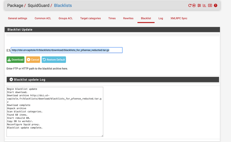

                                • JonathanLeeJ Online
                                  JonathanLee @firefox

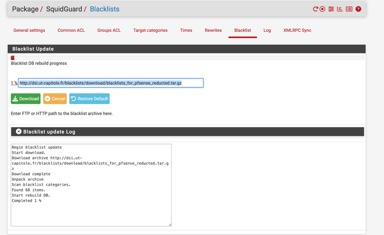

                                  @firefox There is a problem that is no longer active use this
                                  http://dsi.ut-capitole.fr/blacklists/download/blacklists_for_pfsense_reducted.tar.gz
                                  This blacklist is great they also take submissions I send stuff all the time.
                                  Make sure to upvote
                                  • F Offline
                                    @JonathanLee
                                    it updated
                                    I clicked apply and then save
                                    But they still don't work
                                    JonathanLeeJ 2 Replies Last reply Reply Quote 0

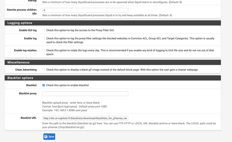

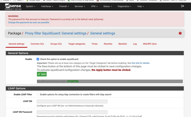

                                      @firefox Did you save that in the general settings area?
                                      Works for me
                                      Make sure to upvote

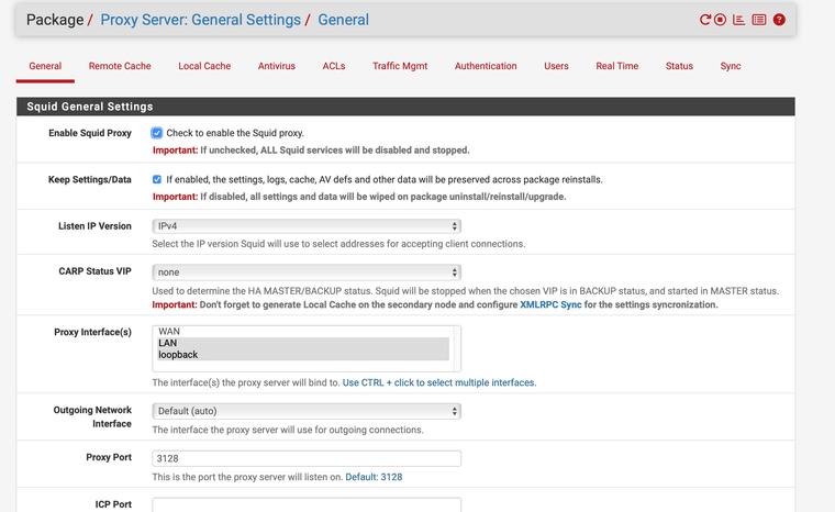

                                        @firefox
                                        Are you doing loopback also?
                                        Make sure to upvote
                                        • F Offline
                                          @JonathanLee
                                          yes
                                          the list update worked
                                          and i did save in the general settings area
                                          but it is not working
