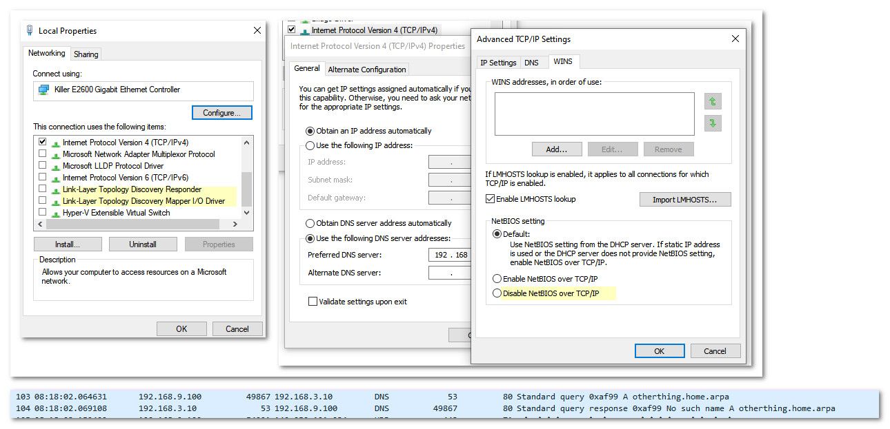

        Lets see the output of ipconfig /all on your machines - this will show where you point for dns, what its using for a seach suffix, etc.,.
        example, my pc
        C:\>ipconfig /all

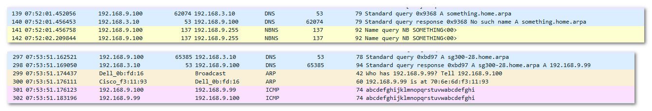

        Another way to see where you are pointing for dns is just nslookup
        C:\>nslookup
        Default Server:  pi.hole
        Address:  192.168.3.10
        See how that matches up with my ipconfig output 192.168.3.10 is the name server my machine points too - in my case running a pi hole, which forwards to my pfsense for dns, and then my pfsense resolves external records.
        My guess is you have your clients pointing to some external dns like google or something - and then no you would never be able to resolve your local resources.
        Your clients should point to pfsense for dns, or another local name server you want to run.. This would resolve all your local resources either through dhcp registration of their names, or you manually creating the records, or reservation in dhcp that register the name in dns.

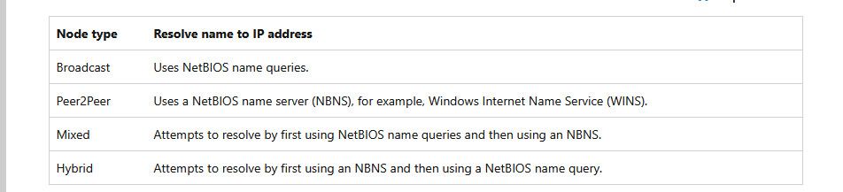

            LLMNR - link local multicast name resolution. = NOISE ;)
            NBNS - netbios.. Maybe you are too young to remember that, hehehe ;) Back in the days before dns.. You use to have to run wins to be able to resolve name that did not exist on your local network. Or to not fill your network with everything broadcasting for everything.. But wins went away when MS came out with active directory and switch to dns.. I mean it hung around for a long time.. But your talking what 25 some years ago when AD came out.
            edit: netbios will still happen, if you have it enabled when you query something without being fqdn, or no answer.. So I just tried to ping something, you will notice it auto added my domain home.arpa to the query even though I just did a ping something. And it tried netbios when there was no response returned address. See how destination is 192.168.9.255 (directed broadcast)
            then did a ping for my switch, with just its host name sg300-28, and again it did a fqdn query auto adding the domain home.arpa - notice since it got a response, no netbios broadcast went out. It just arp for the mac and then started the ping.
            edit2:
            Here just to be complete - this is where you would disable llmnr and netbios - notice now when I do a query for otherthing, it did just the dnsquery, but no netbios broadcast for the the name.
              This should work fine if hosts are using pfSense for DHCP and the dhcp leases are set to register in the resolver.

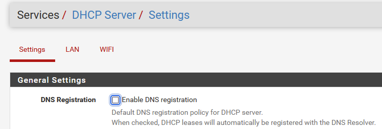

                  @stephenw10 said in upgraded to pfsense 2.8.0, WiFi devices report intermittent 'no internet access':
                  Are you saying that I should turn this on?
                  I would kind of prefer to find a solution within pfSense and not have to modify the OS default settings to be honest because then I would have to remember to do that to a new OS (host) on the network.

                    johnpoz LAYER 8 Global Moderator @skubany2
                    @skubany2 said in upgraded to pfsense 2.8.0, WiFi devices report intermittent 'no internet access':
                    Node Type is 'Hybrid', yours is 'Broadcast'.
                    I specifically set my to broadcast because hybrid is pointless without wins.. Which people have not run in years and years.
                    The only possible one that makes sense if not running wins (which who would be) is broadcast. Simple enough to set with a dhcp option. (option 46, 1)
                    Here is what I would suggest - turn off that noise machine llmnr, it never going to work across networks. Pick a better domain name, home.arpa would be my suggestion. And once you know everything is resolving you can turn off netbios if the device/os allows for it.
                    And either turn on dhcp registration, or setup up reservations. I use reservations for everything on my network - one because why would things that I want to resolve need/want to change IPs.. Most everything on my network is on 24/7 anyway. I do run dhcp with small scopes for when I add a new device, etc. But once I know its going to be on the network - say I add a new or different wifi lightbulb or something. I just move it to a reservation. If my dns is down for some reason - I can easy access something by its IP, no worry about having to look up what IP it might be on.
                    I also normally have a long lease time for most of my scopes as well - no need for dhcp traffic every hour when they are not going to change anything - if I do change something in the options. They will either pick it up in a few days or can just power cycle devices, etc.
                    If your not going to go with reservations - you more than likely want to look into using kea vs isc - because issue for many years is unbound restarts on any dhcp event if you register dhcp. Not a big issue if you only have a few devices and you use long lease - but when you have lots of devices and short lease - unbound will be restarting all the time on a dhcp event. And if you run stuff like pfblocker with loads of stuff being blocked, dnsbl and etc a restart can take a while vs just a second or 2.. These can lead to dns problems. In the latest version of pfsense kea has supposed have corrected this. Where dhcp events do not force a restart of unbound.
                      stephenw10 Netgate Administrator @skubany2
                      Yes.
                        skubany2
                        "Enable DNS registration" did the trick.
                        I can now access WIFI (Win11) and LAN (Win7) hosts in both directions via host name. On Win7 I had to modify OS firewall rule to add the WIFI subnet address to allow file sharing. I did not have to change Win11 OS firewall at all, from the default.
