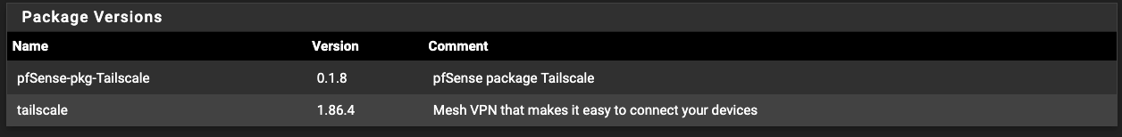

          @hfederau Which Tailscale Version is running on your pfsense? mine is -> Bildschirmfoto 2025-09-20 um 21.39.50.png

                                @hfederau For comparing, you use which pfsense version, I use CE 2.8.1, and Tailcale version 1.86.4, why I ask, is, pfense 2.7.2 is BSD 14, during the new pfsense 2.8.1 is BSD 15, which then may requiere, we use the right matching Tailscale version.... there is here in the forum, a Thread, for updateing Tailcale... and have an eye for the right BSD version... if you in pfsense 2.7.x you need BSD version 14, if you on pfsense 2.8.x you need the BSD 15 version

                                      @hfederau Actuallly, if you on pfsense 2.8.1, you should install/update to 1.86.4 in your pfsense shell with the command with date today 20.9.2025:
                                      pkg add -f https://pkg.freebsd.org/FreeBSD:15:amd64/latest/All/tailscale-1.86.4.pkg
                                      If you on pfsense 2.7.2, you on BSD 14, and then you should use this shell command to install/update to latest version (date today 20.9.2025)
                                      pkg add -f https://pkg.freebsd.org/FreeBSD:14:amd64/latest/All/tailscale-1.88.1.pkg
                                      H 2 Replies Last reply Reply Quote 0
