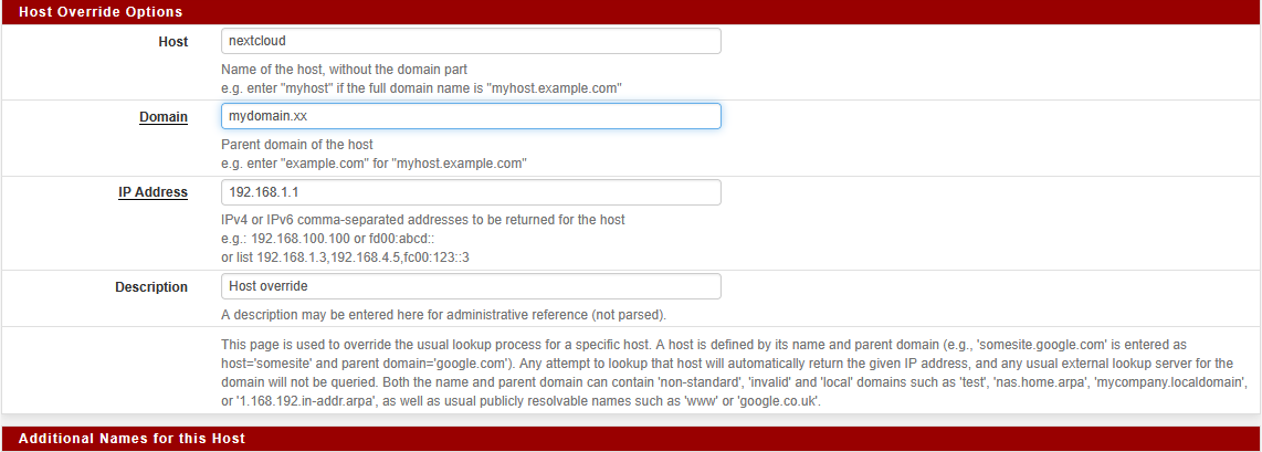

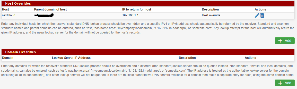

          Many thnx for reply. Im kinda sure i did that already. Did i do any mistake here? After doing all this i even rebooted box. That counts as restart unbound?

              I have only this
              tinfoilmattT 1 Reply Last reply Reply Quote 0

                      Yeah, i agree. Something is serving my whole LAN not only 214. Any other server i add to proxy behave totally same.
                      TBH i have no idea what can serve my LAN in loopback. And i dont dare to experiment with any of setting at General or Advanced because i dont know 80% what they actually do.
                      But, could this do something like this?

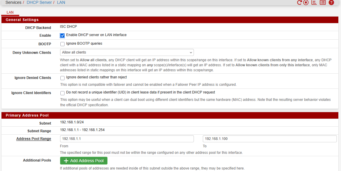

                        @ha11oga11o I suspect your DHCP configuration.
                        • H Offline
                          ha11oga11o @tinfoilmatt
                          @tinfoilmatt
                          Nothing there that i can see. Nothing is added all is actually unticked. Only i tweaked was long time ago to define static pool and thats it.

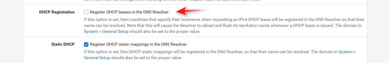

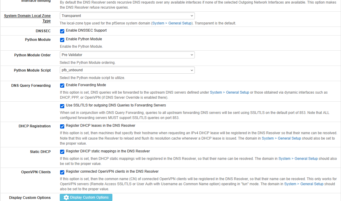

                                  johnpoz LAYER 8 Global Moderator @ha11oga11o
                                  @ha11oga11o you are prob registering dhcp in unbound. Or you are registering statics if you have a reservation which is why your seeing both.
                                  Look in your unbound settings - do you have this checked?
                                  Is then yeah you would have your host override you created and also the dhcp entry - which is why you would get 2 answers.. And yeah they could flip flop with .1 being first one query, and .214 being first next query, or 3 queries latter etc..
                                  This is one of the perfect examples of why you shouldn't use your pubic domain internally.. Then you never can run into such problems.
                                  I have multiple public domains where I can point records at my public IP.. But I use home.arpa internally.

                                    ha11oga11o @johnpoz
                                    @johnpoz
                                    Yes, it seems i have. Should i uncheck it?
                                      @ha11oga11o you can uncheck that - but you would then loose ability to resolve any resources internally unless you create host overrides for them.
                                      Or set reservations for them and register those.
                                      See my edit of previous post - not a fan of using the same domain public and internal if you are going to have stuff on that domain that resolves on the public side - I would suggest you just use say home.arpa as your internal name - then you would never run into such an issue.

                                        I did create host override. You can see on posts above. I did place bunch of pictures. Is that what you are talking about?
                                        Thanks!
                                        • H Offline
                                          ha11oga11o @ha11oga11o
                                          oh yeah, 192.168.1.214 is static bounded with its MAC address.
                                          I untick both DHCP Registration and Static DHCP registration and now dig returns only 192.168.1.1 but i cant access it from LAN anymore. I do have Host override as posted in pics above. But we cannot resolve it anymore.
                                          Is there anything else i need to do so we gain access to nextcloud.mydomain.xx within local LAN?
