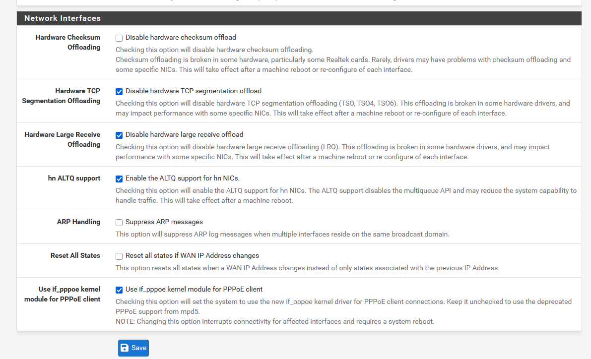

      loader.conf.local (you need to reboot after making changes)
      hw.vtnet.altq_disable=1
      hw.vtnet.tso_disable=1
      hw.vtnet.csum_disable=1
      LAN

          I kinda screwed up… I forgot to mention that this ix0 is part of a LAGG interface, and the LAN itself is using that LAGG. This shouldn’t really affect anything, but I’ll check if that’s the issue. Also, I don’t remember changing any settings for this NIC on the host, I think I left it as is.
          • w0wW Away
            w0w
            Configured LAN to use ix0 directly — nothing changed.

                          • w0wW Away
                            w0w @netblues
                            @netblues
                            Do you have the same settings?
                            2f15fa41-dcea-4151-8809-7f5bb87f2d90-image.png code_text
                            • N Offline
                              netblues @w0w
                              @w0w Sure. As I said, default installation with minimal setup, just to make the lan to nat over pppoe to the Internets.
                              w0wW 1 Reply Last reply Reply Quote 1
