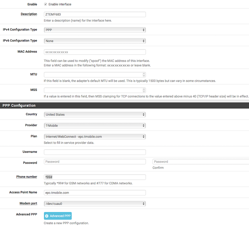

                            So I thought I'd try plugging the ZTE MF683 into my pfsense box to see if that works. Is there any sort of step-by-step guide to setting up a USB cellular modem on pfsense? The documentation page doesn't have anything regarding "cellular", "4G", "LTE", or even "modem" (except for the first link about cable modems).
                            I followed these instructions as far as I could, but I don't know how to populate the PPP Configuration:
                            I obviously know that I'm U.S. and T-Mobile, and when the ZTE MF683 was plugged into my CradlePoint box it showed epc.tmobile.com in the status, so I used that. I don't have a username or password, AFAIK, and the CradlePoint doesn't ask for one when I plug the modem into it; it just connects after ~30-45 seconds.
                            I have tried setting the Modem Port to both /dev/cuau0 and to /dev/cuau1, and the interface never comes up, either way. When I set it to cuau0 the pfsense System Log reports "MODEM: Fail to open serial port /dev/cuau0 on speed 115200". If I set it to cuau1 I get "CHAT: The modem is not responding to "AT" at ModemCmd: label." which sounds more promising, but it still doesn't connect.
                            Also, even though I click Apply Changes after setting the Country, Provider and Plan, they always come back up as unpopulated when I reload that screen.
