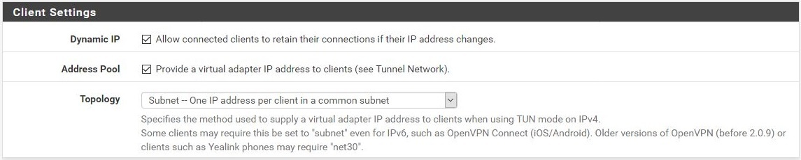

          • G
            Gershwin
            Thanks. Here are my pfSense OpenVPN Server settings. I looked very carefully to give not away any personal information. Please inform me if I have overlooked something.
            Thanks for the help.
            • J
              Tunnel network should be the network address of the subnet, not an IP address inside it. Change that to end in .0, so 10.8.0.0/24
              Do not Chat/PM for help!
              T 1 Reply Last reply Jul 17, 2021, 2:32 PM Reply Quote 1
              • G
                Gershwin
                @jimp:
                :-[ Thank you very much. The connection with the deamon is possible now and the error is gone. I never thought of this IP address… In basis, all the settings I recognized from my previous OpenVPN server I used in this setup. I learned that setting up an OpenVPN server is not that easy.
