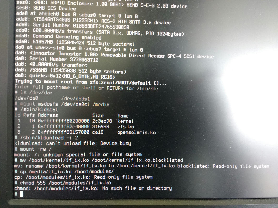

                                        Managed to get it working somehow.
                                        Anyhow, we have bought those appliances already for all the offices, sadly before checking if it's supported yet! :)
                                        I failed to find a proper way to disable existing module, so i just rename it and load a module manually compiled from Intel sources.
                                        After that don't forget to fix permissions chmod 555 /boot/kernel/if_ix.ko and u'r good to go. (reboot)
                                        So yeah, it works just fine after that, but don't survive upgrades as far as i understand pfsense updates kernel also, along with modules apparently.

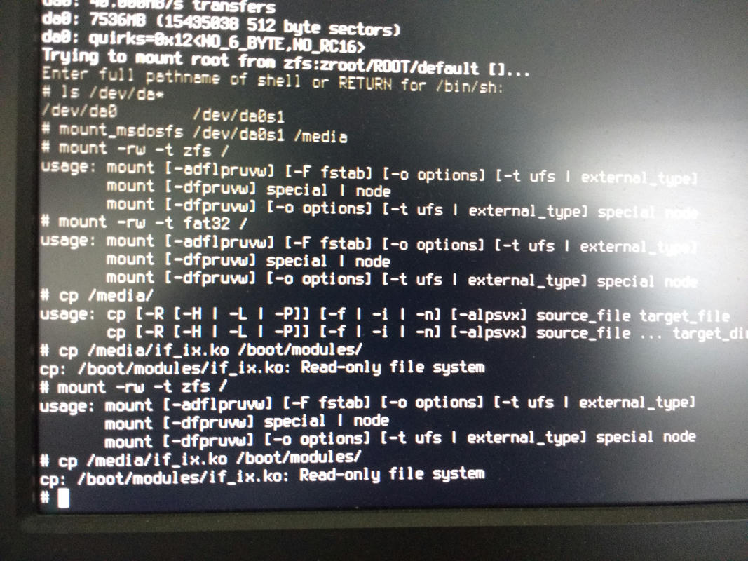

                                        Instructions:
                                        on 1st boot after install press any key on PFsense logo
                                        boot in Single User mode
                                        press enter for /bin/sh shell
                                        #connect your USB stick (Fat32 formatted) with driver
                                        #check what's it's name
                                        ls /dev/da*
                                        #mount usb
                                        mount_msdosfs /dev/da0s1 /media
                                        #unload existing if_ix module - check it's ID if necessary /sbin/kldstat )
                                        /sbin/kldunload -i 2
                                        #mount root as RW
                                        mount -rw /
                                        #rename existing if_ix.ko module
                                        mv /boot/kernel/if_ix.ko /boot/kernel/if_ix.ko.blacklisted
                                        #copy new module from USB
                                        cp /media/if_ix.ko /boot/modules/
                                        #fix permissions
                                        chmod 555 /boot/modules/if_ix.ko
                                        #make loader.conf.local
                                        echo 'if_ix_load="YES"' >> /boot/loader.conf.local
                                        #enjoy
                                        reboot

                                          @MarvinFS:
                                          Instructions:
