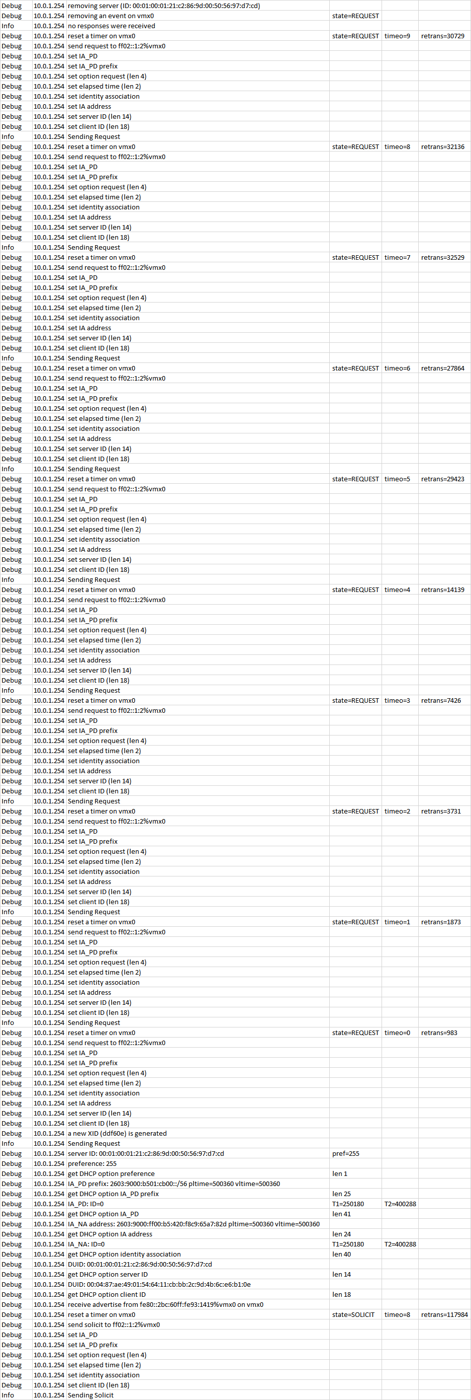

      Getting this in DHCP log on bootup:
      Jan 24 10:00:48 dhcp6c 28299 Sending Solicit
      Jan 24 10:00:44 dhcp6c 28299 Sending Solicit
      Jan 24 10:00:42 dhcp6c 28299 Sending Solicit
      Jan 24 10:00:41 dhcp6c 28299 Sending Solicit
      Jan 24 10:00:40 dhcp6c 27988 skip opening control port
      Jan 24 10:00:40 dhcp6c 27988 failed initialize control message authentication
      Jan 24 10:00:40 dhcp6c 27988 failed to open /usr/local/etc/dhcp6cctlkey: No such file or directory

        Noticed in the logs when I boot up, I'm getting the following every two minutes but then it stops after a while:
        dhcp6c 27601 Sending Solicit
        I assume this is pfsense asking for a prefix delegation from dhcp6?
        If anyone has any thoughts would love to hear it.  ISP has been trying to work with me - they even rebuilt the ipv6 settings for my local switch which seemed to get me an address for a couple minutes, but then disappeared.

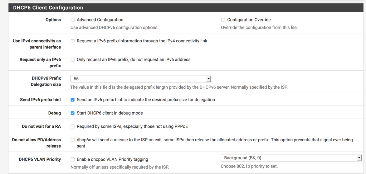

                @derelict Yes its strange, I have DHCP6 setup on WAN, I was not asking for an IP just PD, which has been working. I have 2 LAN nic's on 2 separate Vlan,s so one PD is 0 the other was dd.
                One morning My gig network was down, switch was hosed so I rebooted the switch. Now I can no longer get any ipv6 info. to the Interfaces.

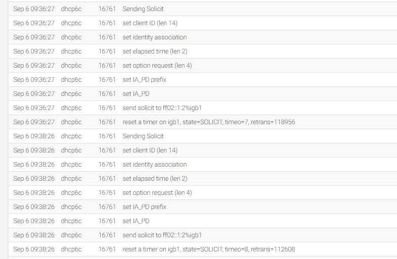

                But if I look in the DHCP logs I see a PD being assigned I can see a WAN IP assigned. but they never make it to my Interfaces.
                Snippet from the Logs:
                Sep 2 15:45:24 dhcp6c 48184 IA_NA address: 2603:9000:ff00:b5:1da7:7fff:a000:b95a pltime=604706 vltime=604706
                Sep 2 15:45:24 dhcp6c 48184 get DHCP option IA_PD, len 41
                Sep 2 15:45:24 dhcp6c 48184 IA_PD: ID=0, T1=302353, T2=483764
                Sep 2 15:45:24 dhcp6c 48184 get DHCP option IA_PD prefix, len 25
                Sep 2 15:45:24 dhcp6c 48184 IA_PD prefix: 2603:9000:b591:7800::/56 pltime=604706 vltime=604706
                so my Request for PD is being answered but Track interface never gets an assigned Prefix.
                also FYI I wiped my config back to Factory, just as a test, setup WAN and LAN and it still does not work.
                If I hook laptop directly to the Modem I get WAN ipv6 address.
                so something is hosed with Tracking on the interfaces. or my DUID is banned, (but I changed it) I also changed my wan MAC address and get a new ipv4 address now.
                but no Ipv6 makes it to the interface.
                What would you need to see my issue more clearly.
