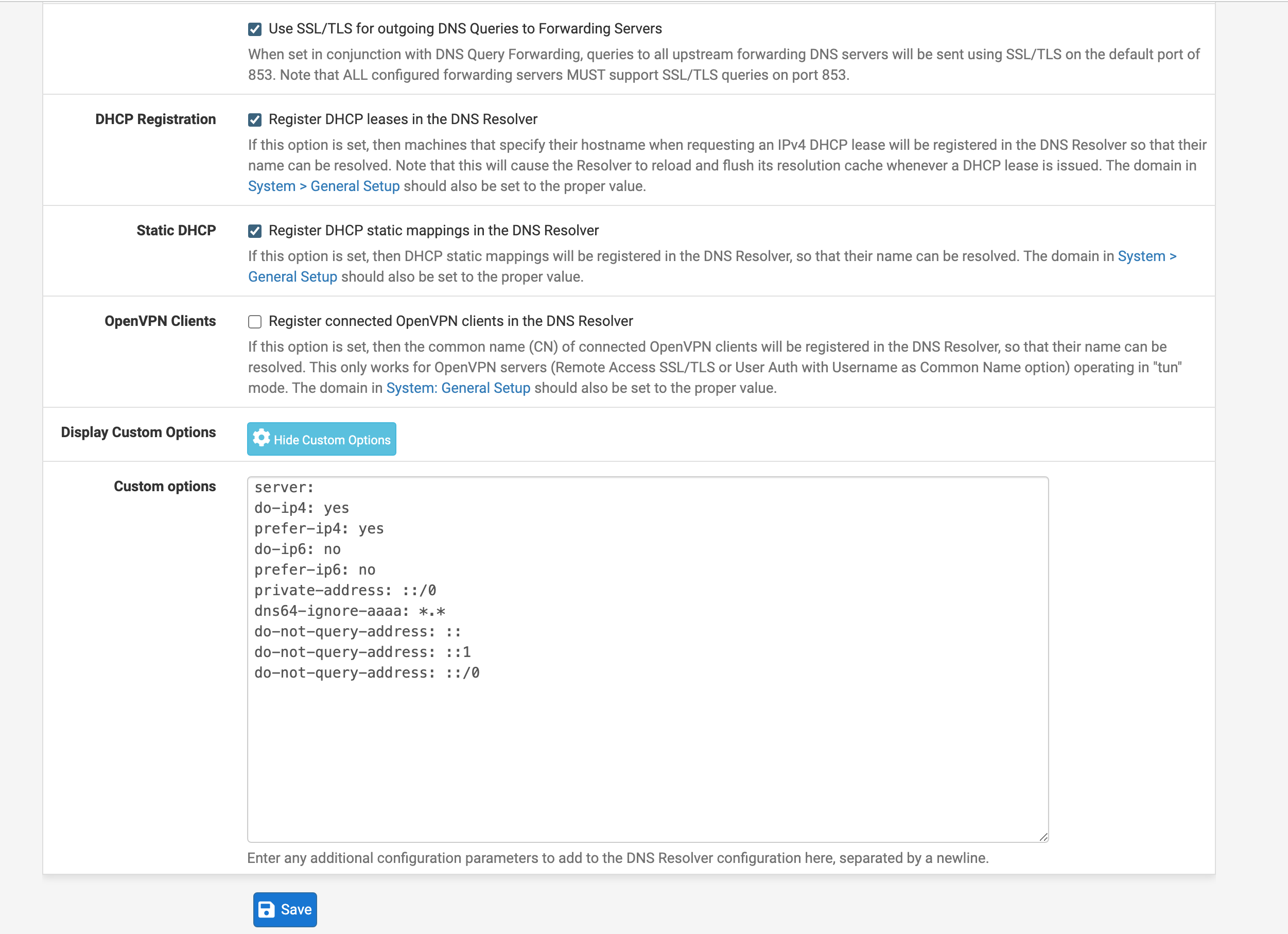

                                        • JonathanLeeJ
                                          JonathanLee
                                          If you are not using IPv6 try to disable AAAA access.
                                          Services/DNS Resolver/General Settings
                                          Under custom
                                          server:
                                          do-ip4: yes
                                          prefer-ip4: yes
                                          do-ip6: no
                                          prefer-ip6: no
                                          private-address: ::/0
                                          dns64-ignore-aaaa: *.*
                                          do-not-query-address: ::
                                          do-not-query-address: ::1
                                          do-not-query-address: ::/0
