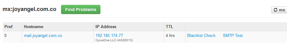

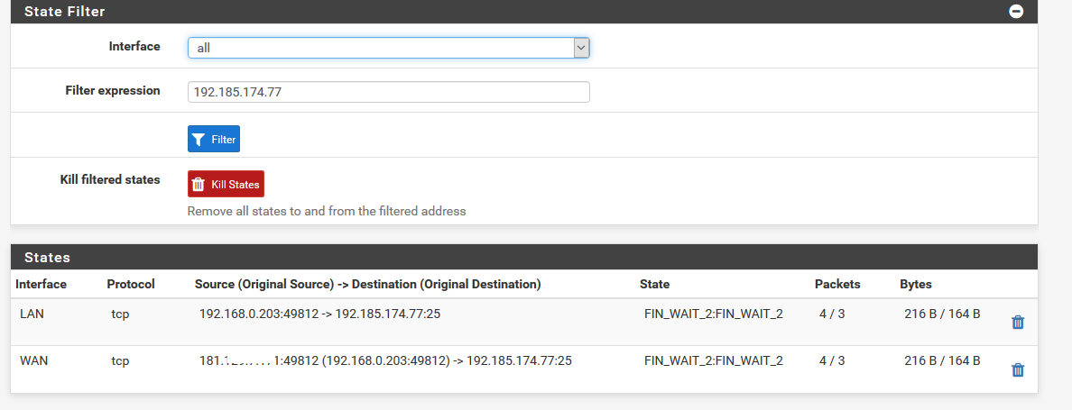

      I was wondering if someone can assit me with this issue. Currently have pfSense 2.3.2 running good, i also have an email server running postfix. Whats odd some emails go though with no issue and sometimes im getting that lost connection. I thought it was a postfix issue so i need a clean install same issue. Now i have to believe its a network issue. then i check the states i see that postfix does go out with port 25 and i see a fin/wait 1_1527308727636_Clipboarder.2018.05.25-004.png 0_1527308727636_Clipboarder.2018.05.25-003.png
      Also whats odd if i telnet 192.185.174.77 25 i get this

            Thanks for the reply, but after hours and hours or going nuts. Then i telnet the server with another IP and i was getting the 220 so i realized that provider was greylisting me for some odd reason i sent them an email hopefully to unlist me. I figured out that i was not getting the 220 so i knew something was wrong
            Thank you again ill post back an update
