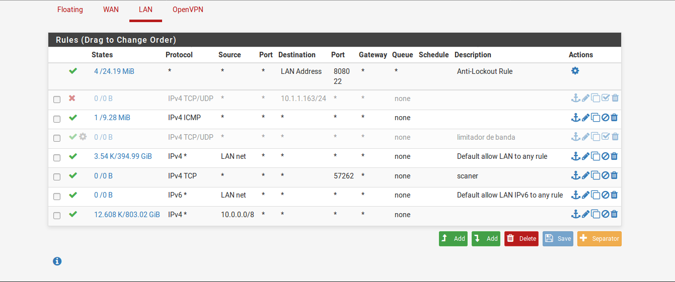

                                    Here is my Lan Rules

                                      so you have downstream networks? Why do you have that 10/8 rule? And your icmp rule is any for source network would be pointless unless you have downstream networks.
                                      And really is pointless anyway since you have 10/8 rule - unless you have other networks other than 10/8?
                                      So if your client is on lan net or in 10/8 your rules are any any and should have no issues doing passive ftp to server outside.
                                      Did you mess with outbound nat? Your using lan net as your transit to these downstream networks? Maybe you have a asymmetrical routing problem... Please draw up your network and where are you clients in your network that your trying to ftp with. Do they use pfsense as their gateway?
                                      Your not routing any traffic through a vpn are you?
                                      Do you have any rules in your floating tab?
                                      BTW your scanner rule is pointless unless some downstream client is not in lan net or 10/8
                                      D 1 Reply Last reply Jun 6, 2018, 5:55 PM Reply Quote 0
                                      • D
                                        doguibnu @johnpoz

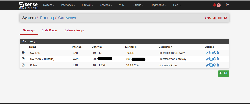

                                        @johnpoz said in Pfsense Block access external Public FTP:
                                        hello
                                        We have 43 networks point route inside pfsense:
                                        For exemple:
                                        10.10.11.254
                                        10.10.34.254
                                        10.10.29.254
                                        10.10.30.254
                                        the internet is provide by:
                                        concentrator Internet MPLS
                                        Dedicated Internet
                                        Yes, we are using lan net to transit on these downstream

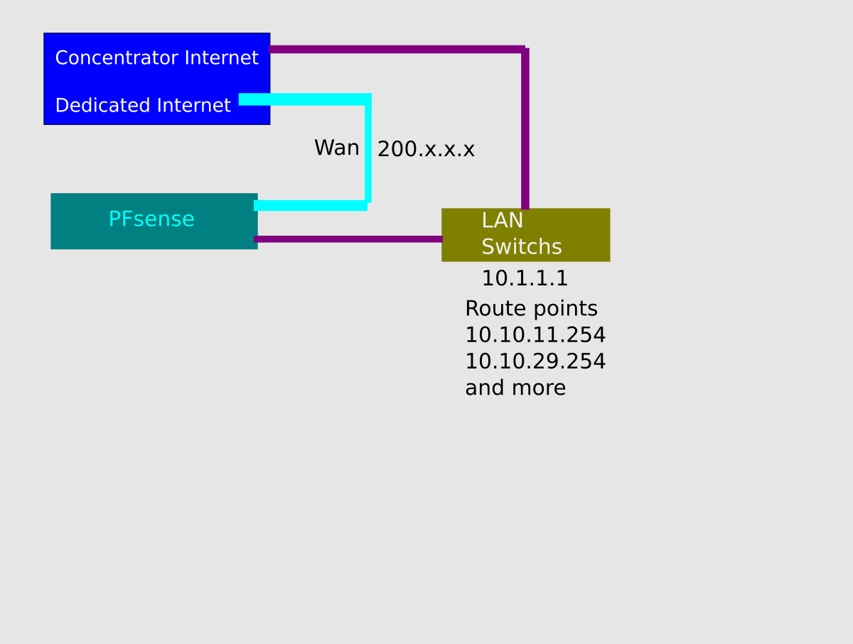

                                        Yes, they are using pfsense for gateway. Each sector have modem (or circuit point) route to pfsense
                                        We have some users access vpn through our pfsense because we have a NAS.
                                        No, there are not rule floating tab.
                                        Thanks for now
                                        • J
                                          @doguibnu said in Pfsense Block access external Public FTP:
                                          So there are client in lan net.. Do you have host routing on them, if not then your asymmetrical if they are talking to any downstream network.
                                          So if client in lan wants to talk to 10.x network he sends traffic to his gateway pfsense in the lan net. Pfsense then sends the traffic to some downstream router, the return traffic will not go to pfsense.
                                          Please DRAW your network, and what what is your outbound nat rules. Is lan net also a 10.x address?
                                          And again please post a LOG of filezilla client behind pfsense failing to connect... So we can see what gets sent in the passive command.
                                          D 1 Reply Last reply Jun 6, 2018, 7:58 PM Reply Quote 0
