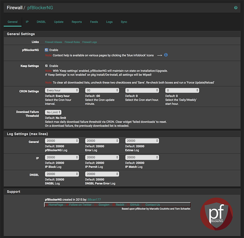

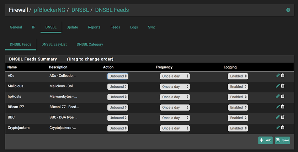

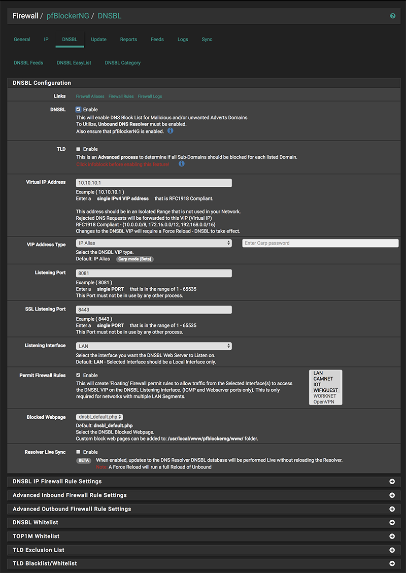

      I have recently switched from Squid/Squidgrard to pfblockerNG. Since that switch I have been having issues with long "resolving host..." times, inability to find sites, and complete internet access blockage (even on subnets not monitored by pfblockerNG). Before, this resolving was instantaneous (at least to the human eye). I am running pfBlockerNG-devel 2.2.1.
      I have had the TLD feature enabled up until disabling it today, I'll see if this changes anything. With this enabled, my memory utilization was only 47% fyi.
      Pics of my settings are below, I can post up log files but I am not sure which one would be apropos, just let me know.
      Any ideas where / what to start with?
      0_1528905584529_Screen Shot 2018-06-12 at 6.41.04 AM.png 0_1528905595948_Screen Shot 2018-06-12 at 8.07.46 AM.png

          If you are on a Multi-Segmented LAN (ie: VLANS), you will need to enable the "DNSBL Permit rule" option which will allow your VLANs to access the DNSBL VIP.
          You should be able to ping and browse to the DNSBL VIP from all VLAN subnets.

            AR15USR
            I do have it enabled, see screen pic above “Permit firewall rules”, unless you are referring to something else?
            The problem though was happening on the LAN. After unchecking the “TLD” feature it got better, but still happens. Never happened before installing pfblockerNG devel.
            2.6.0-RELEASE
            • BBcan177B Offline
              BBcan177 Moderator
              Timeouts typically only occur when the LAN/VLANs cannot access the DNSBL VIP. When a request is HTTP, the Lighttpd DNSBL webserver sends a 1x1 pixel back to the browser to terminate the connection. For HTTPS blocked domains, the browser will terminate as soon as it sees that the DNSBL Cert is invalid and should drop the connection without delay.
              Can you ping and browse to the DNSBL VIP?

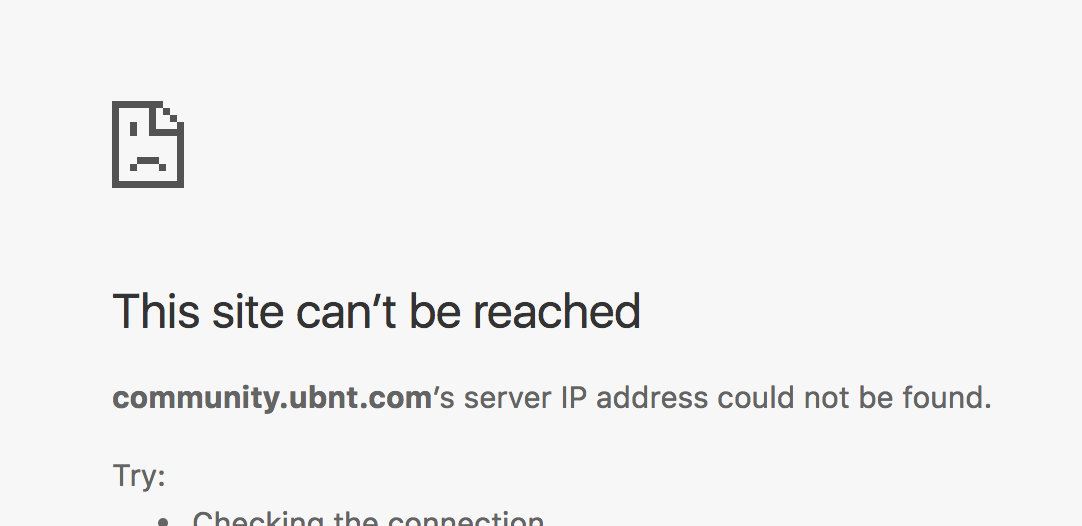

                Here is an example of how it happens from the user point of view if it helps:
                You enter a URL in the browser (Chrome). You see "resolving host..." in the status bar at the bottom, this happens for a minute or so, sometimes faster. Then you get the "This site cant be reached" error. If you type the URL in the browser again it will then resolve and find the site right away. Sometimes you need to enter it a couple times to resolve correctly.

                        @BBcan177 Its not necessarily a matter of not being able to access the site or it being blocked. What happens is there is a long pause, the browser says "Resolving host..." then 1 of 2 things happens:
                        1. The site eventually resolves and you land at the requested url. But the wait time is several seconds to ~30 seconds.
                        2. The site resolving eventually times out and you get the "This site can't be reached..." notice above.
                        When #2 happens you can reload the url 1 or more times and you eventually get to the site. You never get to the VIP/Block page because the site is not blocked, it does not show in the reports.
                        With pfBlockerNG disabled browsing is lightning fast and I never get the "Resolving host..." delay above.
