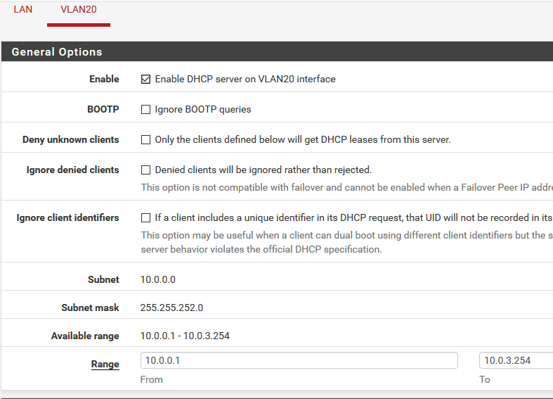

      Looking for some help on configuring a VLAN, I believe I'm setting everything up right but, I'm not getting DHCP. I have disabled the DHCP server on the LAN interface and enabled DHCP on the VLAN, but when I plug directly in, I'm still not getting DHCP. Below are some screenshots of my configuration, any help is greatly appreciated!

        That all looks good. Whatever you connect to igb2 has to be tagged VLAN 20. After that any access port on the switch that is on VLAN 20 should get DHCP.
