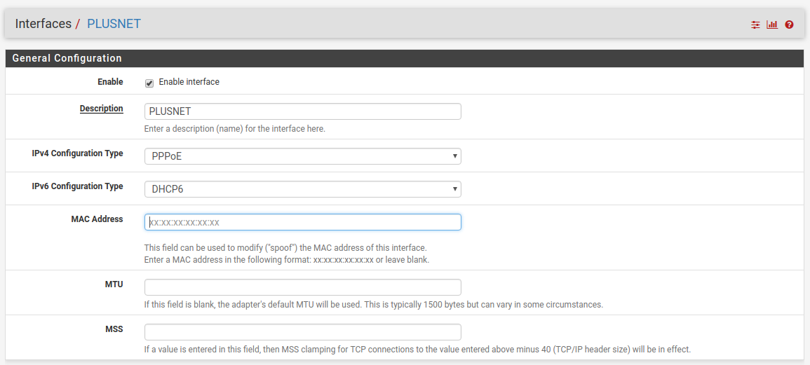

              Interesting though, I see the MAC spoof option here on PPPoE interfaces in 2.4.3p1:
