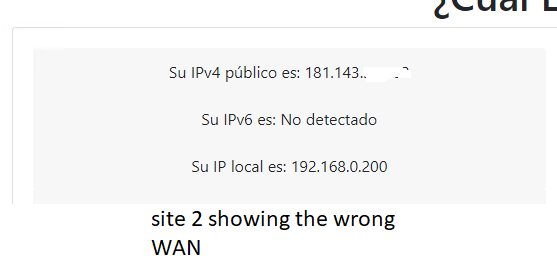

      I was wondering if someone else has had this issue before, as a month had the issue but thought because the versions were different, as this week both pfSense box have the same version 2.3.5 and at first was working great. But then there was a power outage, and for some odd reason site 2 is getting the WAN IP of site 1 which does not make sense. In theory Site 1 should keep its own WAN IP and Site 2 also keeps its own WAN IP.

          Thanks for the reply, only seeing that switched IP on Site 2 which is grabbing the WAN of Site 1, i go on a computer on Site 2 and put myIP on google and i see the IP WAN of Site 1 which i have no idea why.

                  Regardless it is impossible to egress to the internet from another IP address. You simply have to be tunneling across and out the other WAN.
                  Please post your routing table. Diagnostics > Command Prompt then execute:

                      It's hard to see since both sites are 181.143 and you have covered over the 3 octet in the screenshot showing the wrong WAN.
                      But assuming that shows 181.143.5 then that traffic MUST be going over to the other site. If it was not there is no way you would get any connectivity at all.
                      Perhaps you have another VPN setup. IPSec? OR maybe a remote access VPN on that client directly?

                        @stephenw10 Well you wont believe what it was, it was the WPAD, as site 1 has wpad i also have the proxy auto detect on site 2 i disable the auto detect and bam showing the real WAN ip for the websites. i guess no i have to see how i can disable that.
