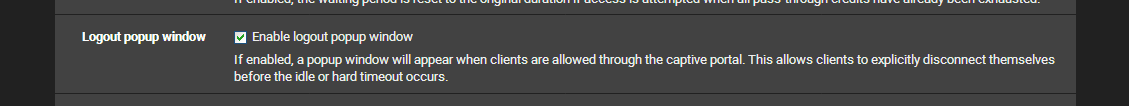

                        @gertjan Thanks I read the documentation and things works as expected now. But is there any link or url that i can type to logout manually in CP?
                          Gertjan @alexcheddar
                          @alexcheddar said in Exclude some clients in LAN captive portal:
                          As you can see on the settings page, there is a logout page. Also mentioned is the that this page is a popup :
                          The link to this page, as shown in the navigator bar, is the logout URL.
                          Now the fun part.
                          You will probably find out that you didn't saw any popup when logging in. You'd say : it doesn't work.
                          Now it 's time that that you recall that you, and everybody else on the planet have blocked popups in your navigator. You could enable your popups again, but your portal visitor won't.
                          You could show the link on the portal login page, and mention on that page that people should copy it on a safe place (making a favorite link of it ?) but most visitors probably won't.
