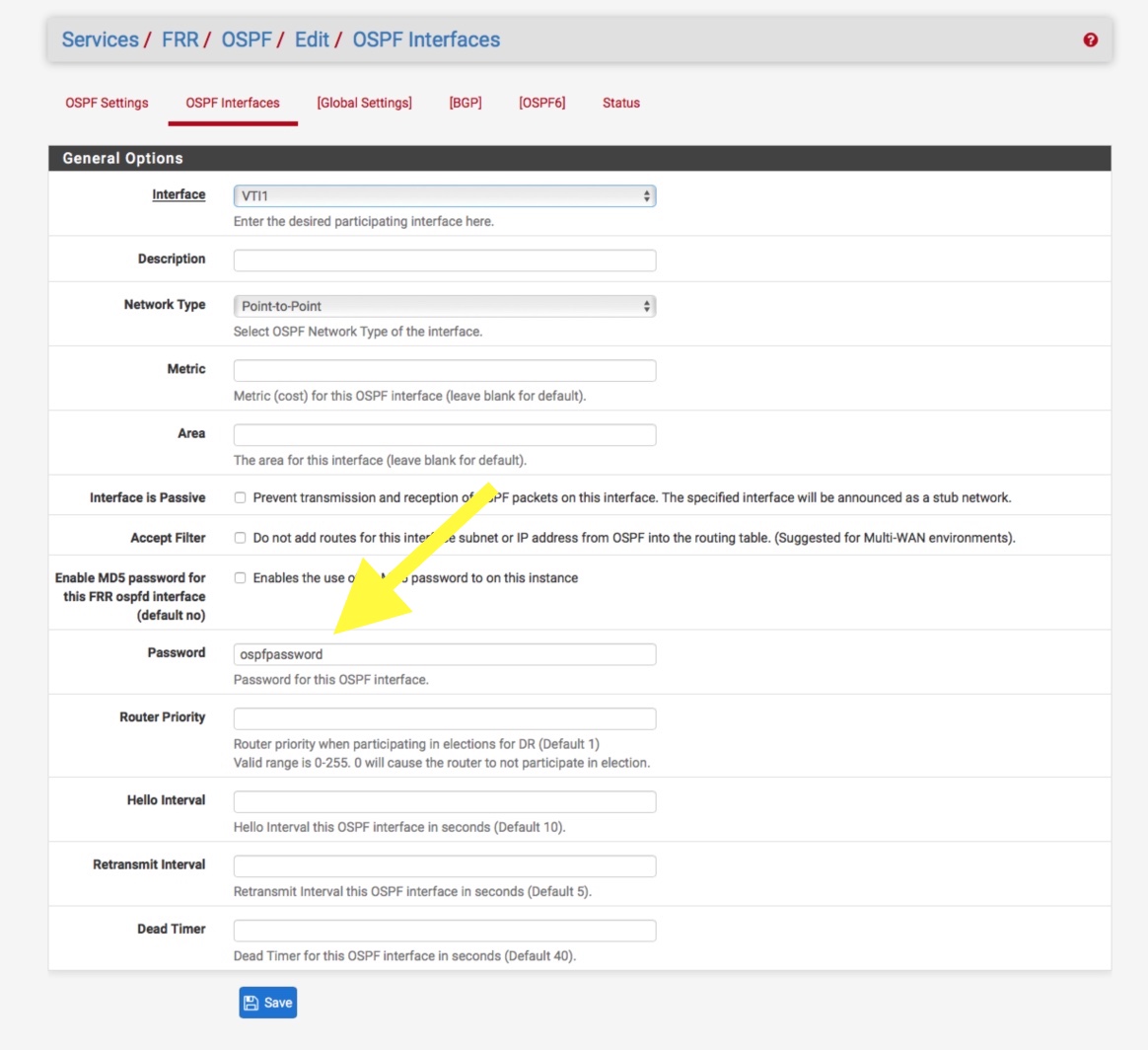

      Not exactly sure where to post this, been having a play with 2.4.4.a.20180716.1125 and OSPF.

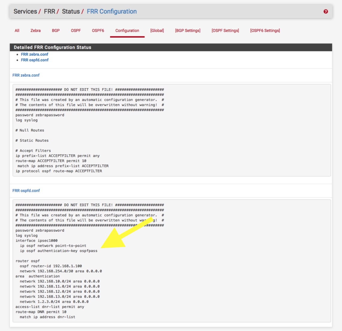

      Noticed that the OSPF cleartext password isn't in the OSPF packets and also its being truncated in the config untill you enable MD5.
      Also the interface used the OPT# rather than the renamed VTI# interface name.

        @nogbadthebad said in 2.4.4.a.20180716.1125 & frr 0.2_2 issues:
        The OSPF "password" is limited to 8 chars: http://docs.frrouting.org/en/latest/ospfd.html#clicmd-ipospfauthentication-keyAUTH_KEY -- The backend imposes this limit. I'm not sure why it wouldn't be showing in the packets, but the config looks right, so if it's missing it may be an FRR bug.

          @jimp said in 2.4.4.a.20180716.1125 & frr 0.2_2 issues:
          That's a side effect of how the pkg edit interfac
          Many thanks Jim, think I'll pop in a redmine re the length of the password string, to either check the length before saving or mention in the text there is a length limit.
