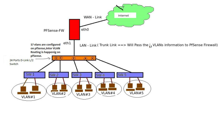

          @johnpoz In my 'admin' vlan the server is residing. It's another vlan like other 18 vlans.From other vlan's I want to access the server . I am using TCP/UDP as protocol from all the vlan's.Since my server is in the 'admin' vlan, I am able to access the server from the 'admin' vlan easily. But from the other vlan I am not able to access. And about the host, the firewall is off. I am getting the ping reply from the server, seating in the same vlan.And the server is included in the alliased.I am submiting my LAN diagram also.Waiting for your help.
          0_1531940461463_alliases.png ![0_1531940510190_NSEC LAN Diagram (1).jpg](/assets/uploads/files/1531940502067-nsec-lan-diagram-1-resized.jpg0_1531940538064_NSEC LAN Diagram (1).jpg )

            So what vlan is this server in? Which vlan from this drawing 1, 2, 3, 4, 5 ? Where are you trying to access it from on what port? What is the source and destination IPs?

              My server is in 1st vlan and the vlan name is 'admin'. Admin vlan network is"172.16.65.0' and the server ip is 172.16.65.245
