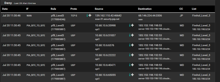

      I have no business running pfsense but I do anyway. I have a site to site vpn running with private internet access. I am using pfblocker and all sorts of blocklists including firehol.
      Here is a screenshot of my alerts page for pfblocker. See all those calls after the first one?
      The destination server doesn't seem all that threatening even though its on a block list. Still, whats it doing there? The source is always pfsense itself and the port numbers are always different between calls.
      If I disconnect the site to site vpn these calls stop happening
      It's only now occuring to me that bad actors could be looking at my network due to the vpn connection.
      Lotsa questions for the patient among you:
      • Why does my router appear to be trying to call this site?
      • Is the site to site vpn the real source of these calls?
      • Is there a firewall rule I could add that says, packets cannot come in from the site to site vpn unless they are responses to packets that I already sent out?
      • Is there some other way to make a site to site vpn of this sort safer than Im starting to think it is?
      Thanks
      0_1532108592080_21adee09-ce6f-4cf4-9e39-9462b27f0caa-image.png ![alt text](image url)
      • johnpozJ
        UDP to 53 is default port for DNS.. That could be a NS for any sort of domain that your doing queries on.. Out of the box pfsense resolves and could be trying to talk to authoritative ns for some domain.
        I would sniff to see what the dns query is for..

          I just came over here with the exact same setup and issue. I'm wondering if this is more related to PIA than anything else. I originally thought it was malware/botnet related on my internal network, so I'm glad that someone else is having the same issue.
          Here's my logs for reference: Screenshot
