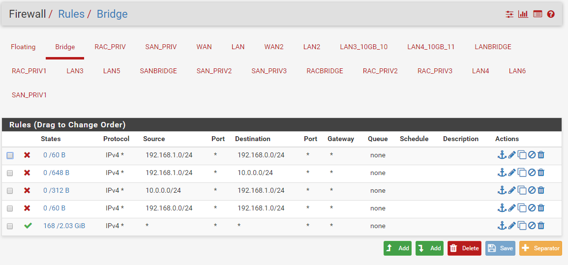

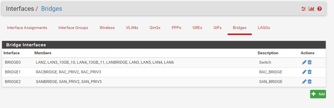

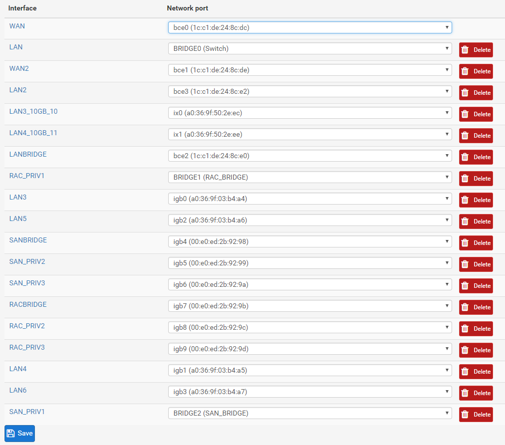

                this is the config that I'm using right now..
                5_1532266159350_pfsense config 6.PNG 4_1532266159349_pfsense config 5.PNG 3_1532266159349_pfsense config 4.PNG 2_1532266159349_pfsense config 3.PNG 1_1532266159349_pfsense config 2.PNG 0_1532266159349_pfsense config 1.PNG

                  the other bridge that I created (SANBRIDGE) was only to test... to see if I connect SAN with a private port to RAC servers
                  • johnpozJ
                    Let me know when you have a drawing, and a description of what exactly your trying to accomplish. Other than seeing that box has a shitton of interfaces.. And what looks like stuff connected to switch.. Break out your layer 2 networks.
                    Yours don't seem to make any sense because you have sources of different networks.. Do you have downstream networks routed to your bridge interface? Are you running multiple layer 3 on the same layer 2?
                    So far it looks like a complete mess.. If anything can talk to anything it would be anyones guess what path its taking. I can make out 3 L3 networks 192.168.0, .1/24 and 10.0.0/24
                    If you want to leverage all those your interfaces to create your layer2 networks then do so.. But from from your rules looks like you have rules to networks that would never been seen on that layer 2..
                    For example on your bridge you have all 3 different layer 3 networks blocked from talking to each other.. Which specific layer 3 is on this L2 network (bridge)?
                    From this mess it looks like your trying to run these 3 different layer 3 networks on the same layer 2 and then blocking what exactly??
                    When you say public IP - do you really mean rfc1918 (one of the 3 you list?) that is on the same layer 2 as your lan - or is routed to your lan cloud you list?

                      • johnpozJ
                        So create a bridge with the ones you have circled. Create another bridge with the purple interfaces, create another with your red.
                        Now connect the devices you want on those networks to those ports.

                            Well that is NOT what you did on you rules..
