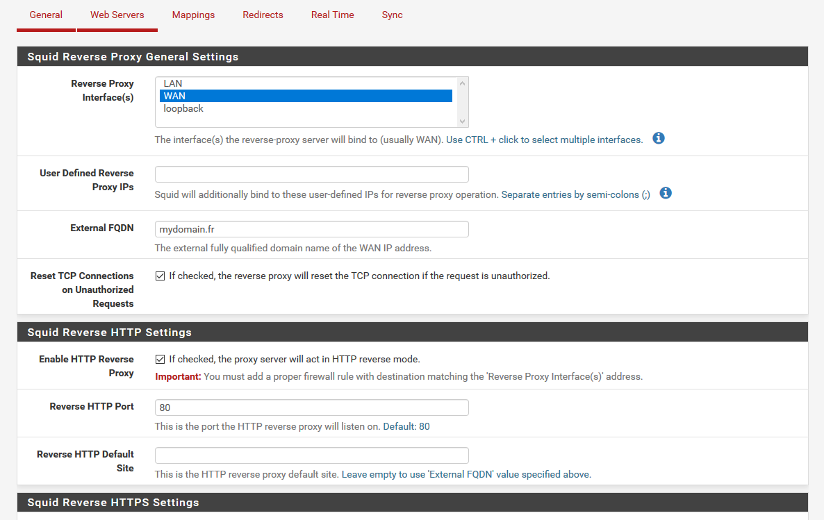

      Then i have installed squid package on my pfsense and configure it like this:

      Maybe i made a mistake on my dns server configuration, am i supposed to enter anything else ? Or in the pfsense configuration, did i well entered well the "external FQDN" as requested ?

        I solved the problem myself.
        All my configuration was correct, there is a bug with the squid addon: you can not start the squid service from the web interface, when you click on "start the service" in the image below nothing happens, the service doesn't start and you don't have any error message:
        I had to connect to the pfsense terminal and run a "ps aux |grep squid" to see that th service was not running (i didn't have any error message in /var/log/squid).
        A simple "squid start" solves the problem, does someont knows where can i report this bug ?
