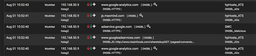

      How is it that I am seeing DNSBL blocks on an interface that is purposefully not selected to be monitored in the pfBlockerNG config?
      I do not have the "worknet" interface selected in the configuration, see pic:
      As you can see here it is showing blocks on that interface:
      2.6.0-RELEASE

          Kinda not making sense. I have not selected the interface in the config section, so nothing on that interface should be able to reach the DNSBL VIP. There is also no automatic "pfB_PRI1_v4" rule on that interface so nothing should get rejected, no?

                      A traceroute to yahoo.com results as expected. A traceroute to e.crashlytics.com traces to 10.10.10.1 meaning it is getting blocked.
                      There is no auto generated rule on this interface in the firewall rules fyi. I can post a screenshot of the floating rules if you like, let me know.
