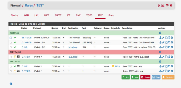

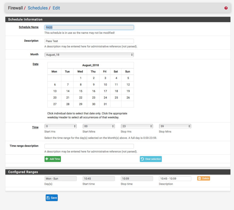

                      The following works for me:-
                      Post your firewall rules.
                      Andy
