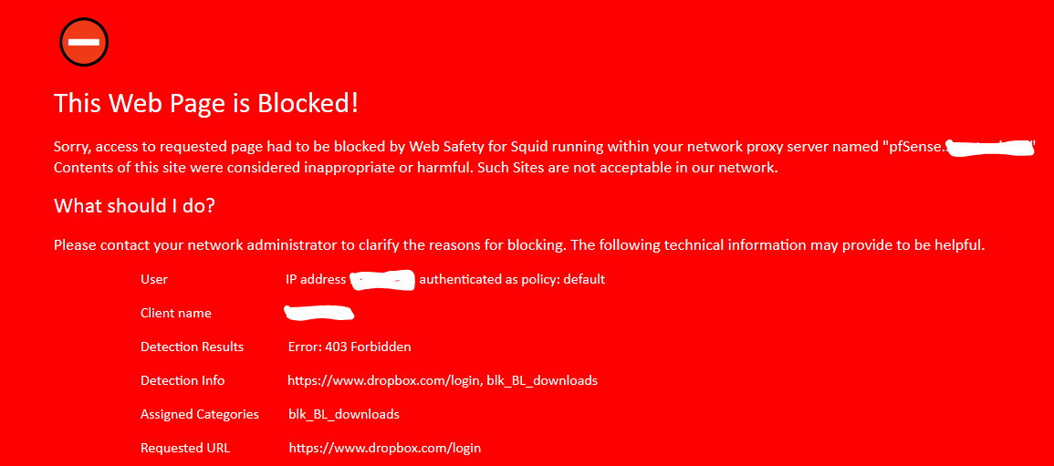

      I have squid and squid guard set up and everything is working as it should be but when I go to a blocked site such as Dropbox I recieve a squid error for "Unable to determine IP address from host name "http"" (See below)0_1533571211353_pfsense Squid Blocked Page.png
      instead of my own custom blocked screen which I have created under SquidGuard so it would redirect if the website is blocked.
      Is there a way where I can have the blocked page always be the custom page which I created?

              It shows the squid block page for mostly all of the blocked sites but only shows the squidguard block page for example:
              dropbox.com
              dropbox.com/login
              This also vary's from browser to browser on IE the top error comes up all the time and on Firefox both appear

                  So I have created another pfSense machine so I can do testing and it seems that the reason I am getting the top error is because I have the "Enable SSL filtering" on.
                  Am I missing something elsewhere as this option is enabled?

                    Try setting the redirect mode in Squidguard to ext url move. You will have to redirect to something, you might create a page for that.
                    I hit that same error recently and that worked around it.
