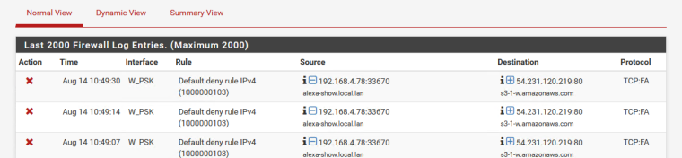

                      Well that did not take long - but these are FA..
                      That is my show.. Trying to close session. Now that "could" be duplicated because of wifi?? But I doubt it - or more like just misconfigured application/service. Hey I didn't get my answer to my FA.. So going to send it again..
                      If you look at time stamps - its looks like retrans on the FA, see how the timestamps back off in time between..
