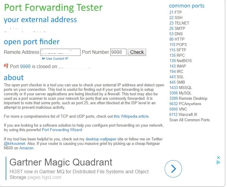

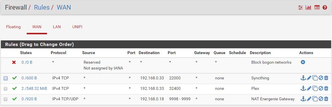

      1, I am unable to forward 3 ports (22000,9998 & 9999)
      2, Port 32400 forwards 90% of the time
      No matter what I do, I cannot open 22000,9998 & 9999 I have tried several port checkers that always tell me the port I check is closed, I also have 32400 open for Plex, although this one works I get notifications once a day from Plex telling me that the remote connection is down and sure enough if I check with an online port checker port 32400 is closed, it always comes back on it's own (could be anything up to 20 minutes) and again I check with an online port checker and it is open again. Am I missing something? I have followed the guide but cannot open the other 3 ports mentioned at all!

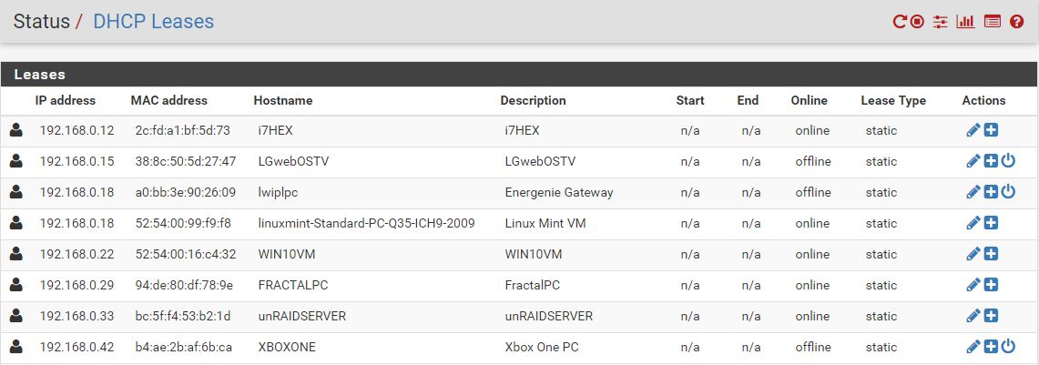

      I am also noticing that the device I am trying to port forward for (Energenie Gateway) is always showing as offline (192.168.0.15) although I can ping the device with no problems

                Sorry for my previous comment it was out of frustration! as I had read and re-read the troubleshooting guide and I eventually found the issue to be due to duplicate IP's in the NAT, no idea how it was possible but after deleting all my entries and starting again it is all working... Thank you
