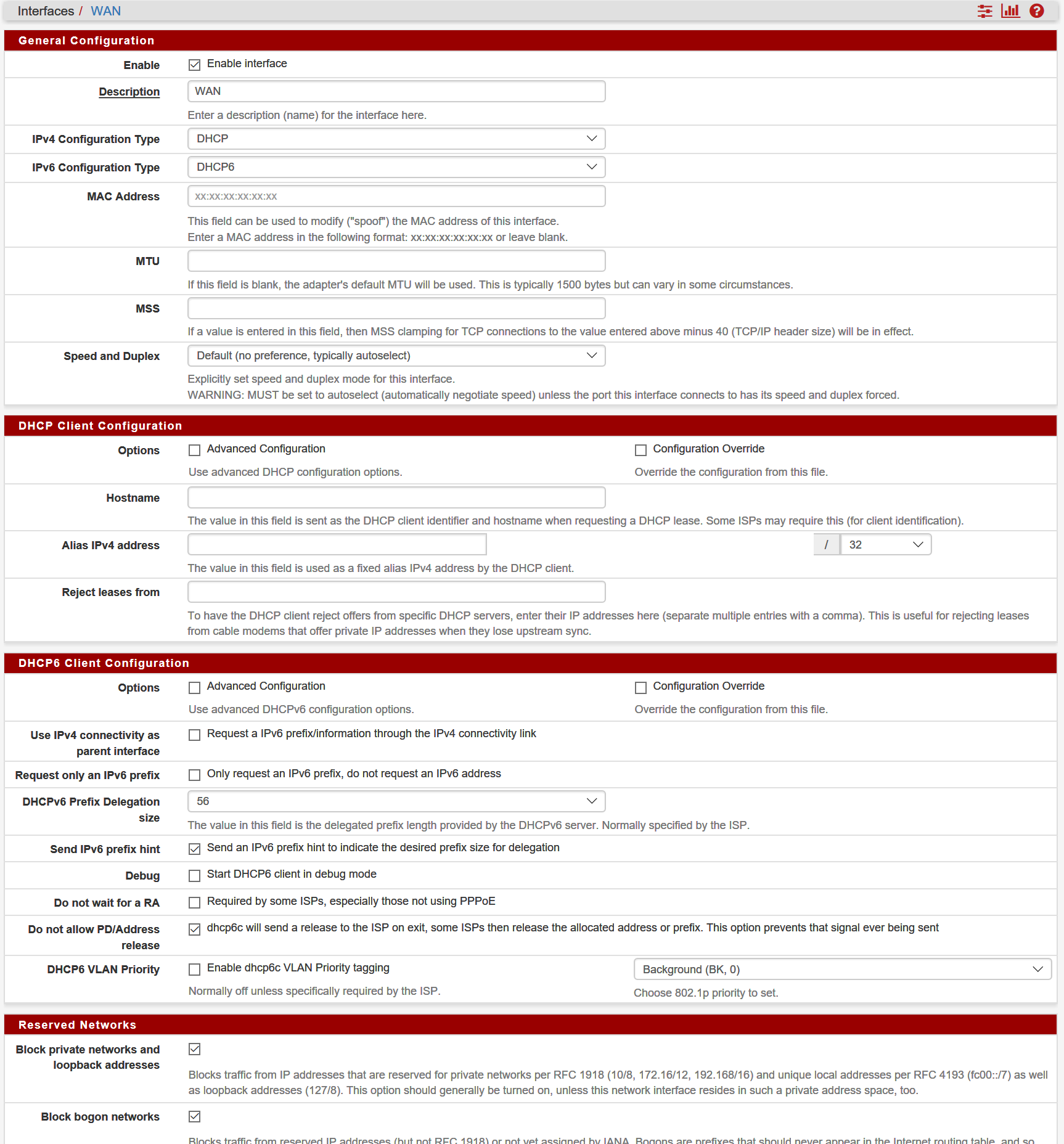

      I'm a Comcast business customer, I have a static /30 for IPv4 and a /56 for ipv6. Config looks like:
      *** Welcome to pfSense 2.4.3-RELEASE-p1 (amd64) on pfSense ***
      WAN (wan) -> igb0 -> v4: xx.xx.17.177/30
      v6/DHCP6: xxxx:xxxx:xx:c000:21b:21ff:fe74:6ba4/64
      LAN (lan) -> igb1 -> v4: 172.16.0.254/16
      v6: xxxx:xxxx:xx:c0ff::254/64
      I have a cisco switch with IP services running on the LAN. All VLANs are assigned 172.16.x.x/24 and xxxx:xxxx:xx:c0xx::254/64. IPv4 works like a champ. From the Cisco switch, I can ping ipv6 to both the WAN and LAN interfaces on the Pfsense box, but cannot ping ipv6 past that. Can anyone see anything obvious?

                                    @isaacfl
                                    I've only ever been able to use Comcast via DHCP6 on WAN. SLAAC does not get me an address. Also, other than the fact that I don't have an OPT interface. I'm basically configured like you typed up.
                                    What I'm told by Comcast is that I HAVE to use DHCP6 on my WAN interface. I, WITH MUCH EXASPERATION, mentioned to them that I wanted static not DHCP for IPv6. They said that even though I was using DHCP, the subnet and address assigned to my WAN interface would not change. Apparently they assign the address to me but deliver it via DCHP6.
                                    For IPv4 this is all working great. I don't understand why there are issues with IPv6. Clearly there's something beyond my grasp.

                                      @johnnybinator said in Cannot route IPv6 - Frustrated:
                                      @isaacfl
                                      Ok, I think you have dynamic. This is not "static" but it is unchanging, as long as your DUID doesn't change. So with pfsense as long as you don't rebuild the router it will stay the same.
                                      It is part of one of the ipv6 recommended standards that as long as you use the same DUID and you aren't offline for extended period of time then the ISP will give the same prefix (/56 in your case). With pfsense the DUID is created and stored during install and as long as you don't manually change it, it won't change.
                                      With ipv6 there are 2 parts to dhcp. One is what you are probably familiar with that just gets an ip address to use on an interface. The other part is a request for a prefix that you can then use to assign downstream.
                                      Here is my Interface WAN setup:
                                      Here is my LAN interface. Note it is track interface and I picked 10 for this subnet from my pool of 00-ff.
                                      My OPT1 is the same except IPv6 prefix ID is 20. Again arbitrary pick on my part.
                                      IsaacFLI J 2 Replies Last reply Reply Quote 0
