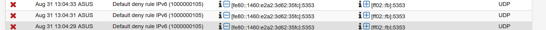

      I believe there needs to be a firewall rule added to pass ipv6/UDP traffic from Link Local Addresses (fe80::) to Multicast (ff02::) for Avahi to function on ipv6.
      With default setup (no firewall rule) I see in the firewall log:
      If I create a firewall to pass the above traffic, which is blocked by default, and watch on the interface using Wireshark, I see devices sending the multicast going out, and I see the pfsense router responding using its Global ipv6 address with a DNS response, as it should.
      Without my added firewall rule, the pfsense router does not respond on ipv6, and the device has to use ipv4 to get a DNS response.
      So I think in the Avahi package there is a firewall rule missing to allow Link Local Addresses into the Avahi demon.
      Also observation, that all mDNS traffic on ipv6 uses only Link Local Addresses Source address. They never use their global ipv6 address. However, pfsense, always responds using its global address instead of it's link local address.
