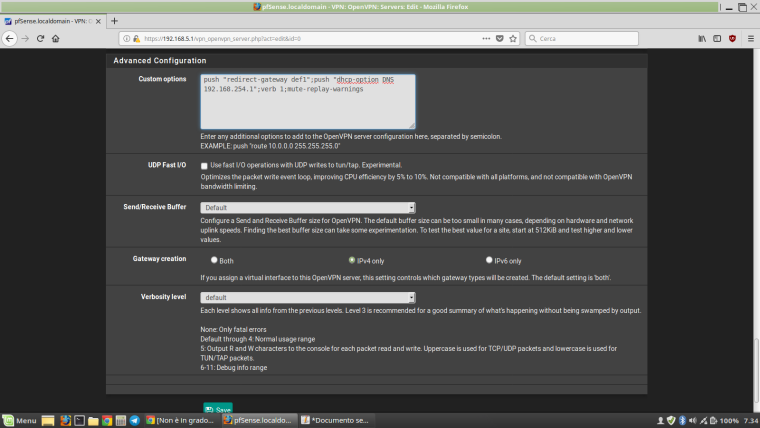

                  claudio69
                  Hello, I have a network configuration similar to yours. I had the same problem that I could not surf the internet when I was connected to my wifi with the vpn. I solved this problem with this custom option:
                  push "redirect-gateway def1";push "dhcp-option DNS 192.168.254.1";verb 1;mute-replay-warnings
                  The IP address (192.168.254.1) is my vpn tunnel network, this may be different in your configuration.
