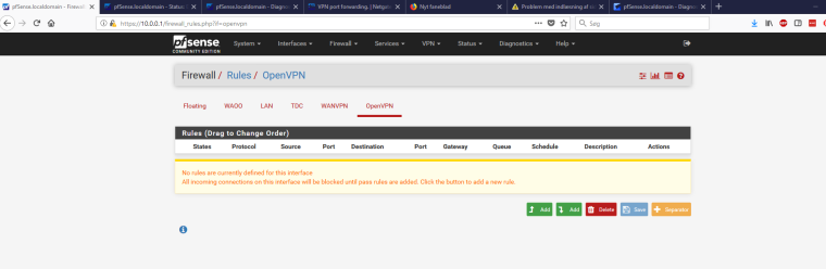

                  there is no rules in the openvpn tab on both sites
                  Lan at the siteB (client) is 10.0.0.0/24 i want to open port 8006 on 10.0.0.2
                  Lan at siteA (server) is 10.8.10.0/24
                  both sites got an ip in the interface tap after i restarted openvpn.

                    Then you probably need to check on the server why it is not responding. Looks like everything is in place that needs to be (assuming there really are no rules on the OpenVPN tab at Site B).
                    Attempt a connection then do Diagnostics > States on the Site B side and filter on 8006. What do you see?
                    Packet capture on Site B LAN filtering on address 10.0.0.2 and port 8006 and attempt a connection. What do you see?
                    What do the server logs on 10.0.0.2 say?
                    The LAN network at Site A is not a party to this traffic.
