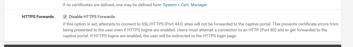

                  I also set :
                  The result of checking "HTTPS Forwards" is that the next line in the ipfw firewall rule list will NOT be present any more :
                  02117 fwd 127.0.0.1,8003 tcp from any to any dst-port 443 in
                  Only this one will stay - and does all the work :
                  02118 fwd 127.0.0.1,8002 tcp from any to any dst-port 80 in
                  Translation : all connections with destination "port 80" will get redirected to localhost, port 8002.
                  Port 8002 - in my case - is the http captive portal server, an instance serving http requests.
                  Now check out this part in /usr/local/captiveportal/index.php :
                  /* the client thinks it's connected to the desired web server, but instead
                  	   it's connected to us. Issue a redirect... */
                  	$protocol = (isset($cpcfg['httpslogin'])) ? 'https://' : 'http://';
                  	header("Location: {$protocol}{$ourhostname}/index.php?zone={$cpzone}&redirurl=" . urlencode("http://{$orig_host}/{$orig_request}"));
                  	ob_flush();
                  	return;
                  This enforces that all connections to our captive portal web server, nginx, (at port 8002, or http server) will get redirected to our secure https web server instance, running on http+1 or port 8003, so that authentication against our captive portal will be secured over https.
                  Of course, the access to captive portal login page will only be triggered when our client issues a classic http access over port 80. The http://www.what-ever.here.tld or http://www.google.com.
                  This part :
                  only enforces that the captive portal authentication is done over https - nothing else.
                  It does not enable a way so that an initial https://www.google.com request triggers the captive portal login page.
                  The last "HTTPS Forward" check enforces that our captive portal doesn't activate some MITM situation.
                  Still, I suspect the pfSense captive portal work better if using https authentication. I admit, no science neither explication in this phrase ;)
