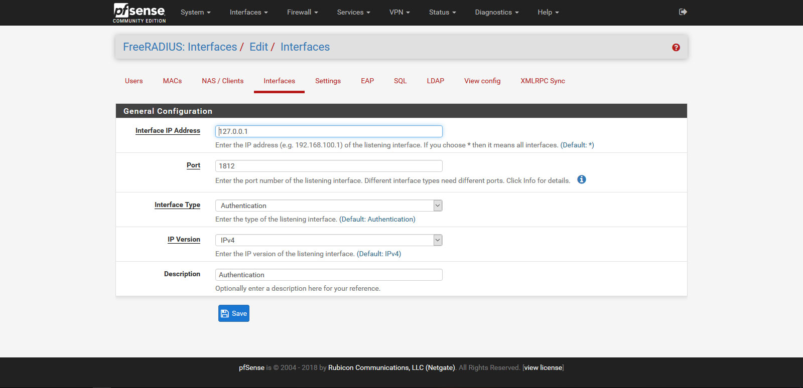

          Thank you for your reply. I have installed freeradius3.

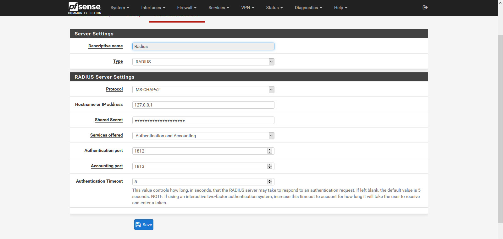

          1. System / User Manager / Authentication Servers
          Added Radius Server
          2. FreeRADIUS: Interfaces / Edit / Interfaces

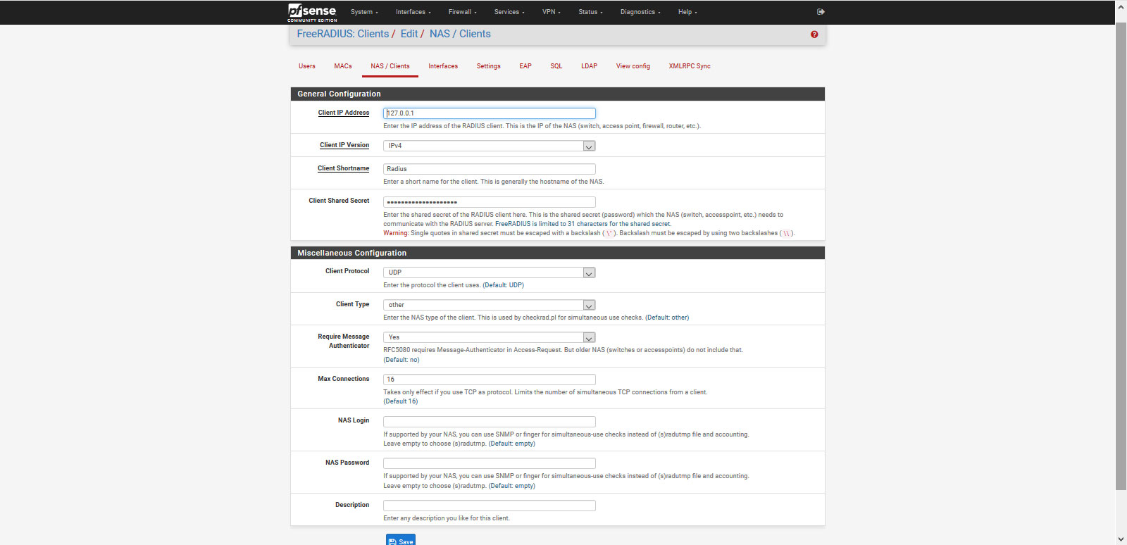

          3. FreeRADIUS: Clients / Edit / NAS / Clients
          Client IP Address: 127.0.0.1
          Client Shortname: pfsense

                              I have 2 admins in our pfsense and other users for vpn.I selected Radius in Authentication Server in User Manager. But I still login with the username created in local database, plus I can't login with the username created in Radius. I checked credentials in Diagnostics, it says The following input errors were detected: Authentication failed.
                              Elvin
                              • jimpJ Offline
                                If RADIUS login fails it falls back to local users, so your local admin user in pfSense will still work. That is a safety measure so that you don't get locked out by a broken RADIUS server.
                                You need to concentrate on fixing the RADIUS settings if the authentication is failing, something there still isn't quite right.
