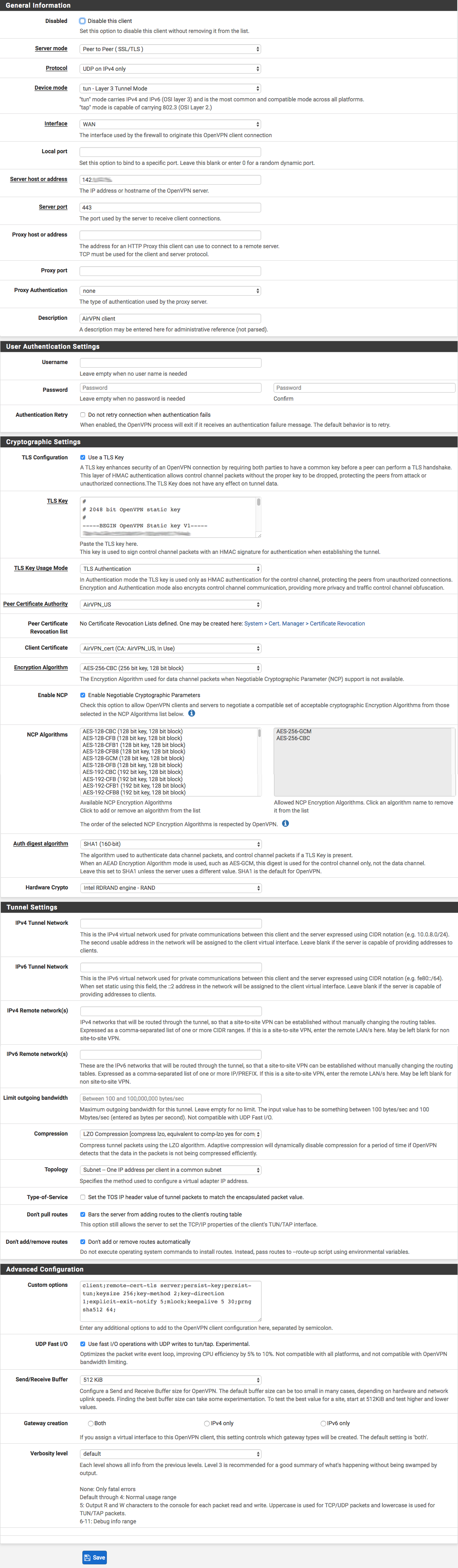

      Here is the VPN/OpenVPN/Client settings page

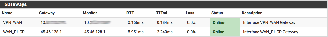

          So the since i'm "learning" here... I disabled the gateway and then checked the OpenVPN client status again and it was still up. So that got me thinking... this issue must just be with the "Gateway" and its settings.
          So per the guide when setting up the VPN gateway is says to input "Monitor IP = 10.4.0.1" and states this "The 10.4.0.1 is the AirVPN DNS server for port 443 UDP access. For reference, the other DNS servers are listed here at the bottom of the page."
          So after reading the explanation under this input box "Enter an alternative address here to be used to monitor the link. This is used for the quality RRD graphs as well as the load balancer entries. Use this if the gateway does not respond to ICMP echo requests (pings).", I removed this IP address and now the gate way shows as "Online"
          So I assume that changing the gateway monitor IP to default the Gateway IP instead of an internal DNS address has no ill effect on VPN traffic leaking.

            Right. You cannot always ping an OpenVPN tunnel address. If you want gateway monitoring, you need to set something you can ping as the monitor IP address.

                With 0.1ms RTT I don't think you are Monitoring the other Tunnel Side (VPN Provider).

                  @rico said in Connecting to AirVPN with OpenVPN and Gateway issue:
                  -Rico
                  I thought this was strange also, considering my local ISP gateway was 8.9ms and 2.2ms
