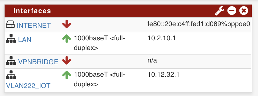

                            I believe I’ve got the same issue.
                            I’m running pfSense on a multi-nic Intel atom box. It’s got Realtek interfaces (“re” drivers). I’ve also got another box running an i3 CPU with intel interfaces (“igb” drovers).
                            My WAN connection’s are PPPoE. The PPPoE interface is set up on a VLAN on the NIC.
                            The other day, I noticed my LAN interface didn’t have an IPv6 address (I’ve got IPv6-pd through my isp with track interface). So I just went to interfaces > LAN, and clicked “Save” then “Apply” without changing any settings. When I did that the whole router stopped passing traffic. I couldn’t access it from the WAN end, nor could I from the LAN end. I gracefully powered it down by pressing the power button which would’ve caused an ACPI shutdown, then powered it back up. When it came back up I checked the logs.
                            This message repeats many times
                            Nov 18 13:46:15	ppp		[wan_link0] Link: reconnection attempt 14916 in 2 seconds
                            Nov 18 13:46:15	ppp		[wan_link0] LCP: Down event
                            Nov 18 13:46:15	ppp		[wan_link0] Link: DOWN event
                            Nov 18 13:46:15	ppp		[wan_link0] can't remove hook mpd8627-0 from node "[12]:": No such file or directory
                            Nov 18 13:46:15	ppp		[wan_link0] PPPoE: can't connect "[12]:"->"mpd8627-0" and "[10]:"->"left": No such file or directory
                            Nov 18 13:46:15	ppp		[wan_link0] Link: reconnection attempt 14915
                            Nov 18 13:46:13	ppp		[wan_link0] Link: reconnection attempt 14915 in 2 seconds
                            Nov 18 13:46:13	ppp		[wan_link0] LCP: Down event
                            Nov 18 13:46:13	ppp		[wan_link0] Link: DOWN event
                            Nov 18 13:46:13	ppp		[wan_link0] can't remove hook mpd8627-0 from node "[12]:": No such file or directory
                            Nov 18 13:46:13	ppp		[wan_link0] PPPoE: can't connect "[12]:"->"mpd8627-0" and "[10]:"->"left": No such file or directory
                            Nov 18 13:46:13	ppp		[wan_link0] Link: reconnection attempt 14914
                            Nov 18 13:46:10	ppp		[wan_link0] Link: reconnection attempt 14914 in 3 seconds
                            Nov 18 13:46:10	ppp		[wan_link0] LCP: Down event
                            Nov 18 13:46:10	ppp		[wan_link0] Link: DOWN event
                            Nov 18 13:46:10	ppp		[wan_link0] can't remove hook mpd8627-0 from node "[12]:": No such file or directory
                            Nov 18 13:46:10	ppp		[wan_link0] PPPoE: can't connect "[12]:"->"mpd8627-0" and "[10]:"->"left": No such file or directory
                            Nov 18 13:46:10	ppp		[wan_link0] Link: reconnection attempt 14913
                            Nov 18 13:46:09	ppp		[wan_link0] Link: reconnection attempt 14913 in 1 seconds
                            Nov 18 13:46:09	ppp		[wan_link0] LCP: Down event
                            Nov 18 13:46:09	ppp		[wan_link0] Link: DOWN event
                            Is this a bug?
                            • N Offline
                              netblues @breakaway
                              @breakaway Sure is, however netgate doesn't want to accept it, Since they cannot replicate it on a lab. Any luck on replicating this?
                              • B Offline
                                breakaway
                                I have replicated it twice. Once on a device with Realtek nics (re0, re1 etc) and once on an Intel NIC device (igb0,igb1 etc).
                                All you have to do is go to a LAN interface, click "Save" an "Apply". Internet goes away almost immediately. See screenshots below.
                                I think it is a requirement to have PPPoE interface ON TOP of a VLAN interface to make this happen. This issue does not exist if your WAN is Static IP.
                                If I go Status > Interfaces and hit "connect" - that seems to bring it back. But this could be a real issue if I made a change on my LAN interface while I wasn't at home.
