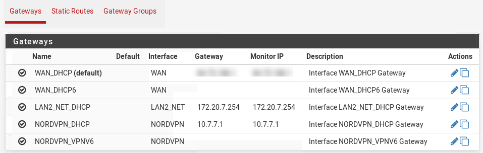

      Please see the diagram:
      On router B I am running an OpenVPN client, which is working.
      The idea is that all traffic from the 192.168.32.0/24 network is routed through the VPN, EXCEPT

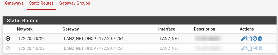

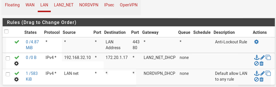

      for one host residing on a network from router A. So router B has a static route to the 172.20.0.0/16 network. and on the LAN interface (192 net), there is a rule (policy based routing) sending all traffic over the static route.
      The client can now only communicate over the VPN and can no longer reach the host in the 172.20.0.0/16 network.
      When I ping from the client, I get a response from the VPN gateway, and not for the LAN gateway.
      Please see the relevant config:
      3_1538470356611_1.png 2_1538470356610_2.png 1_1538470356610_3.png 0_1538470356610_4.png
      • V Offline
        viragomann
        Consider that there is also a static route for 192.168.32.0/24 needed on router A.
        However, the interface on B facing to router A a is a DHCP configured. It should have a static IP.
