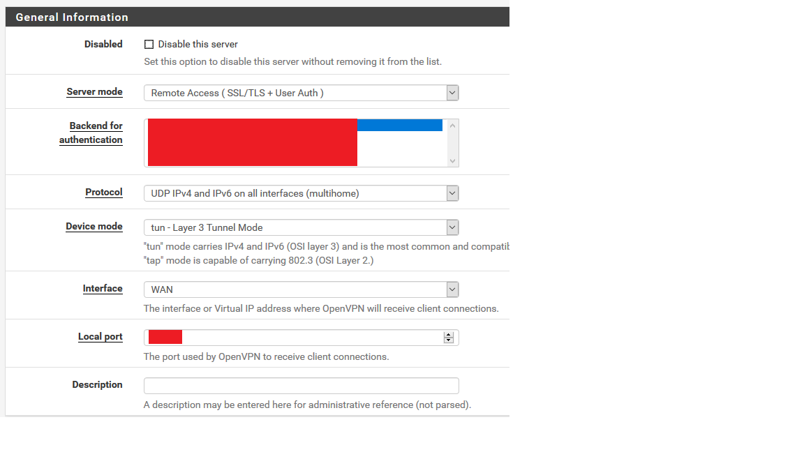

    Hello reader
    I'm currently struggling to get OpenVPN setup on IPv6 as my ISP only provides me a /56 range using DHCPv6 via a link-local gateway, meaning I have no static WAN IP... It independently requests a random dynamic IP/128 within the DHCP request.
    My question is, would it be possible to bind OpenVPN on both my IPv4 WAN IP (For legacy connections) aswell as a IPv6 IP to provide the services I need?
    How would I do that considering I don't want to use Dyndns of any sort to provide my WAN IP which changes.
    I've tried multihome IPv4 and IPv6 allowing traffic to go to my LAN's v6 address but that has not worked at all.

      Is your LAN IPv6 allocation static? If not you'd still need dynamic DNS. And why not use dynamic DNS? That's what it is meant for.
      The "multihome" options are as close as you'll get to what you want, but you still need to be able to tell the clients how to reach you, which means you'll either need to use a hostname or hardcode the IP addresses into the exported configuration. The client export package can't easily guess what you want with the multihome option.
      Alternately, create a copy of the VPN with most of the same settings -- the tunnel network would need to be different -- and bind each one where you want (one on IPv4 WAN, one on IPv6 LAN for example) and then export them separately, or add multiple remote statements to the client configs manually.

        @jimp said in OpenVPN on IPv6 using difficult setup:
        I'm using DHCPv6 to receive the range and it's assigned statically to my clients with SLAAC disabled so the gateway is a static prefix::1 indeed. My routes where configured and I saw states going through to the IP from WAN.
        I indeed changed the remote IP in the 'Client Export' file to my LAN IP.

            After recreating the entire tunnel I've managed to get OpenVPN traffic on IPv6 to my (static xxxx::1) LAN bind for the tunnel. But I've hit another wall regarding TLS errors aswell as a 'UDPv6: Can't assign requested address (code=49)' error.

                            Failing the above, you need some other consistent address to use. That means the pfSense LAN interface. It's entirely possible to do that, as pfSense will receive the incoming packet, addressed to the LAN interface and receive it. As far as the ISP and the rest of the 'net is concerned, it's just basic routing to get the OpenVPN packets to where they have to go.
                            UniFi AC-Lite access point
                            W 1 Reply Last reply Oct 4, 2018, 3:25 PM Reply Quote 0
                            • W
                              Wraptor @JKnott
                              I did, I also later on stated I've tried my LAN v6 but it never worked. Afterwards I got it to work recreating it using identical configuration.
                              Thank you both @jimp and @JKnott for the help. My issue has been resolved by itself.
